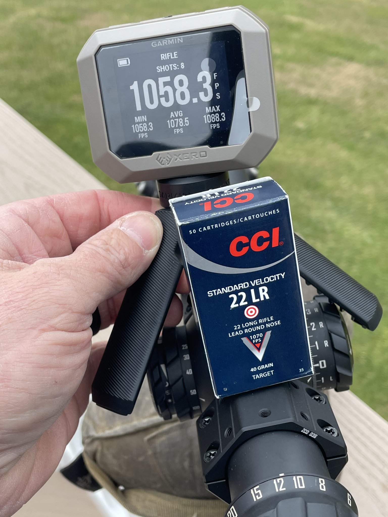

    Was just trying to get zeros and 100 yard drop today. Groups would be half the size with a competent shooter.
    77/22 really liked tenex at 50
    Vudoo liked long range a lot more than center x at 100. Of course I have a lot more center x than LR

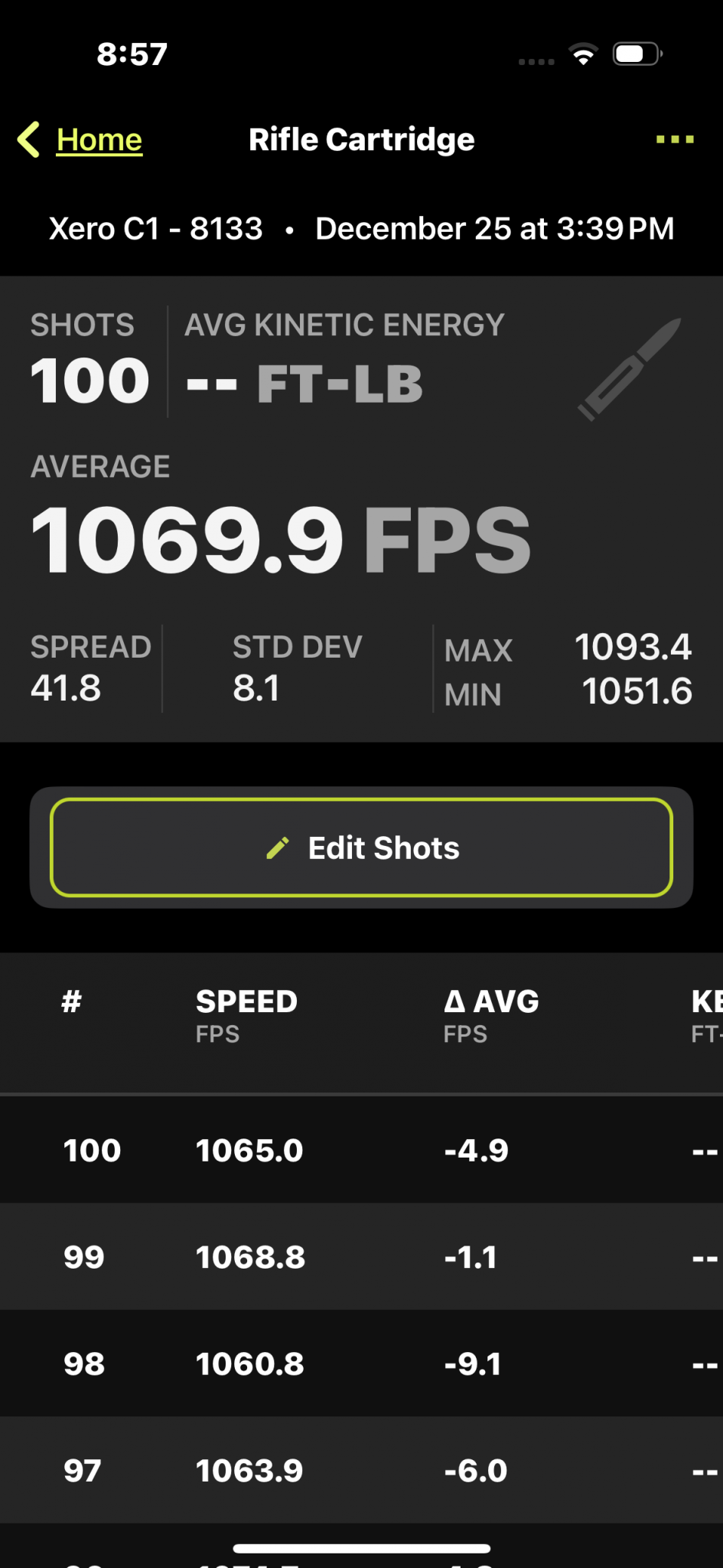

    Cci better than expected. This is first time I chrono 22

    View attachment 8304957View attachment 8304956
    77/22 really liked tenex at 50View attachment 8304959
    Vudoo liked long range a lot more than center x at 100. Of course I have a lot more tenex than LR

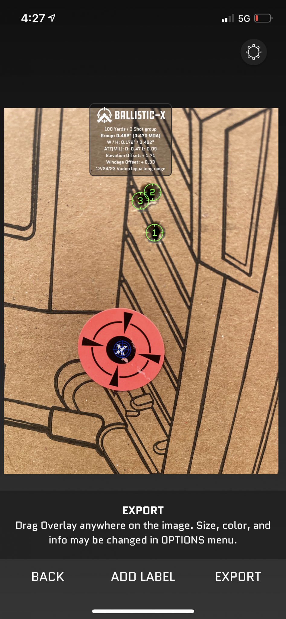

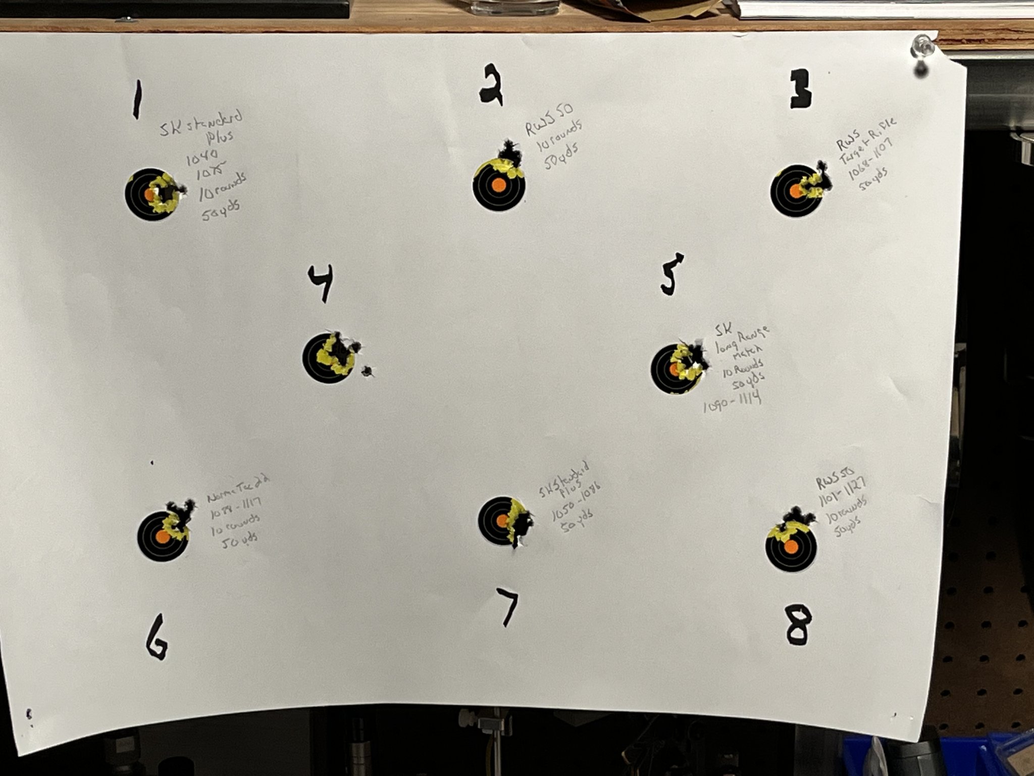

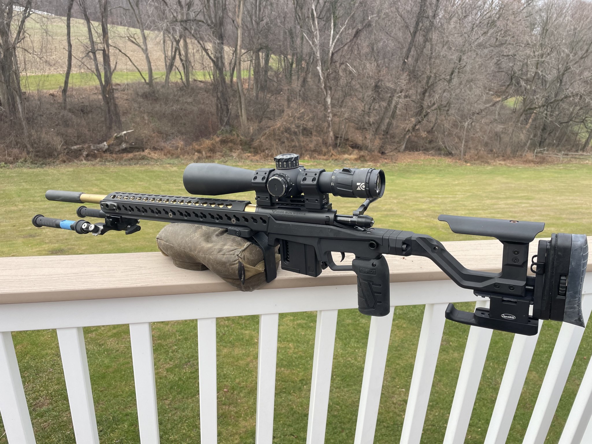

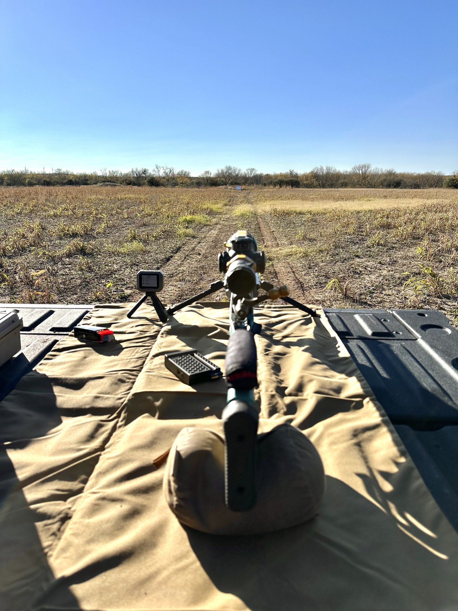

    Pic #1 New Vudoo shot Friday afternoon in just about perfect conditions...beautiful afternoon we do not get often in Northern Nevada...

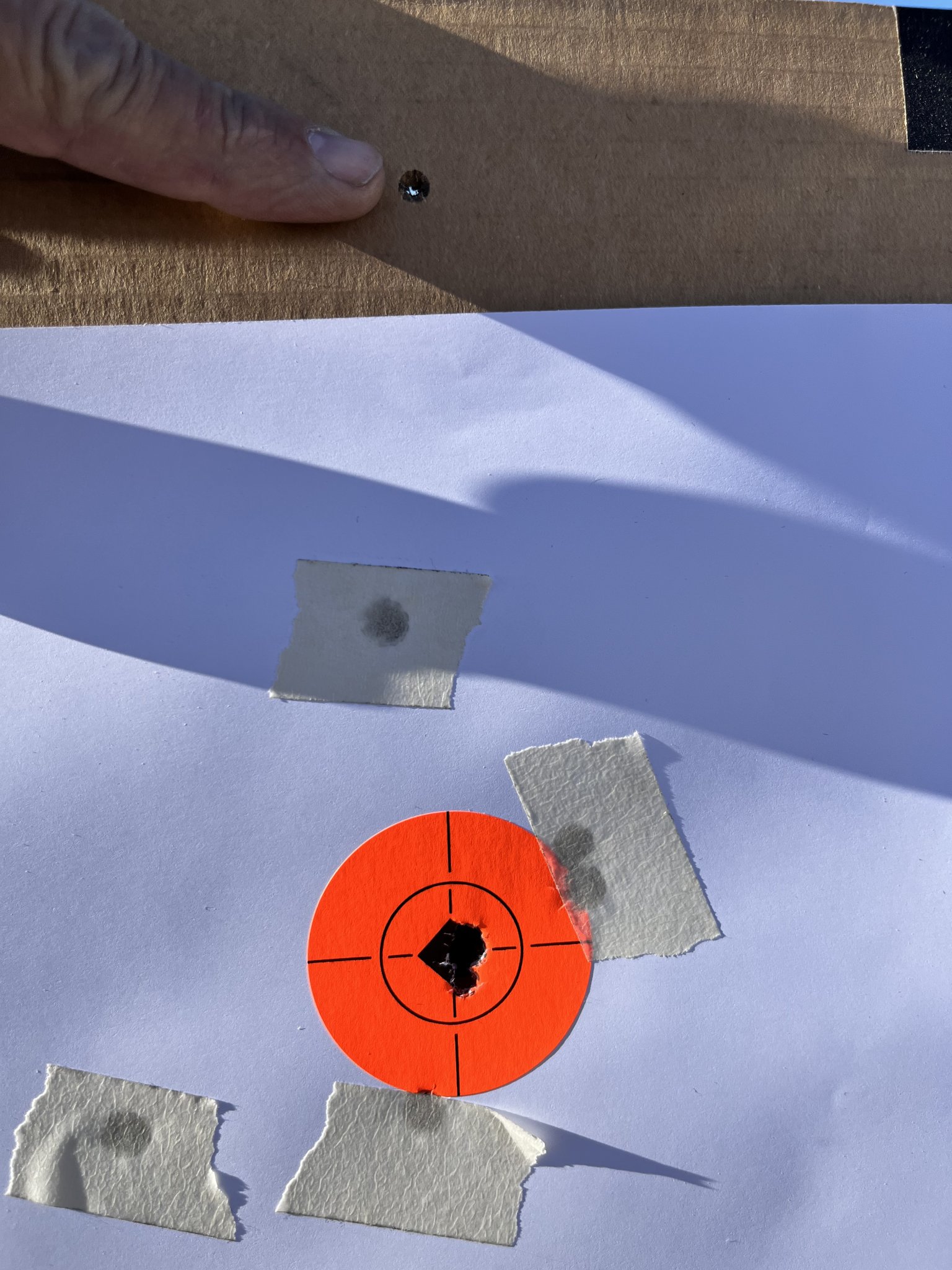

    Pic #2 round first round out of new gun where my finger is...5.5mils down and 9 rounds of SK standard plus at 25yds

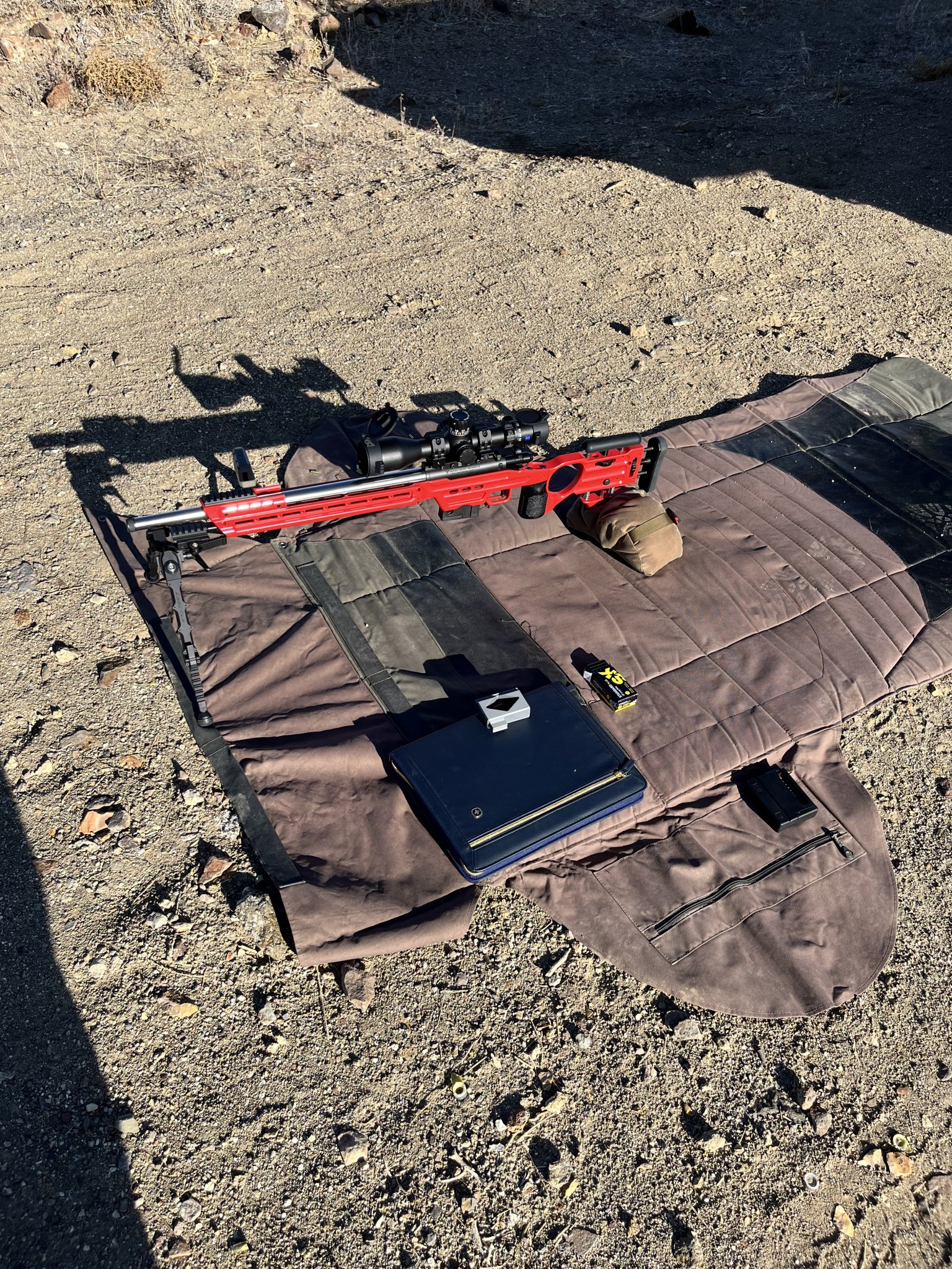

    Pic #3 ammo test...#4 was eley subsonic and 3 outta 10 did not extract and did not shoot that great anyway that's why I did not write any info....note #2 and #8 both RWS 50 #8 was not ammo that is shooter fatigue... at 50yds

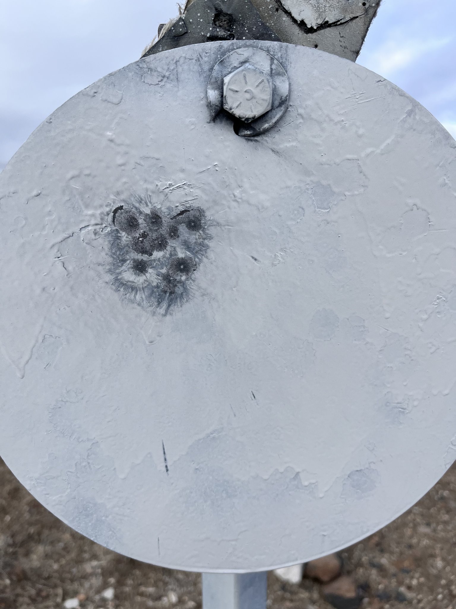

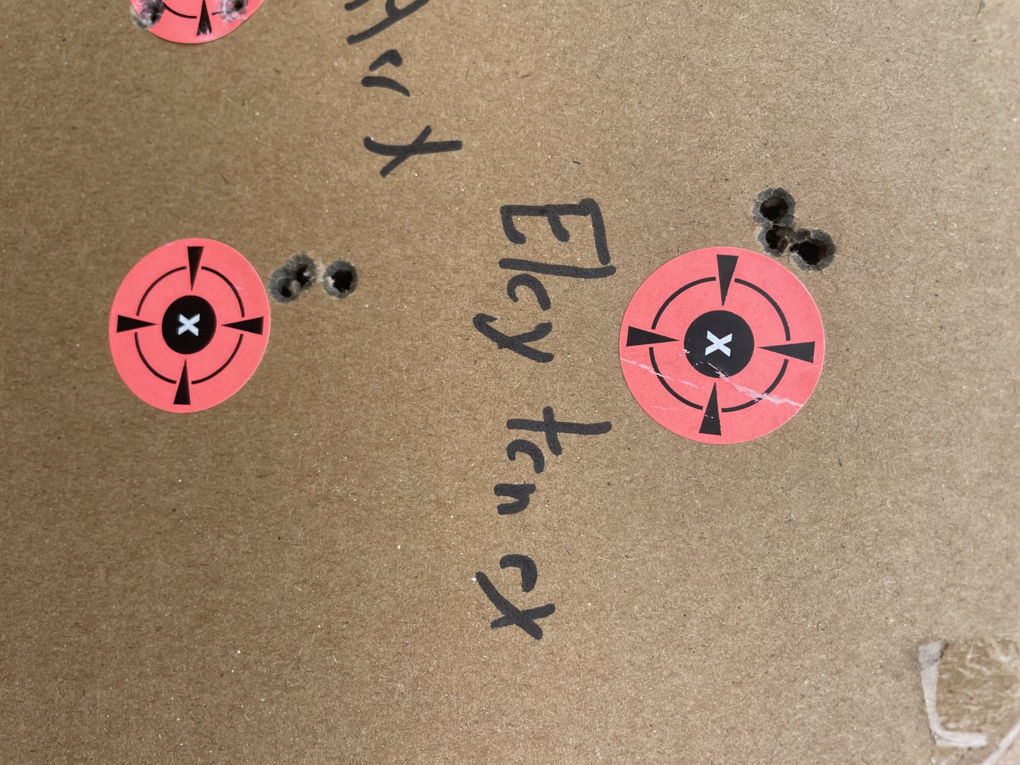

    Pic #4 was next day.... Saturday not so great conditions Cold, over cast and light varying wind from 130-2 O'clock
    SK Long Range Match...Bolt is 3/4" for reference...100yds...actually 101.6yds

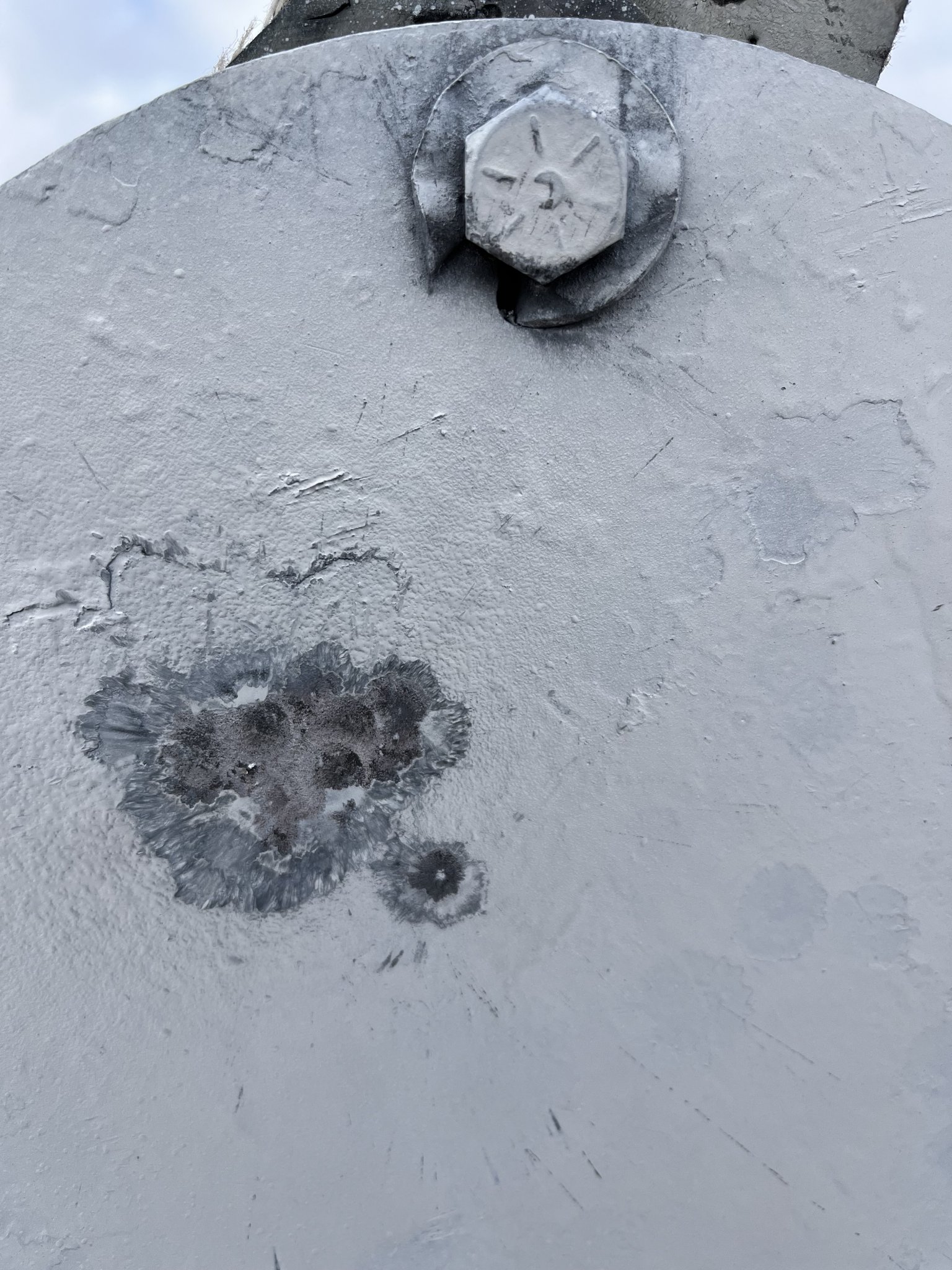

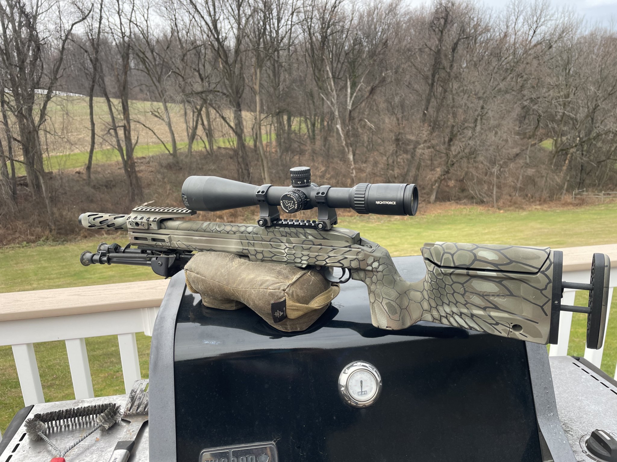

    Pic #5 Saturday same conditions...RWS 50 101.6yds the one outta the group was definitely me getting use to the new gun
    Also Friday was shot with a Zeiss S3 4-25 which I was having a problem seeing the center dot Saturday was shot with a Mark5 5-25...both days after each 10 shot group I'd walk down and check the group...my way of taking a break.

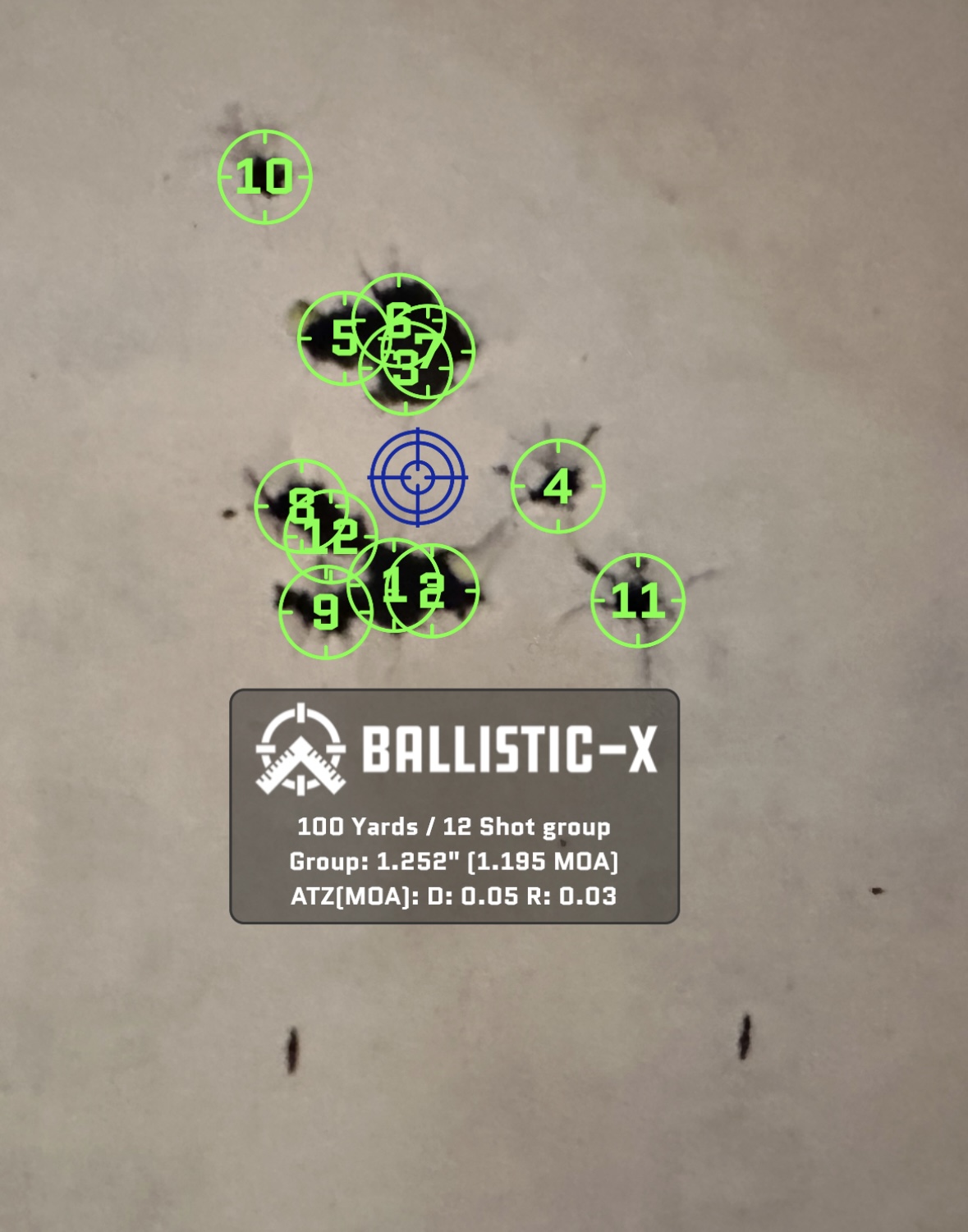

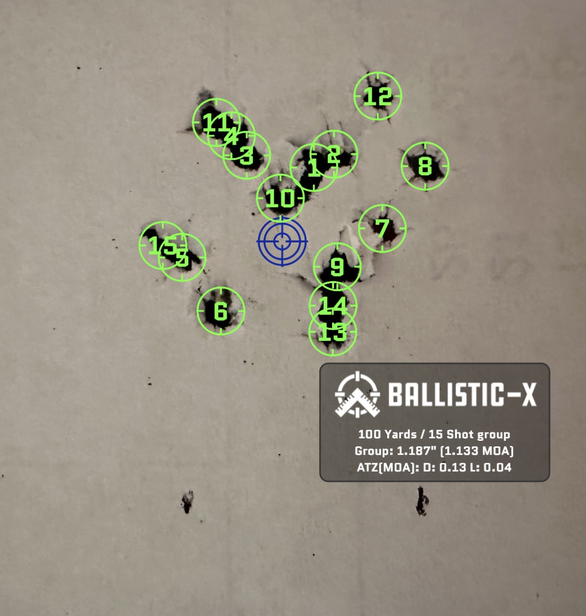

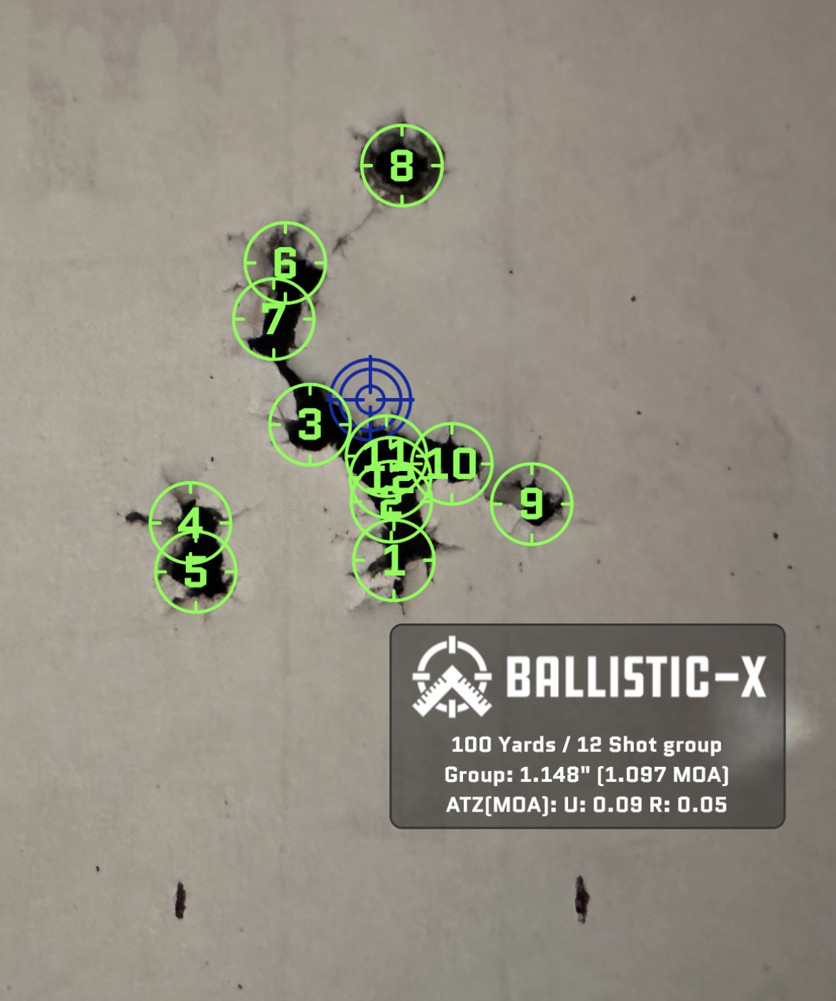

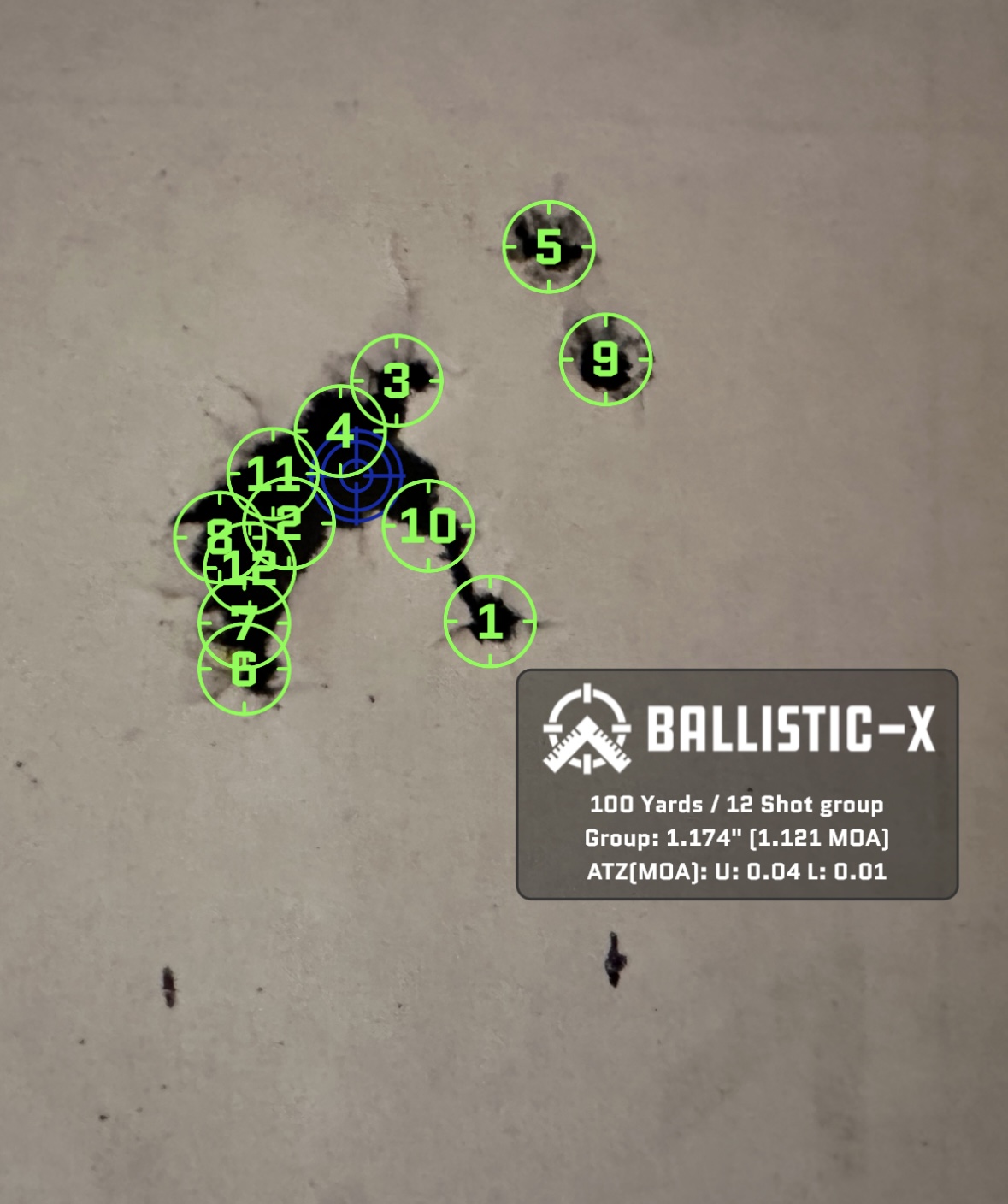

    These 12 shot groups were shot yesterday with my Vudoo at 100yds. I had one flag down range and setup to where I could see it in my scope while shooting. Winds were 12-13mph from my right to left. My average was around 1.190 MOA and I was happy with that. Just wanted to see what I could do in the wind. Ammo was R50.

    thanks. that is,to me,meaningful wind. i don't feel too incompetent when i see this and other postings of +/- 2 moa groups from high end guns and ammo. gonna try some 50r groups this week. i have seen how going from 50 to100 makes a really big difference. sorta like my going from 300 to 600 with 223.
