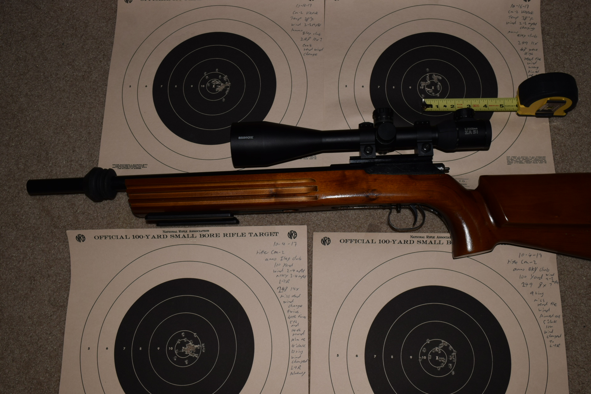

Btrain: I use my Russian made Vostok 22lr rifle often shooting out to 110 yards, right now it has a Mueller 8-32x44 target scope on top. From 100 F heat to 20 F cold, i had used this scope, the glass is very clear out to 110 yards, I have no problem to see 22lr holes on paper. Shooting from front bi pod or rest, rear shoulder, mid priced ammo. it is a lots fun.
