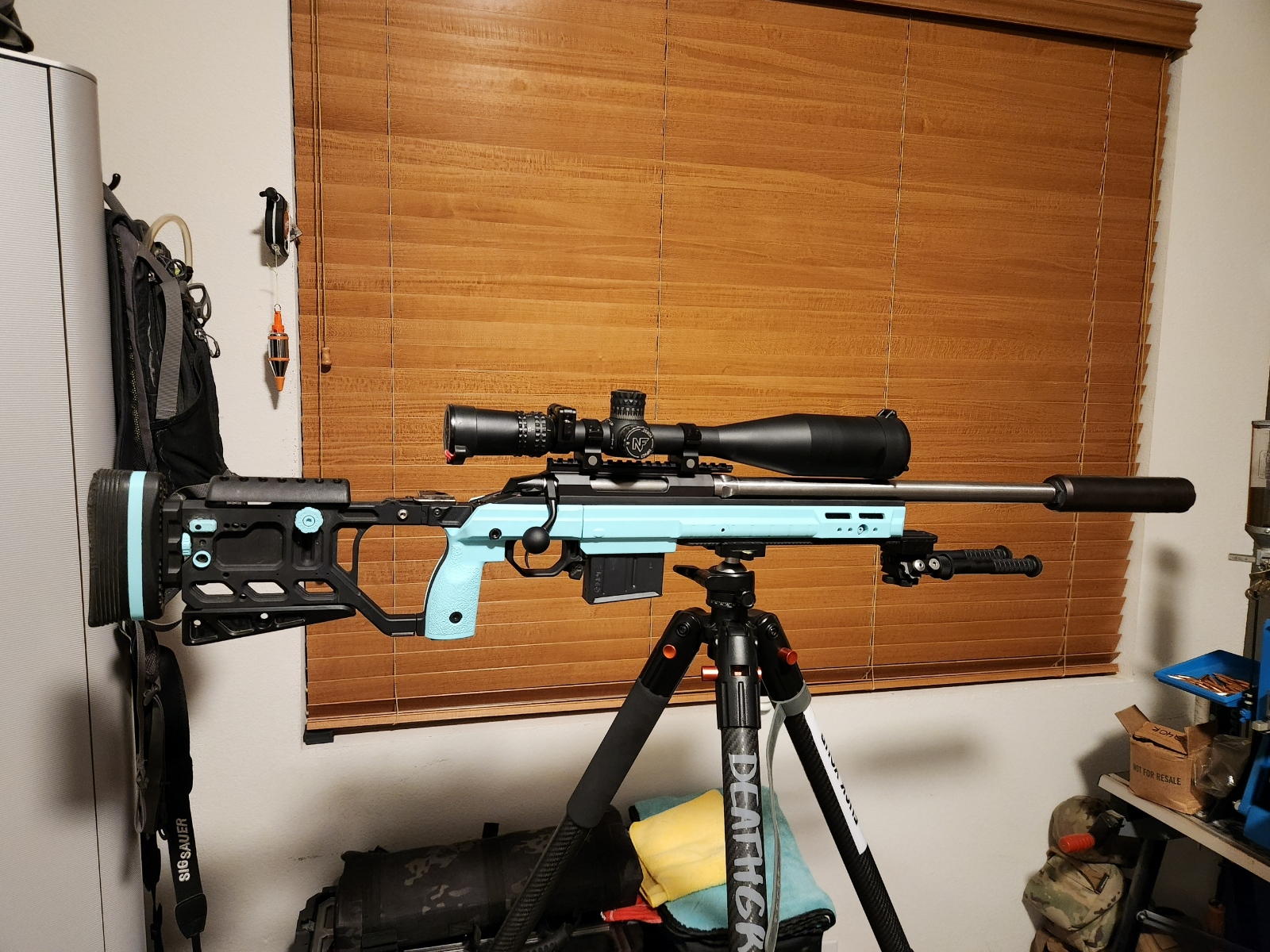

Finished my 22 arc tikka rifle today cant wait to test it out this weekend... picked the chassis off someone on here. Nightforce on top and ready to rip some 88gr arcs...

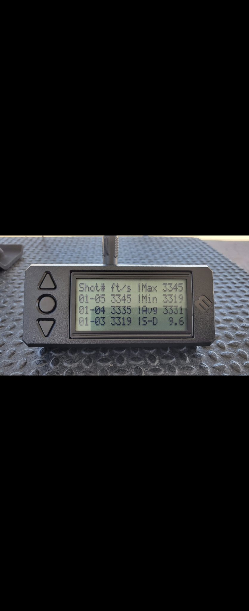

Its one of the funnest calibers i have... insane speed 3300-3400 with a 75gr and the recoil of a 223 bolt gun

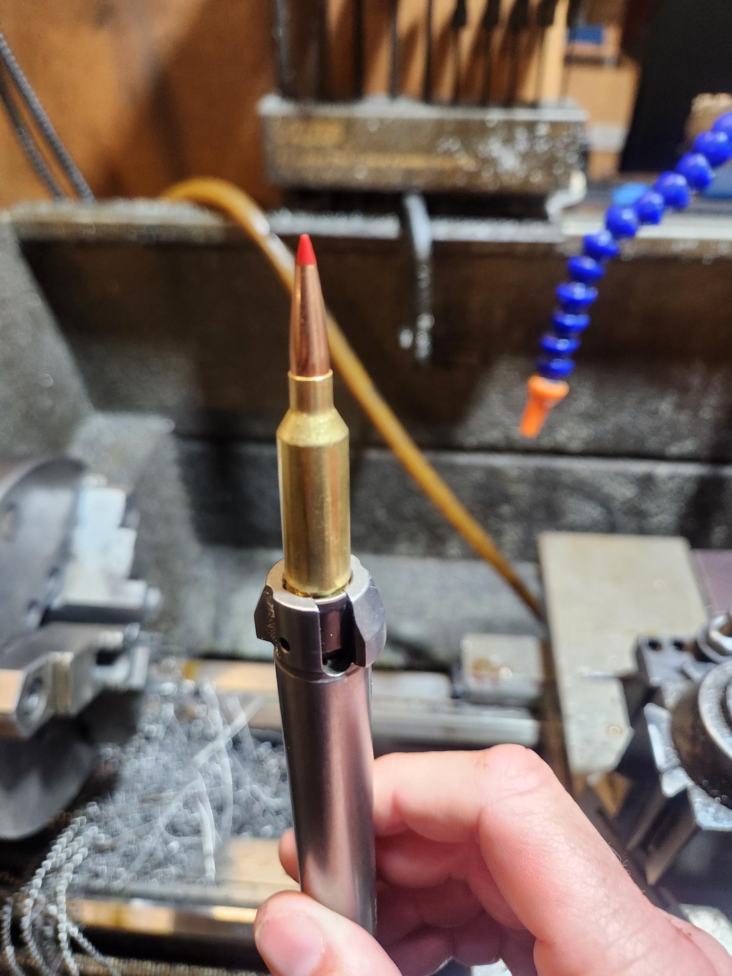

So i converted 6.5 grendel brass to "22arc" and its starline and seems to be working great... whats crazy is its only a 16 inch barrel.. 6.5 grendel and 22arc brass are almost exactly the same...

Im so happy i used a tikka for this platform, its such a good rifle

Something is not adding up here. First you were getting 3300-3400 with 75s out of a 16" barrel, but then later you were getting 3090 with 62s out of that 16"? The lighter bullet was significantly slower?
Was that 3300-3400 perhaps for the 24 inch barrel you mention later? That would make a lot more sense. Still quite impressive. I'm shooting the 75 ELDM about 3350 out of a 20" barrel, but that's a 22 Creedmoor burning 41gr of powder.
I was but the brass was the issue when we were smoking them out there and I went from 31ish to 28.5 the speeds I was at at first were not sustainable.. the brass was struggling and you would get erratic groupings.. so I decided to turn it back a bit. But those speeds are obtainable my gun just want having it
Grendel brass is designed for pretty low pressure. There isn't a bolt action brass specification so anything past an anemic AR15 load is technically over pressure. When you lean on the brass it doesn't last very long. When you really really lean on it, like you posted, you'll be lucky to get more than a couple of firing (if that) out of the brass. If you can buy cheap once fired 6.5G Hornady brass, and size it to 22G in a single pass, smoking the brass may not matter.
Reactions: joseph-98
For sure.. I was using starline 6.5 g brass and at the 3300 it was like 3 firings... now at 3050-3100 I'm on 6 haven't lost any yet

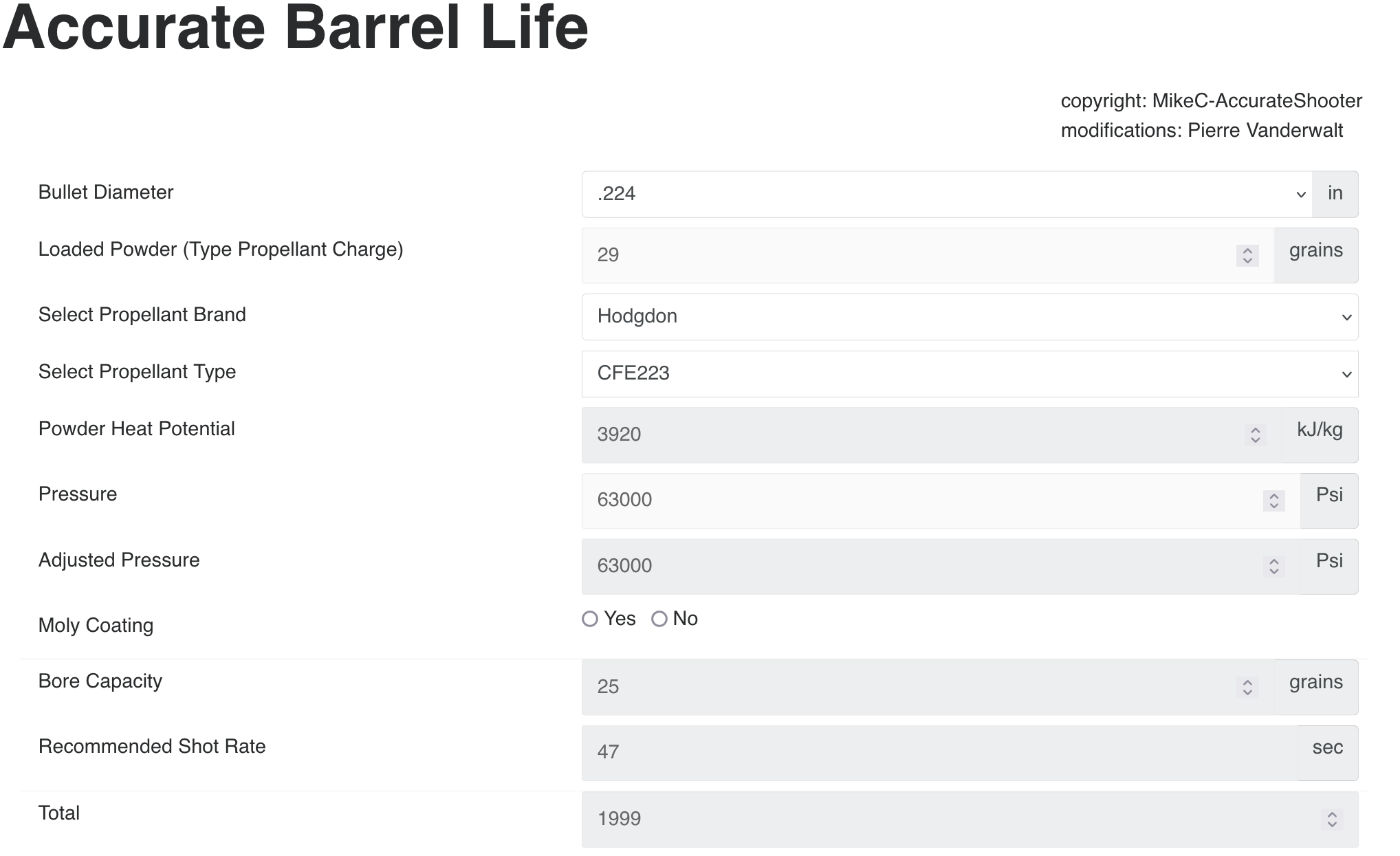

When you look at total cost of ownership, there's no free lunch.
Here's a model breakdown @ 63k psi = 1,999 shots.
Let me know if there's any errors on the inputs...:oops:
View attachment 8594137Is this available online or as part of a software package? Can you post a link to where I can find the software? TIA
