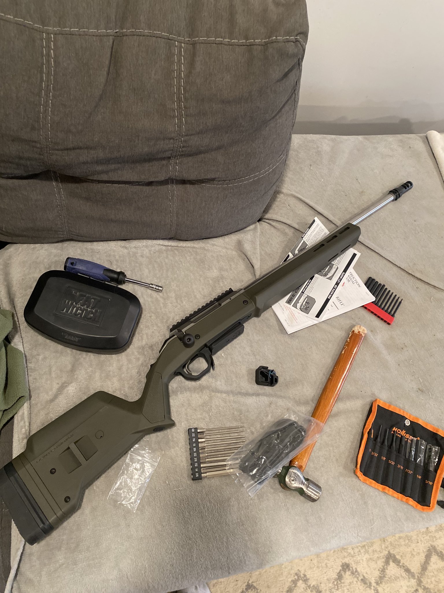

    How does it shoot?
    Dude I got that same stock last month for $140 from Amazon. It was sketchy at first but sure enough it was legit. Same color on a Ruger American too haha
