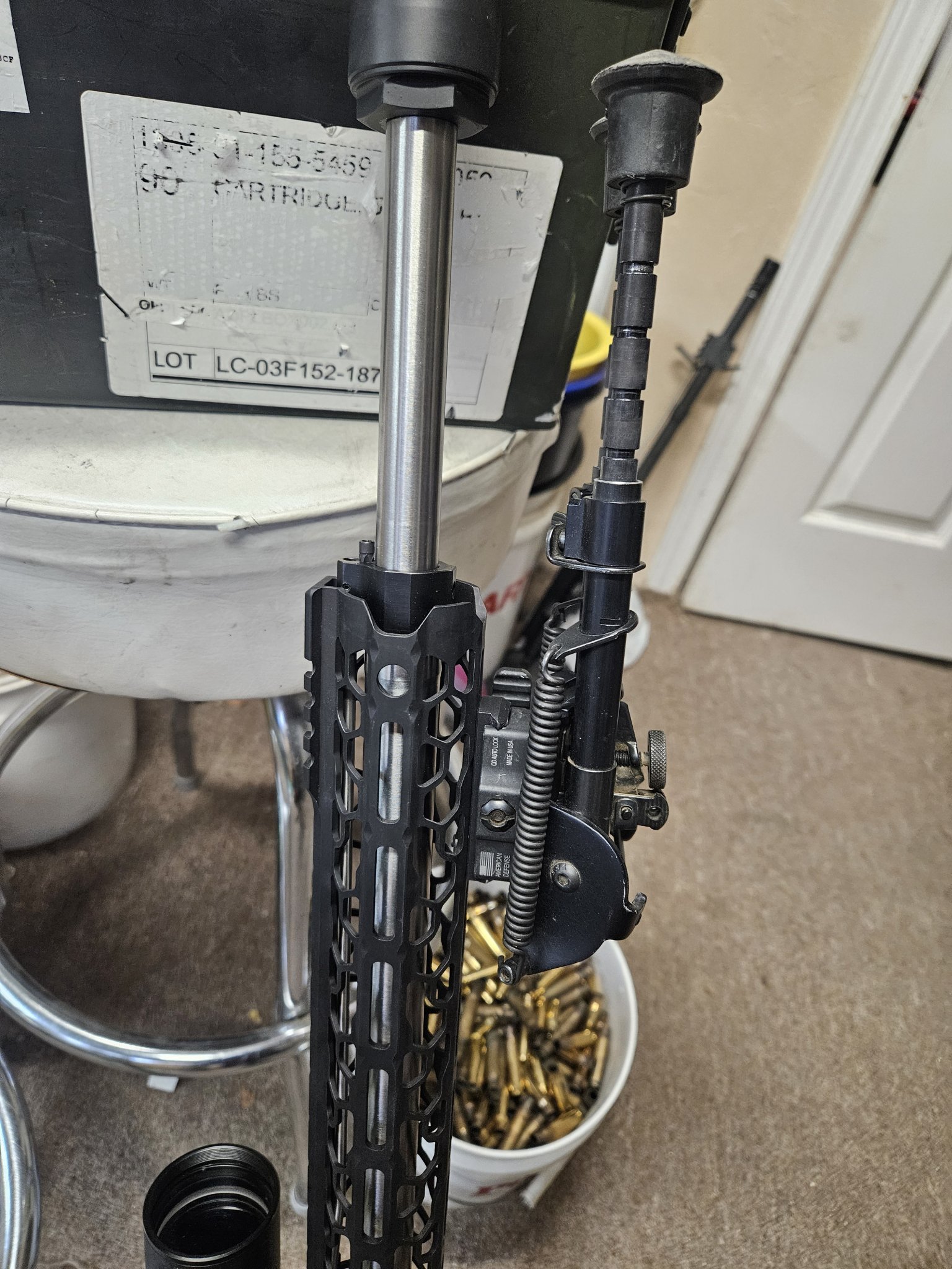

Odinworks 16" 02 lite handguard. I believe this barrel is a +1 gas system.
