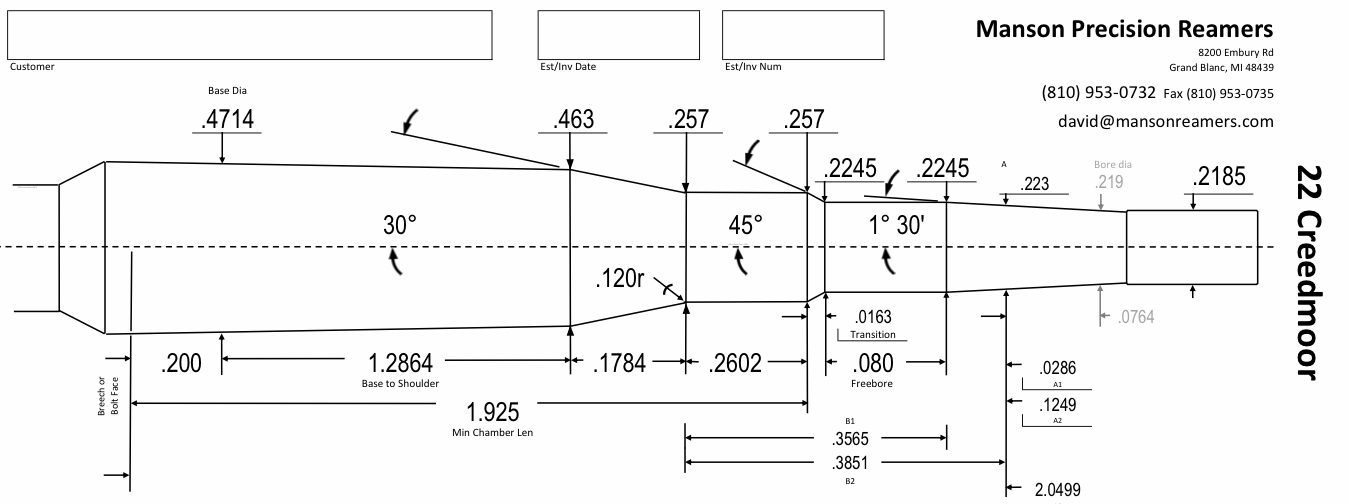

You can email them and as for a copy. Ive attached their standard print below. Its unlikely they botched the leade of the reamer that much to cause a 75 to be out of the case. Any chance of a measuring error?

You can take a rough measurement of the freebore with your caliper. Not a precise measurement. If the freebore on the reamer is long enough to not capture the bullet at all, that would mean the freebore feature on your reamer is longer than the neck feature is, which would make for an easy visual reference.
