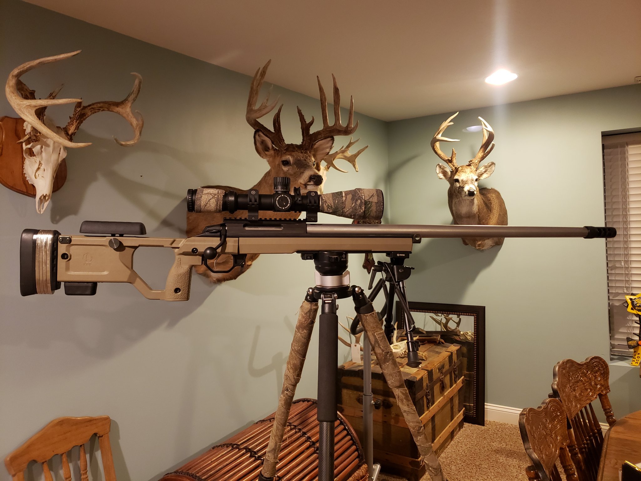

I am running the 75gr ELDM at 3025 out of a .223 Tikka Varmint 1-8" with Nammo brass, H4895, and CCI450's. My next barrel will be a 1-7" so I can play with the 80 ELDM. It will be a 223 AI too.
