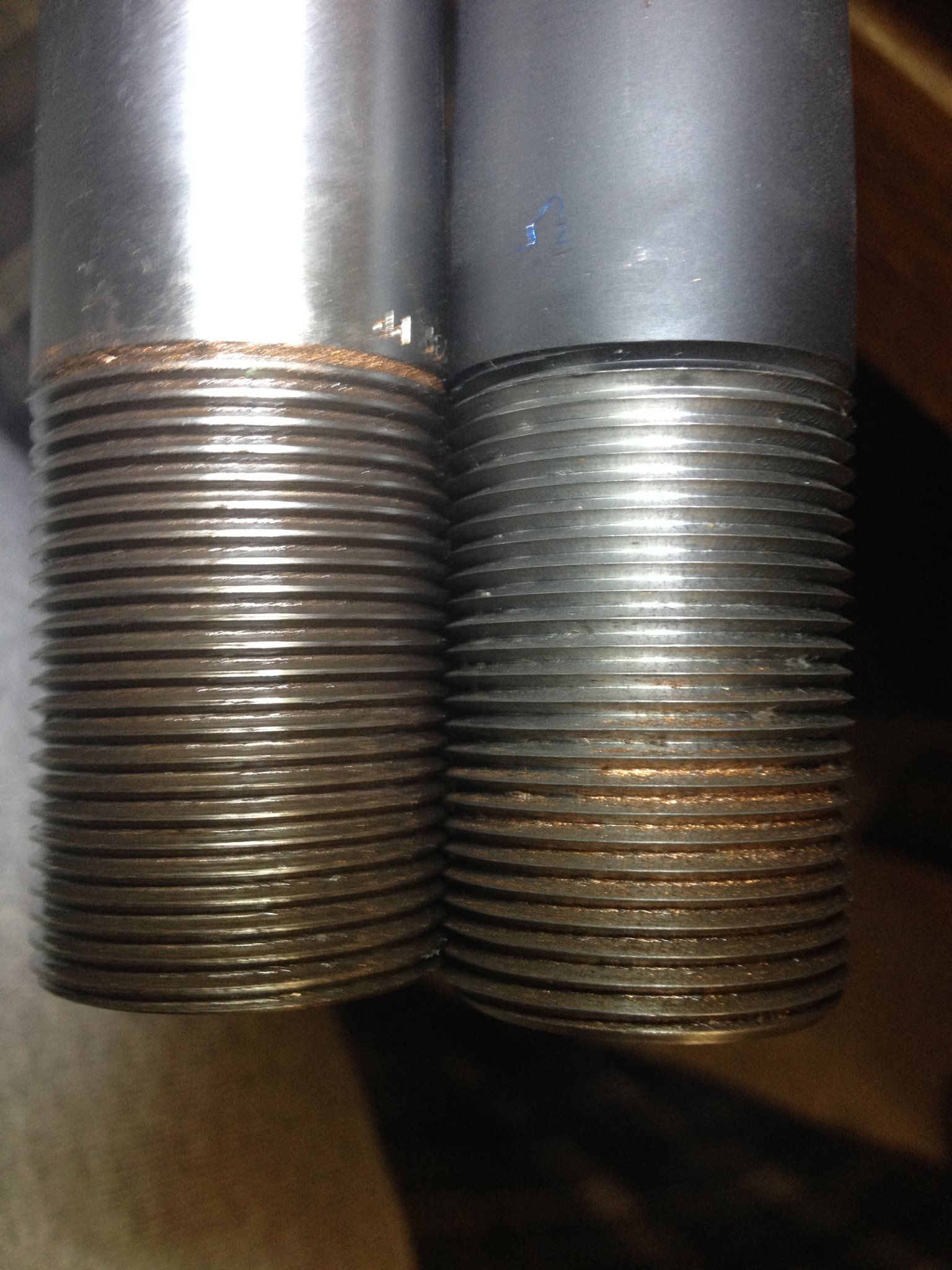

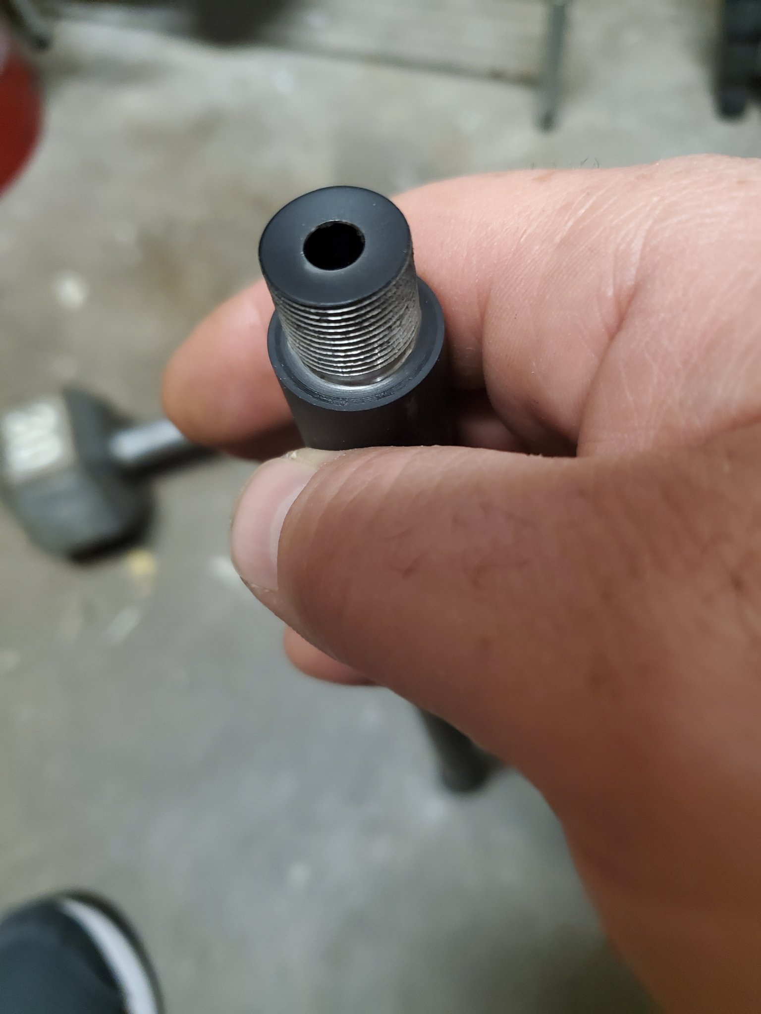

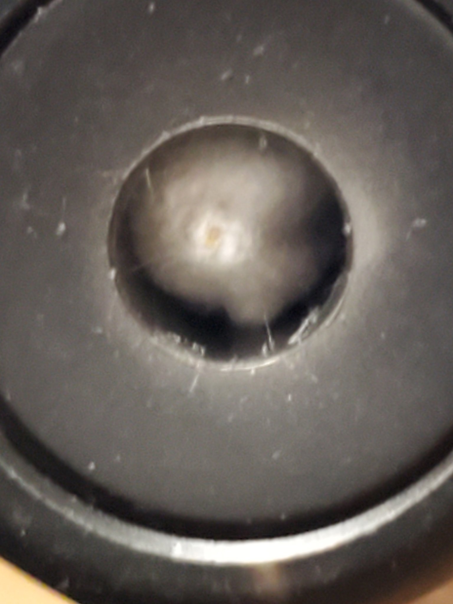

    Mcgowan does shit barrel work. Buy at your own risk. There blanks might be ok, but their other machine work and quality of products is pretty much garbage in my experience. Every single one of the 4 barrels I have received from them has had problems. Shit crowns, shit threads, undersized threads. I am at the point I have stopped contacting them about it, because each subsequent replacement is just as bad as the one before.
    Replacement for a barrel with undersized muzzle threads. The next pictures are the replacement for the barrel above, or barrel number 3. I don't have pictures of the AR barrel on my phone.

    I don't have wires to measure the tennon threads on the new barrel. But they are very loose compared to my other barrels going into the same action. Not as loose as the last one though.
