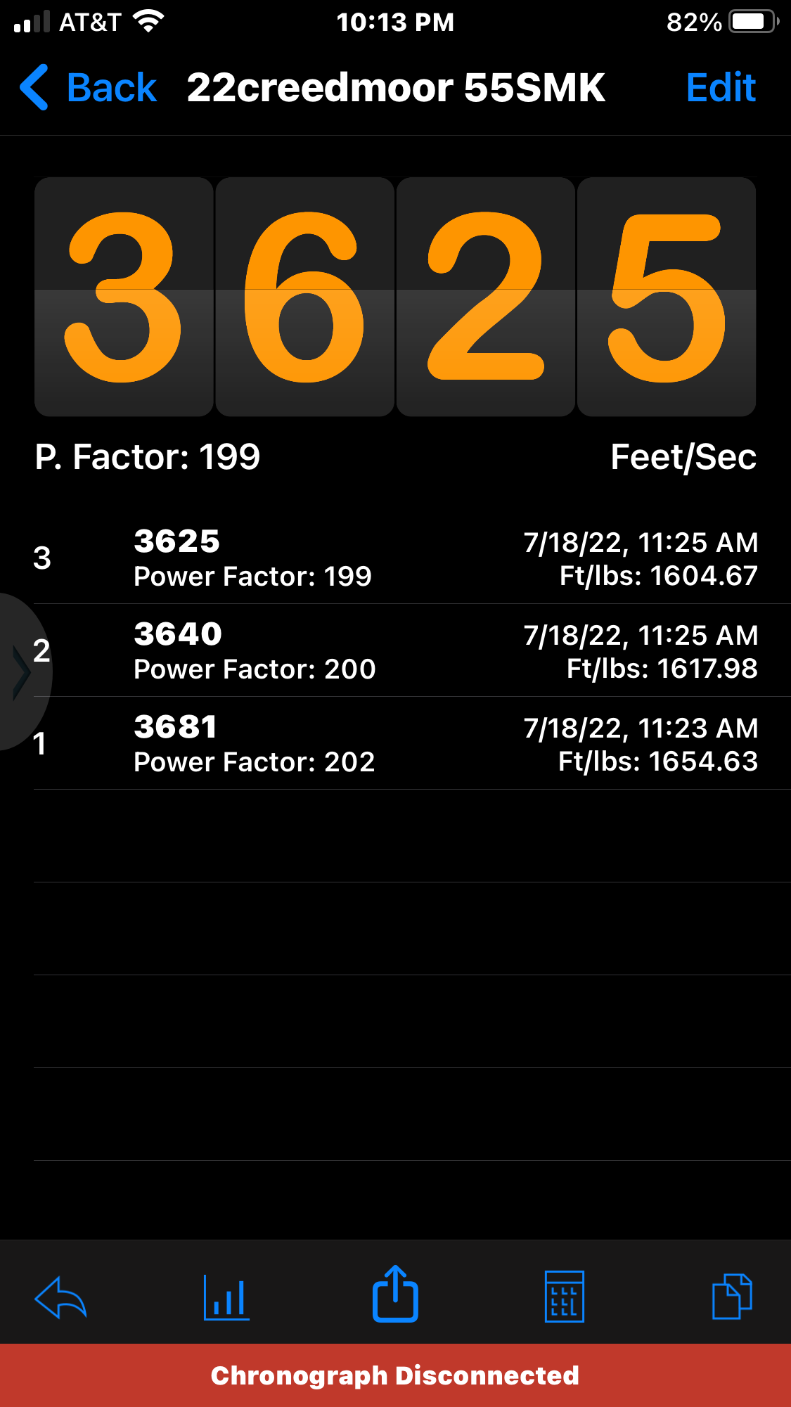

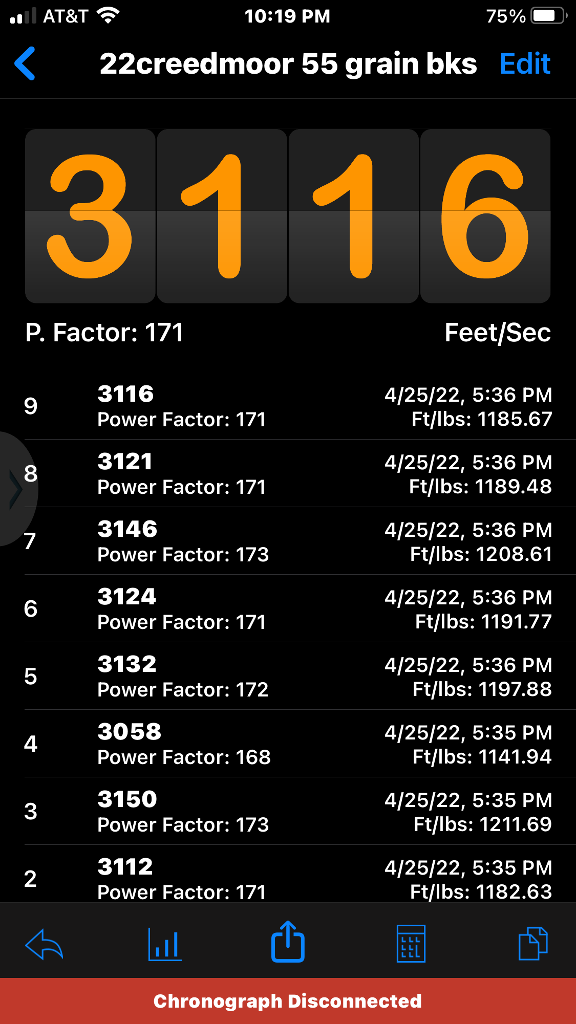

    With 41.5 grn 4150 and 55grain pill (tried many) = 3100fps
    I played around with this for a long time and didn’t know what to do...
    Should have posted on here...
    Varget was the ticket= 40grn 3600fps+
    This was 1st time I tried it.
    41 gr too hot and did not help much with speed only 100fps.

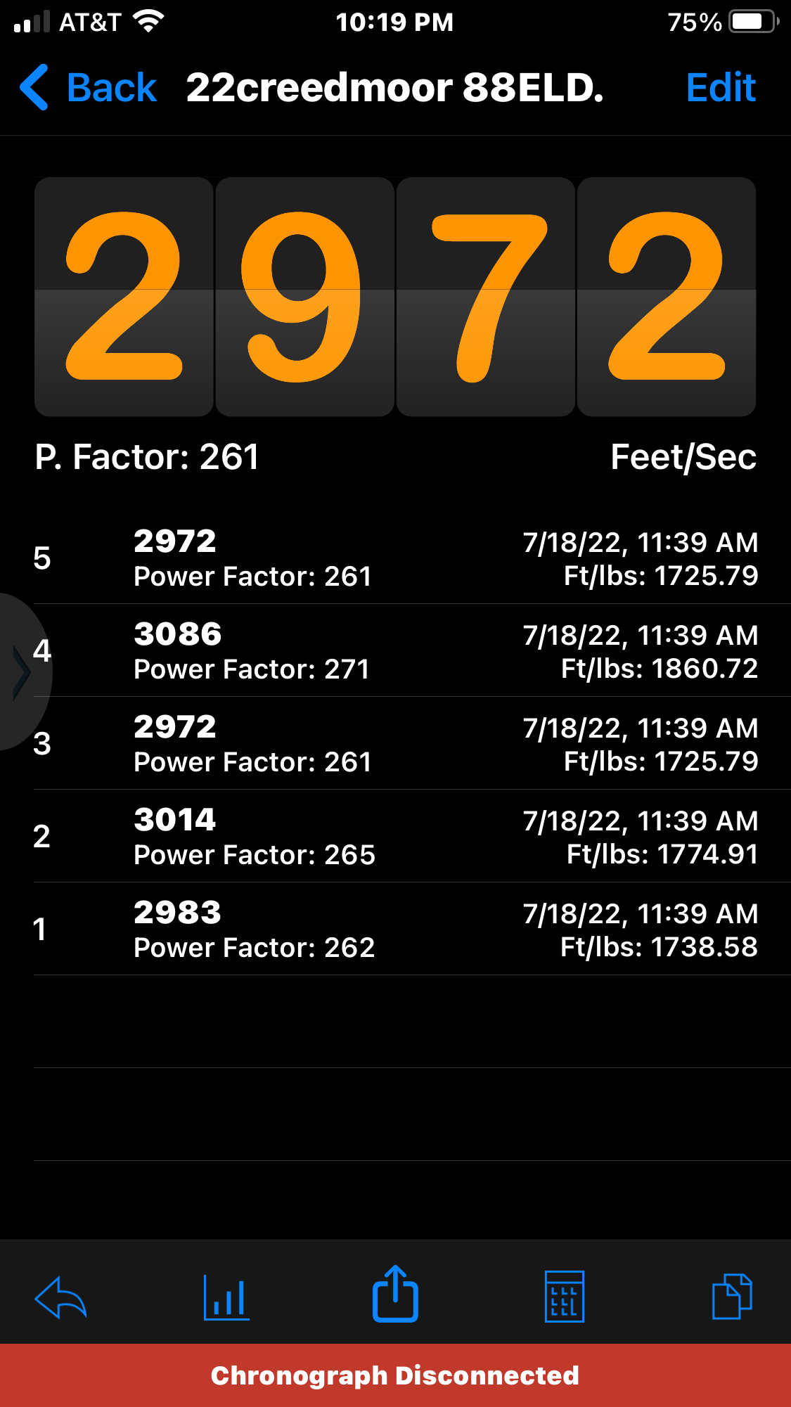

    Varget may not work with 88ELD.
    40grn Sw precision (varget copy).
    ELD 88... Do not use way too hot Blew primer out and destroyed case.

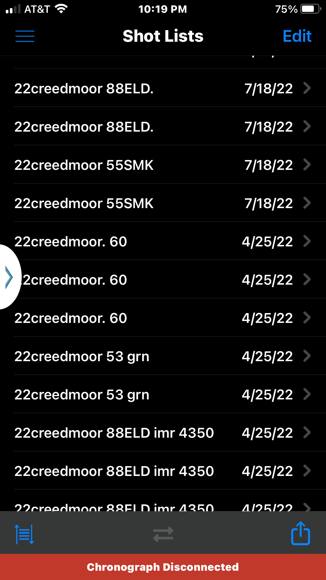

    Posted some of the screenshots from the chronograph info but I hope this gives someone some help.
