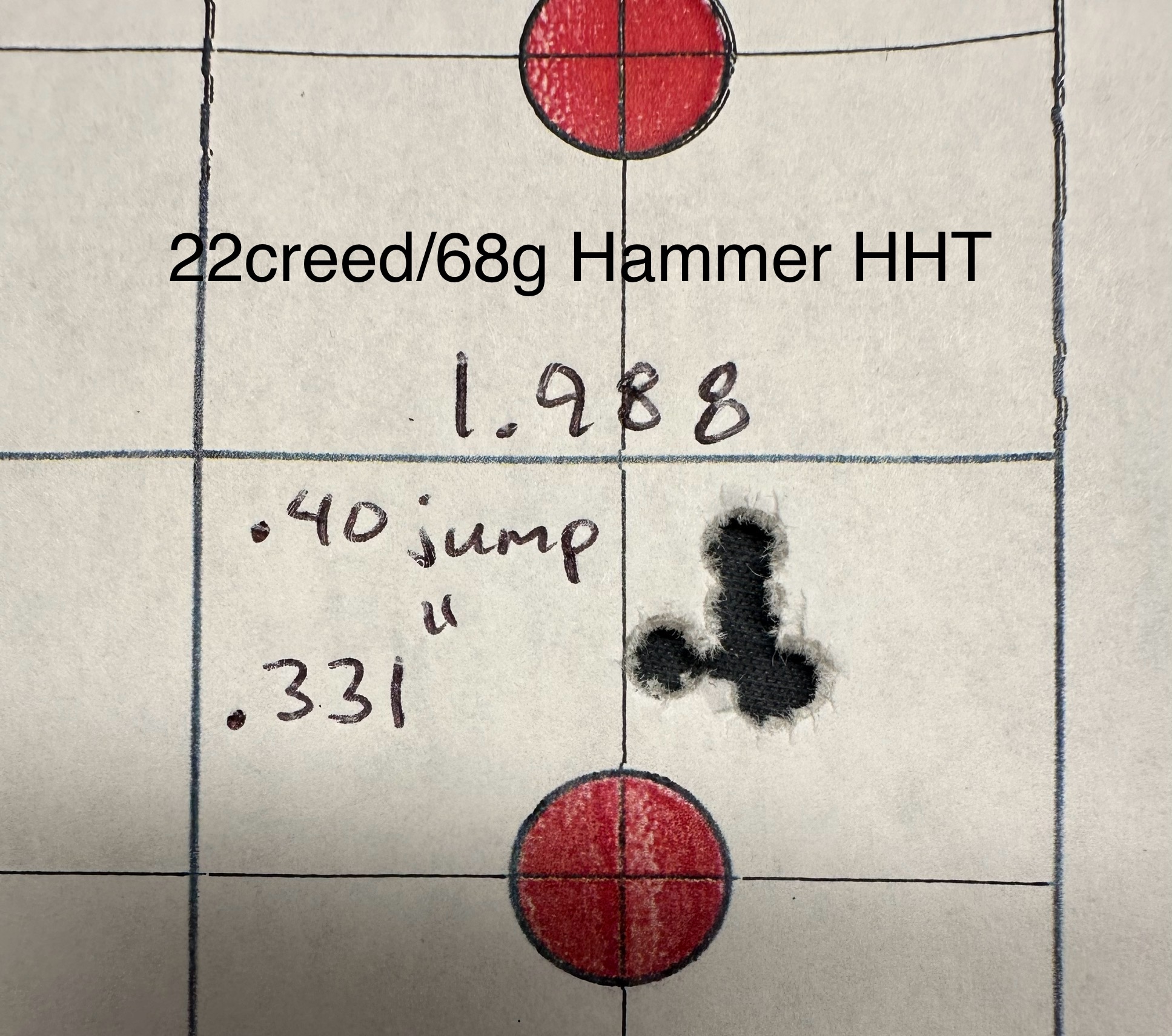

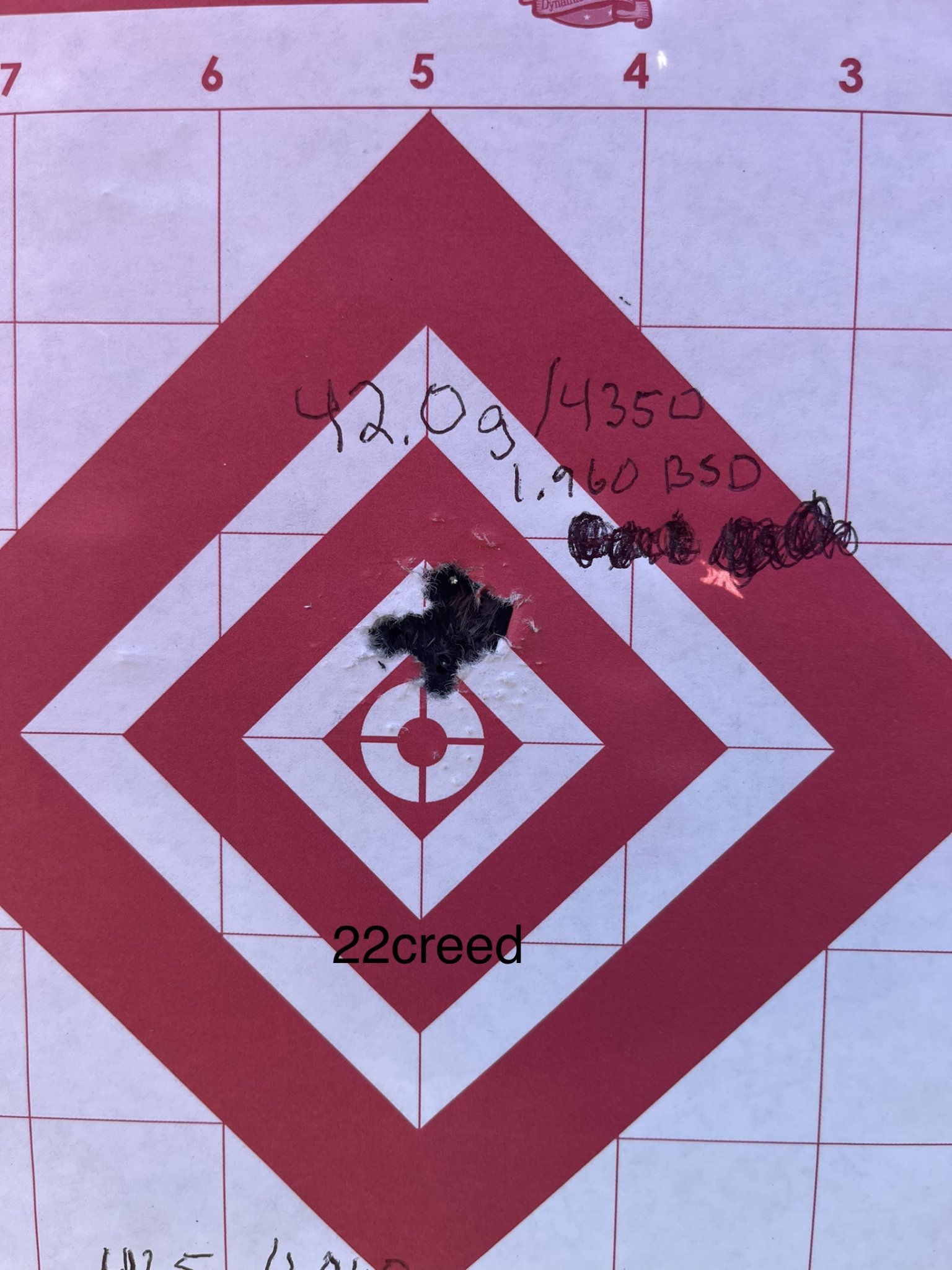

I understand the over RPM but in my experiences with 22creed fast twist shooting lights has been pretty awesome. Like Frank said quality ammo will come into play. My setup is a 16” 1-8t 5R barrel and I shoot both 60g Bergers and 68g Hammer HHT’s with Alpha SRP brass at exactly same speed which is 3440-3445fps. Never had any bullet failures yet but I’m not leaning on the Bergers hard like I am on the Hammers. It is a point and shoot rifle out to 300yds and it is mainly setup as my night/thermal setup.
