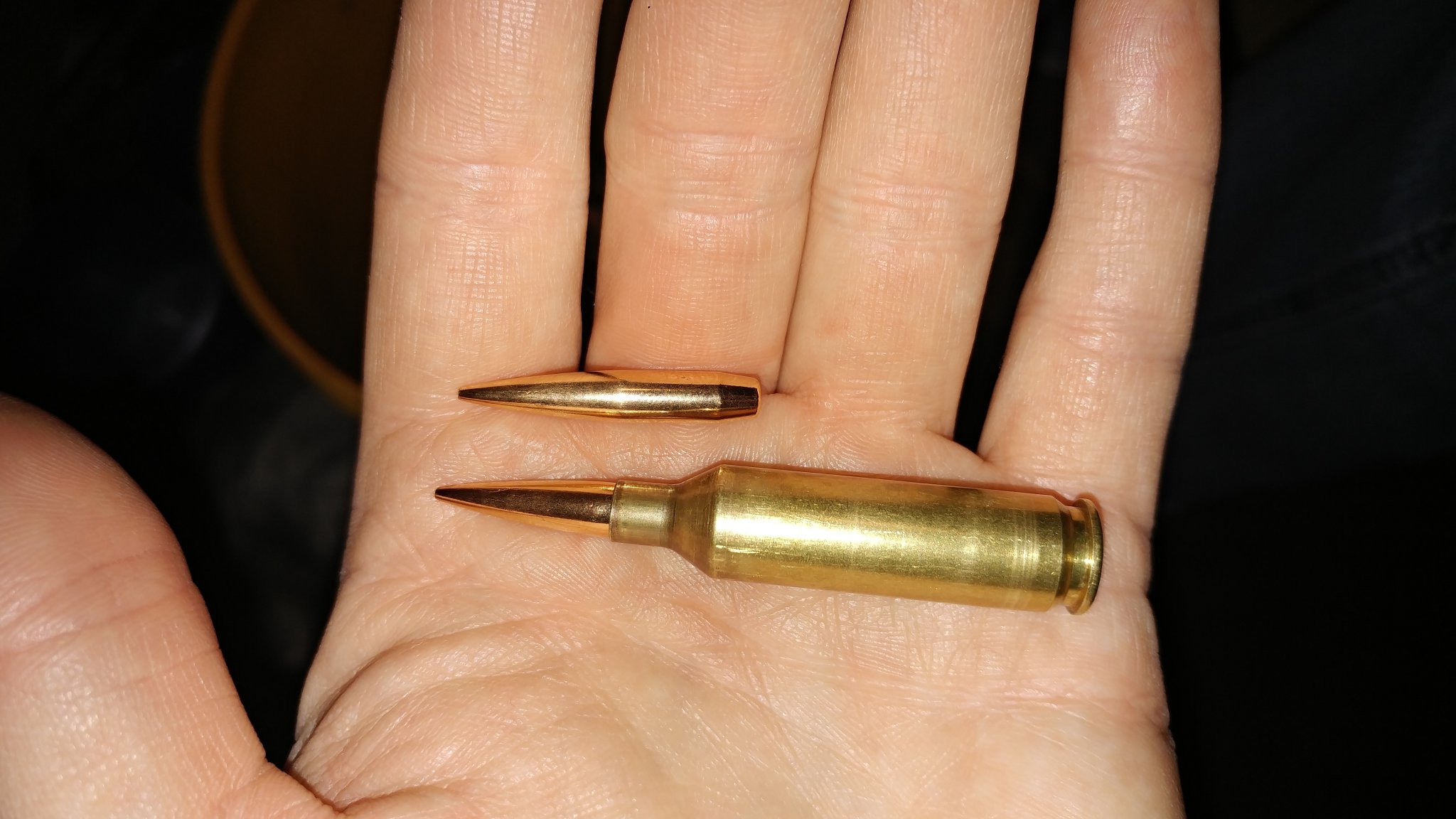

Mine was chambered by wade stuteville but with a friends reamer. I'm not certain of freebore but it's short more setup for 75-80 than 90plus. This is a 90gr vld seated 10thou off the lands.
