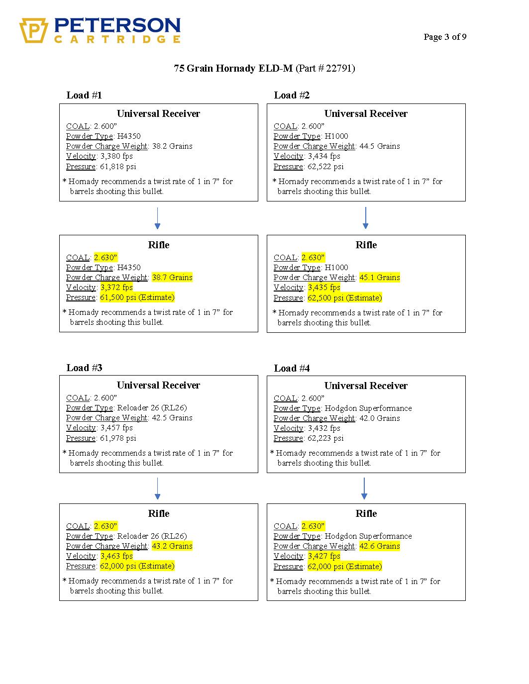

Hi everyone!
Just bought a 22 Creedmoor. Gonna shoot 75 Grain Hornady ELD bullets. 1:8 twist barrel. I'm going to use H4350 powder as well. I am looking for powder charges for the 65 grain bullet using H4350. Thank you!
Bullet RPM = MV X 720/Twist Rate (in inches)
3500*720/8=315,000 rpm, thats a lot but about what many 22 creeders are running. And Im betting when he typed 65 he meant the 75 he typed previously.
You might need to run a slower powder.
I ran into pressure problems with H4350, before I had decent case fill.
Ended up using RL23
With a 8 tw. should be fine if you keep the speeds under control. In the 3300 fps range.
Reactions: Trapper1956

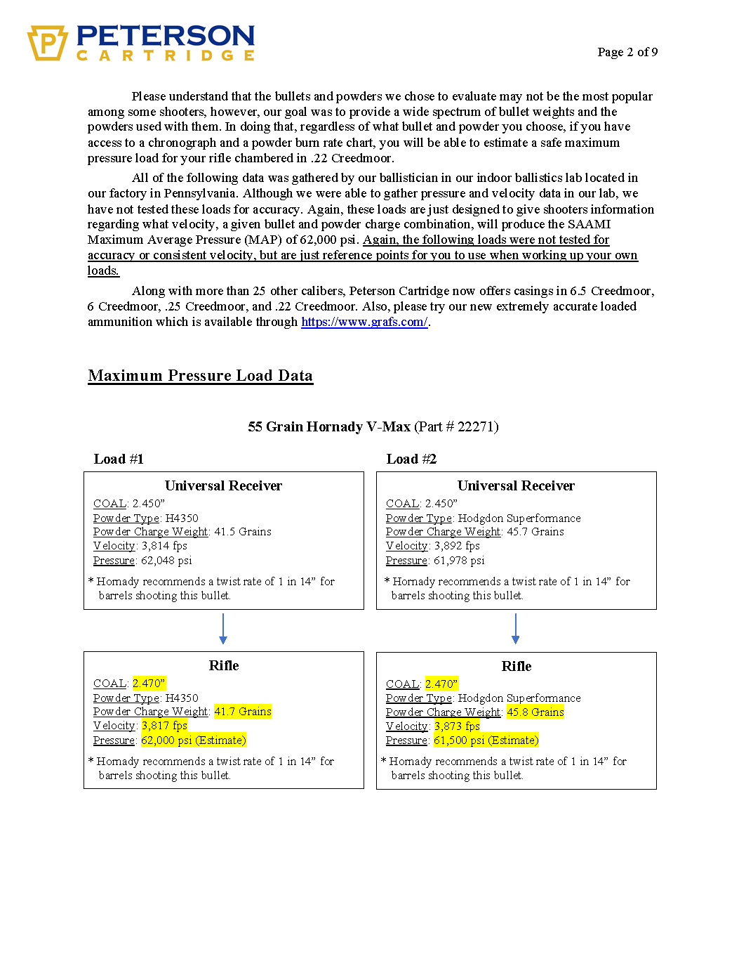

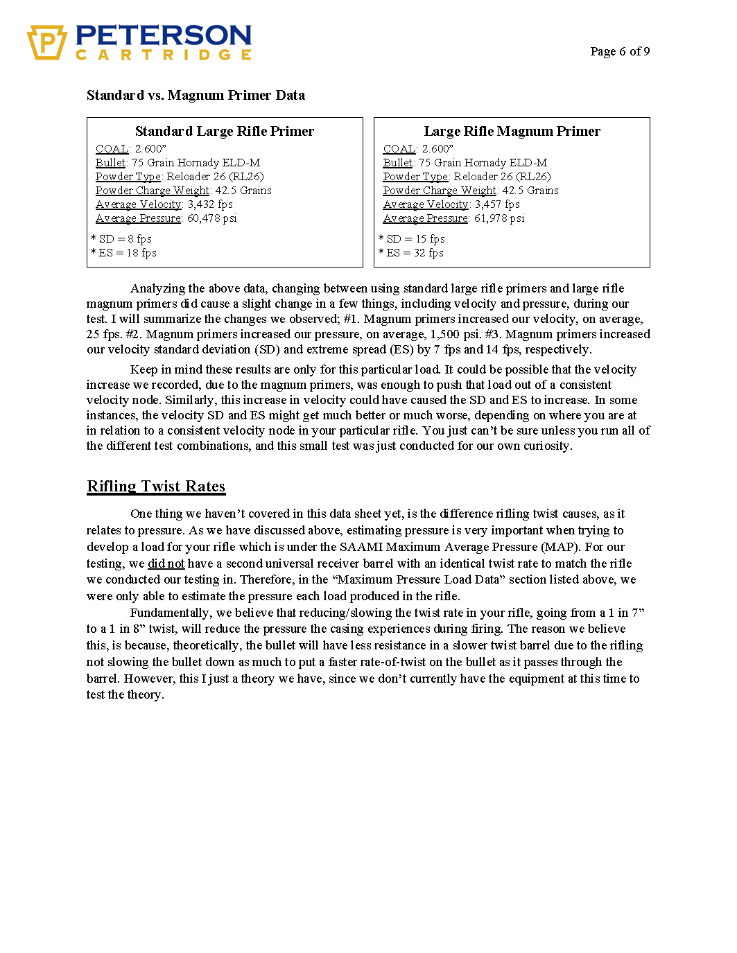

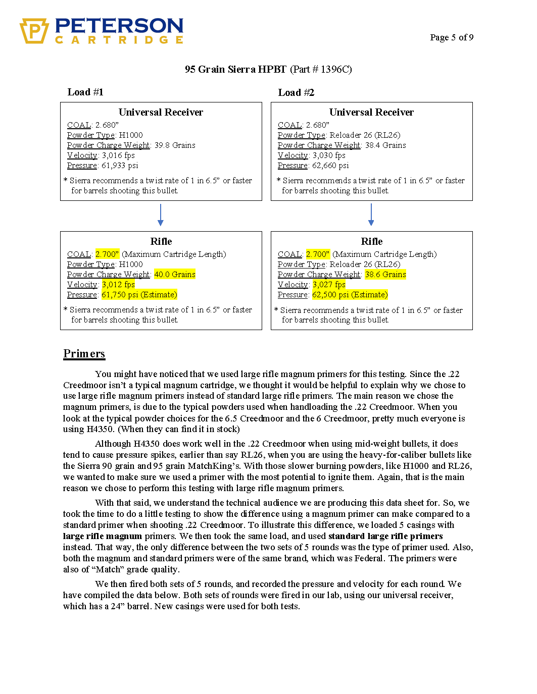

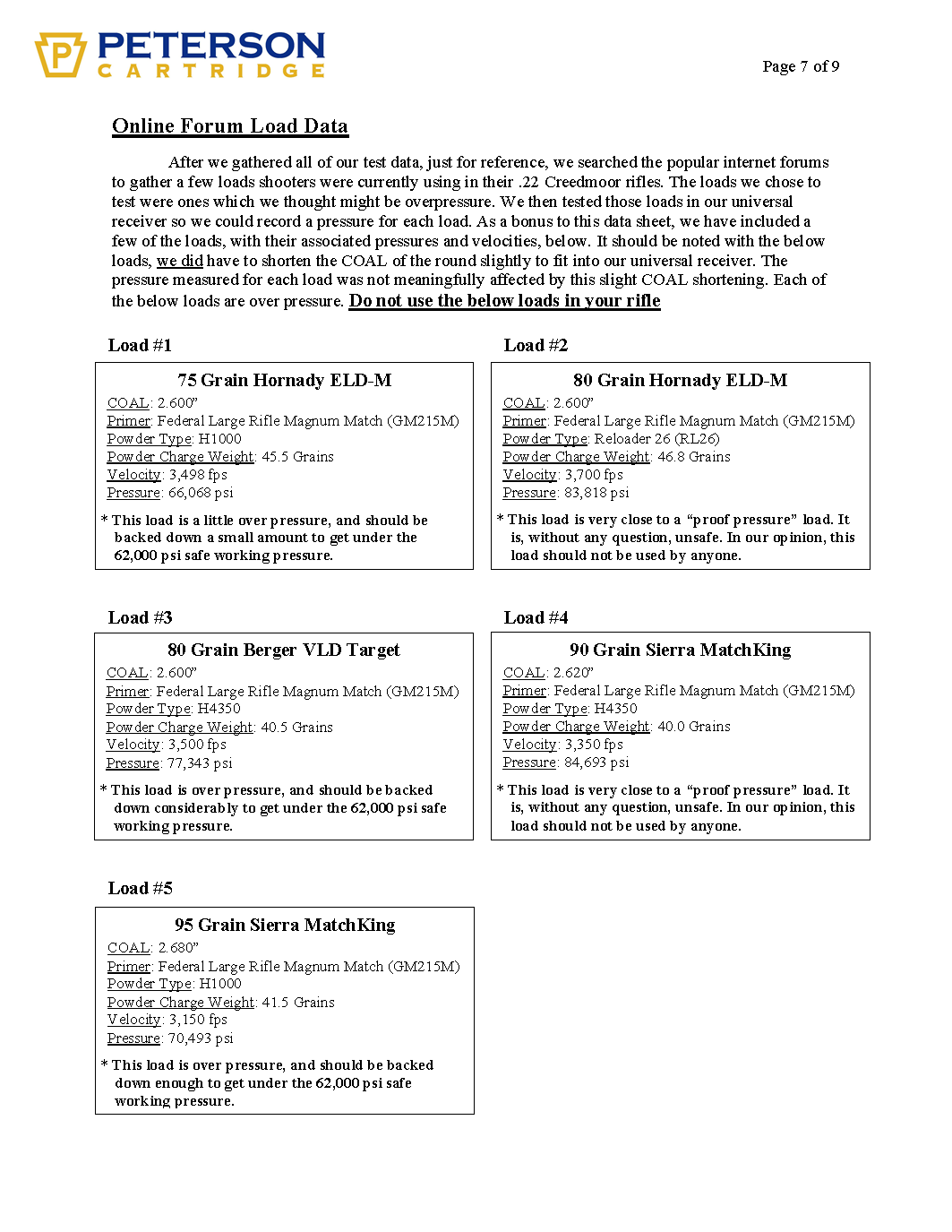

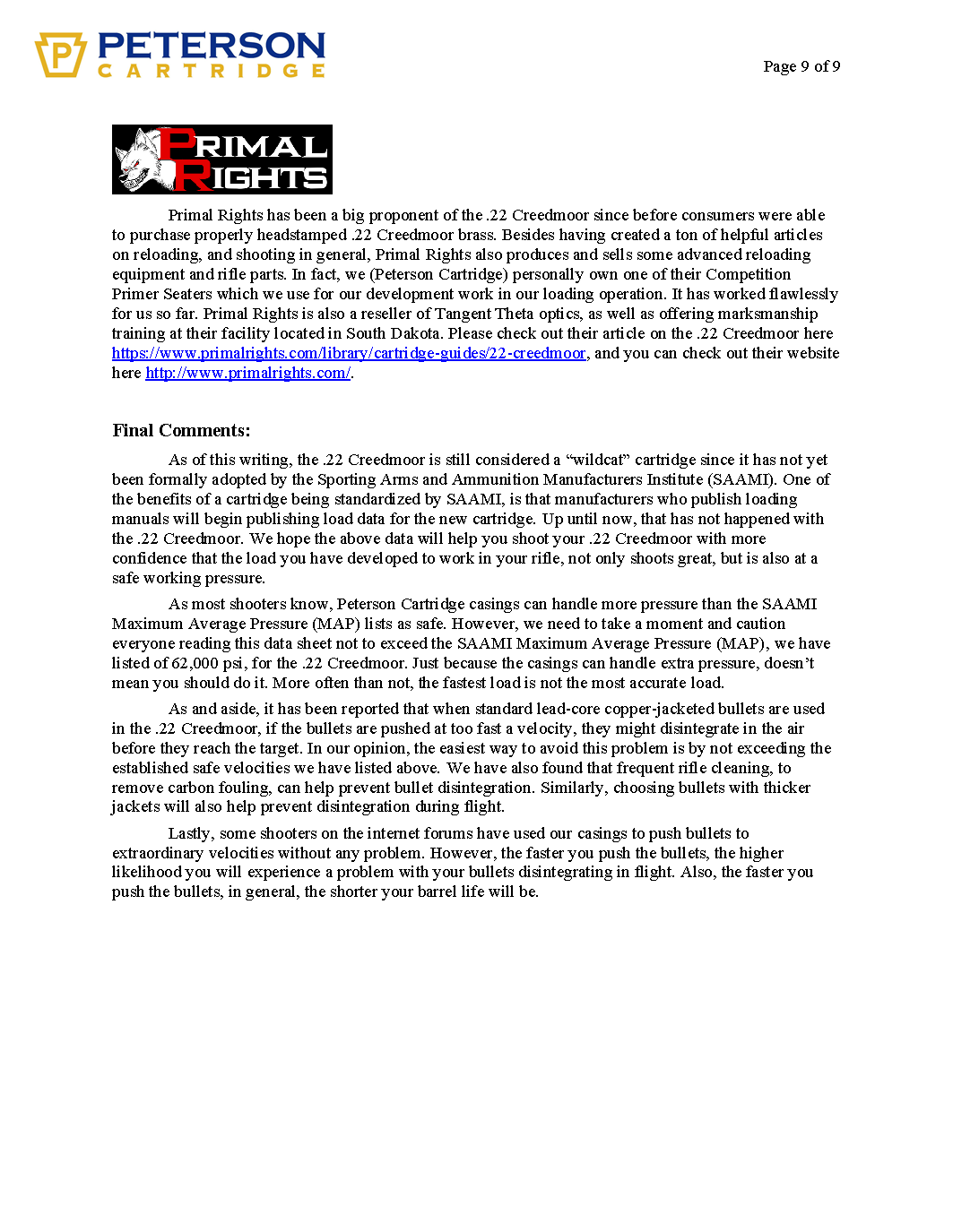

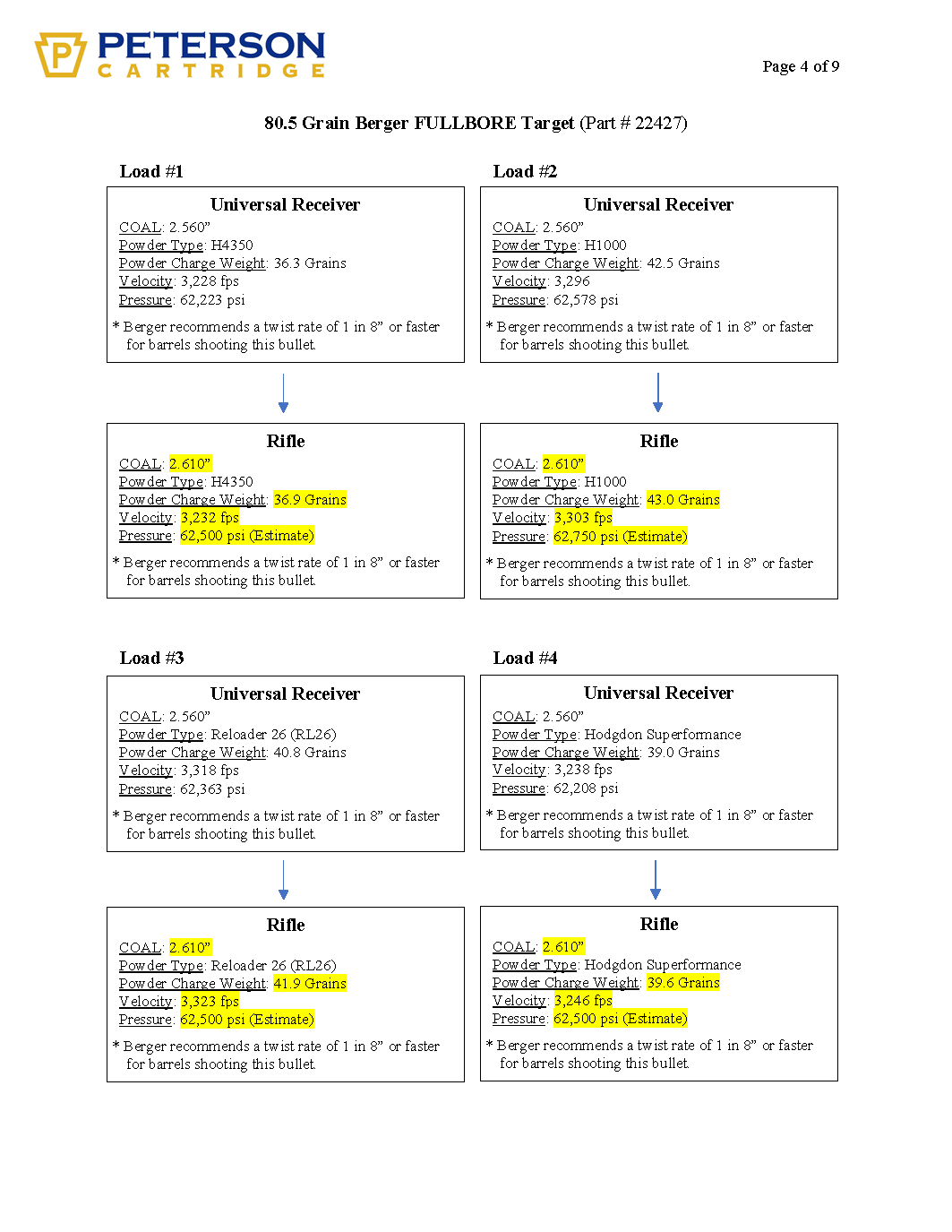

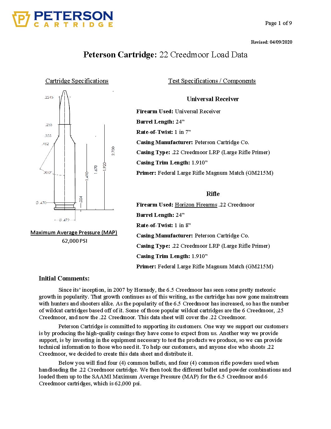

Here is some reloading data from Peterson
Definitely proves that when working with a new cartridge using someone else’s crazy ass load data posted on the internet is to be approached with caution and common sense. Where do they house this information? Wasnt able to find it on their site and wonder if they have any other new cartridges they have done white papers on. Would like to see this for their 25 creed brass as well.
That is very well done on Peterson’s part, really great data.
Yep, interpolating their rl26 data, I’ve got to be in the 70ks on mine. I’d definitely like to see if they have any more papers to read.

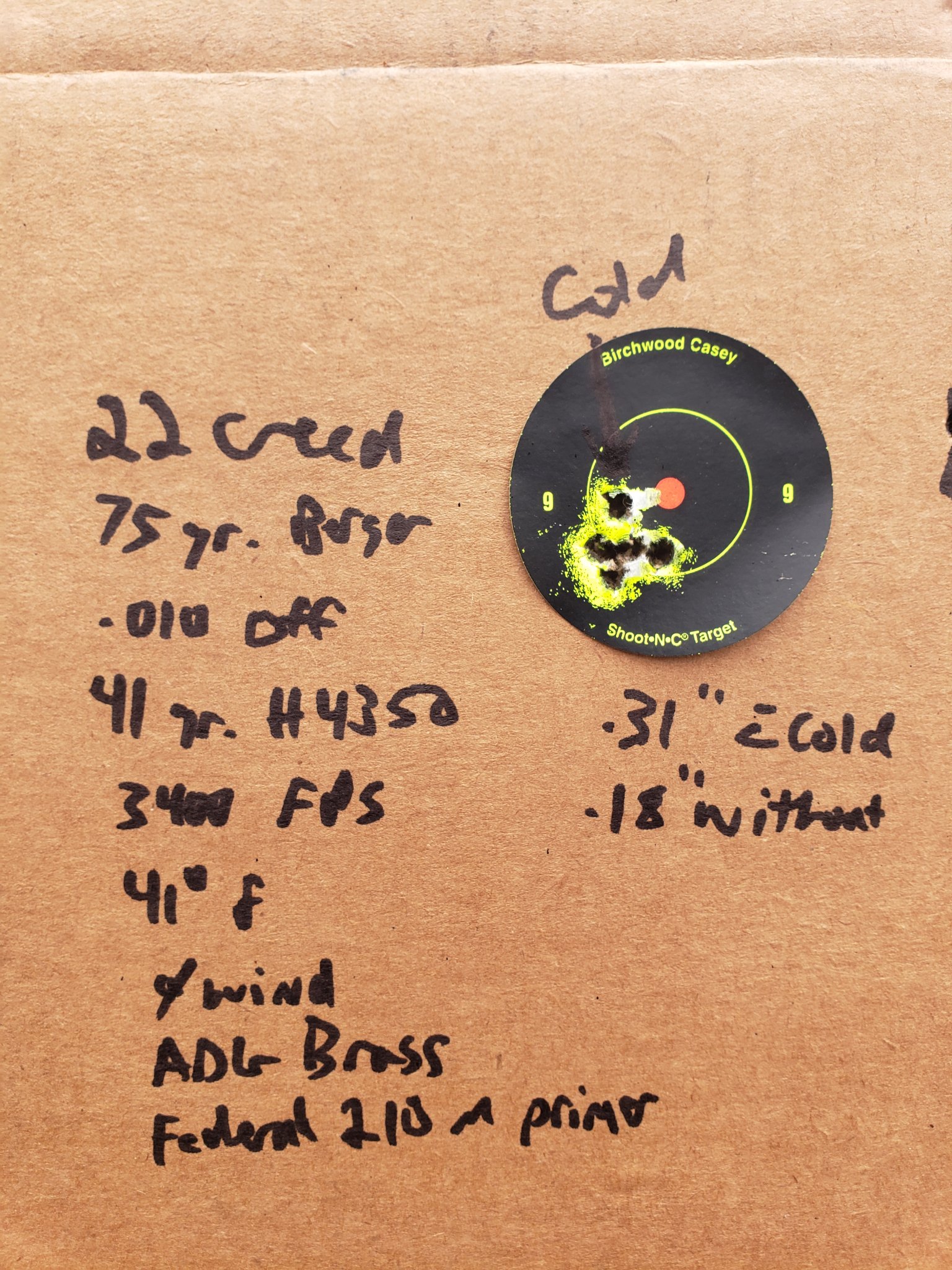

I ended up going with 41 grains of H4350 for my Berger 75 grain VLD bullets. I showed pressure signs at 41.5 grains, groups that weren't as tight, and a bullet speed of 3480 fps.
The muzzle velocity is 3410, and I feel like this load will get better when I reach 200 to 300 rounds through the gun.
Maybe they will start making 300prc brass soon and do the same testing. Have a feeling at least one of the fellas in the 300 PRC thread could use a sanity check, afraid somebody is going to blow their face off in there. :)
