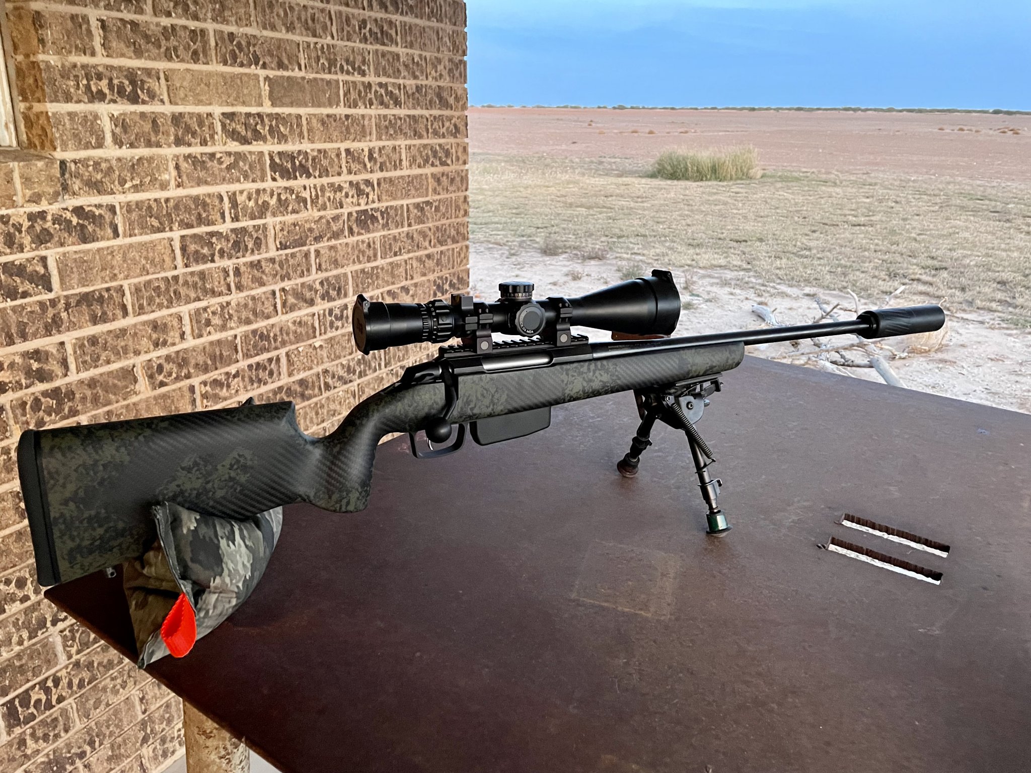

Yup. Built a 20” and a 17”. Stuck with the 17 and sold the 20. Dropped down to 69SMK with Varget for 3340mv. Love it for yotes, fast, accurate, and drops them. I did play with heavier bullets, accuracy was great, but opted for speed.

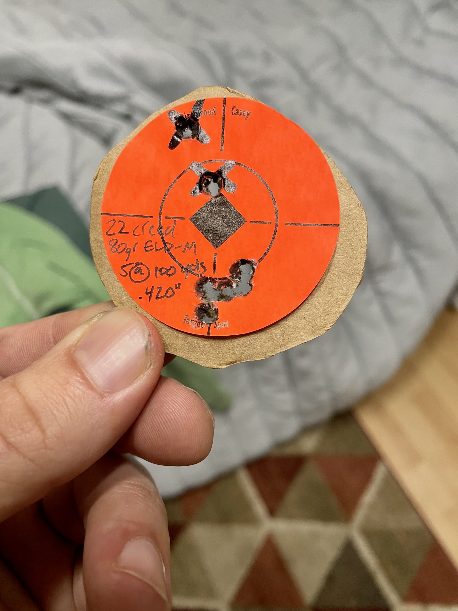

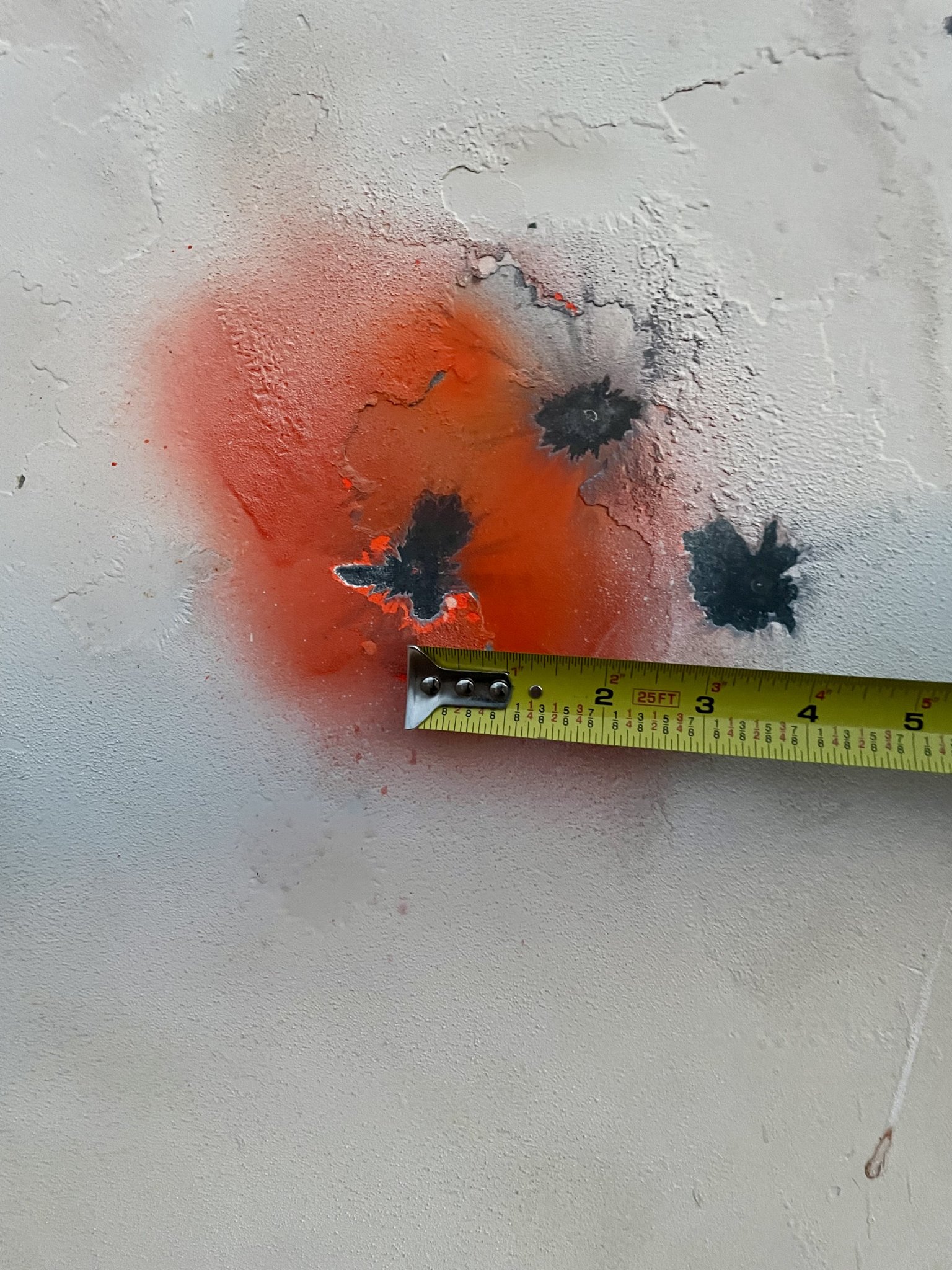

I’m running an 18” factory tikka 223rem 8 twist reamed out. Running 80gr elds at 2950fps forming Hornady 6creed brass that I resized. Although I took a few pieces of formed brass and it looks like it’s going to run 80gr at 3070fps with h-1000 at around ~ 44gr. Might try hybrid 100v also I think I could run the 80s near 3200fps with this Bbl. Also have 500 pieces of Peterson brass headed my way. And my buddy had a lightweight 16” built that were hoping to run 69gr TMKs out of at 3300fps.
Yesterday went out to 1040 yards about 30min before dark, it was still windy 10-12 with some mirage and I fired 2 shots to get on the 24x24” plate. Made adjustments and waited until right at dark and the wind had died down to 3-5mph from 3clock. Dialed 27moa UP and 4.5R and sent 3 down range. Not bad from an 8lb suppressed rifle in the standing position with a 2oz rear bag. This is from an 18” barrel running 80gr elds at 2950fps with 42.5gr of h-1000. It just hit 100 rounds so it has speed up some.
