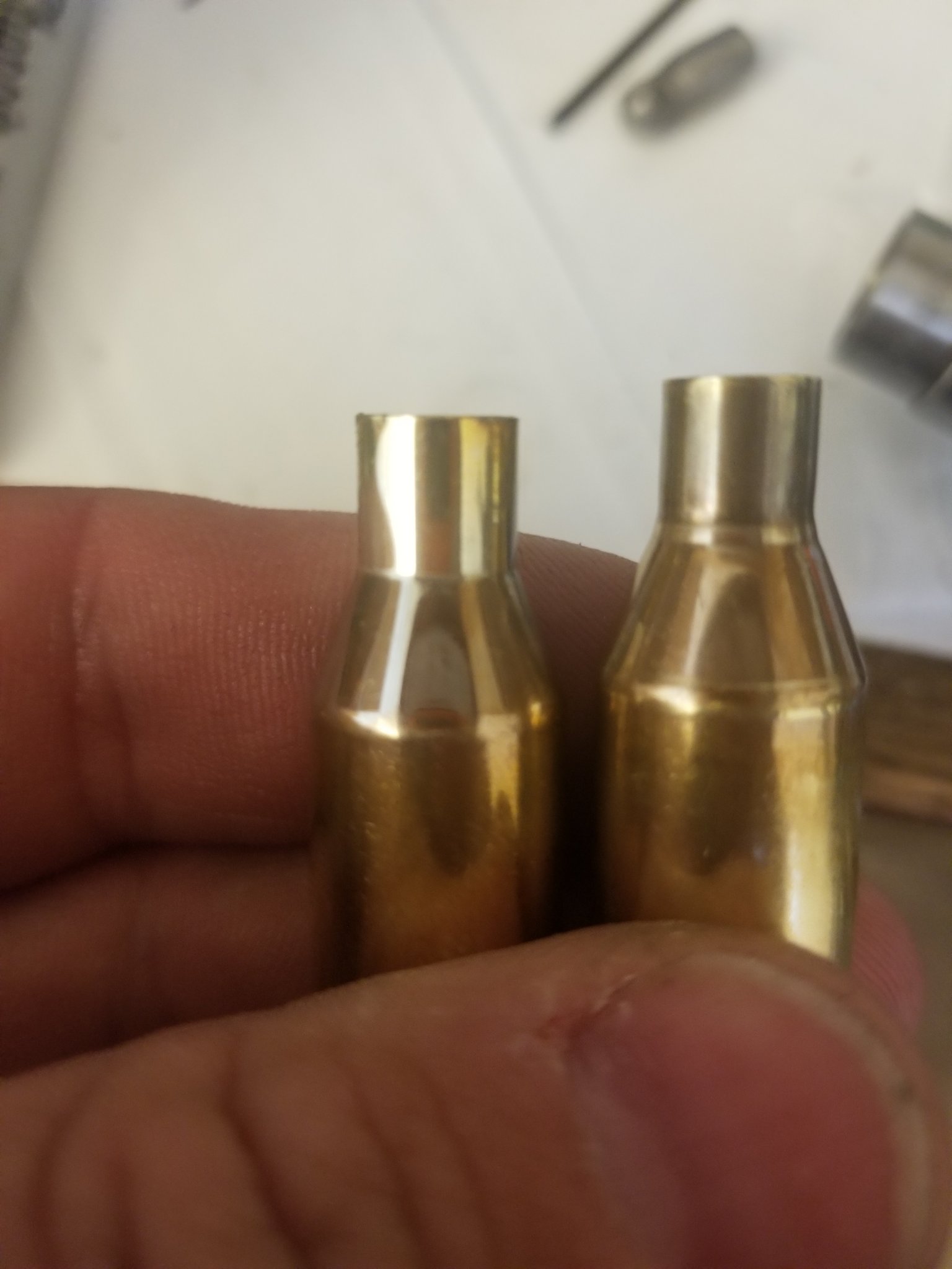

You shouldn't have any issues chambering when necking down with a bushing die. I had the same concerns since I'm doing a 7-300 norma mag and the gunsmith said it may be a little snug chambering but shouldn't cause an issue. I decided to expand a 7 wsm case up to a 30 caliber then neck it down with bushings, then I chambered it in my 7 wsm barrel. It chambered no problem at all. I neck down .010-.012" at a time and it works great.
@Bradu - thanks very much mate, that’s a very decent and generous offer but please don’t spend any of your hard-earned to facilitate this. I’ve got a message out to Forster to see where they’re going with 22CM dies and my gunsmith has offered to cut an in-line seater using the chamber reamer. I’ve got a bit of time yet, so will try to use that to advantage.
As an aside, one thing I do wonder about with sizing down 6CM (or 6.5CM) Lapua case necks to 22CM with a bushing sizer is the potential for a ‘donut’ that will be left at the shoulder/neck junction. No bushing sizer I know of sizes the entire length of the neck, so there is a unsized portion left at the n/s junction. I’d hate to have to neck turn to clean it up...
