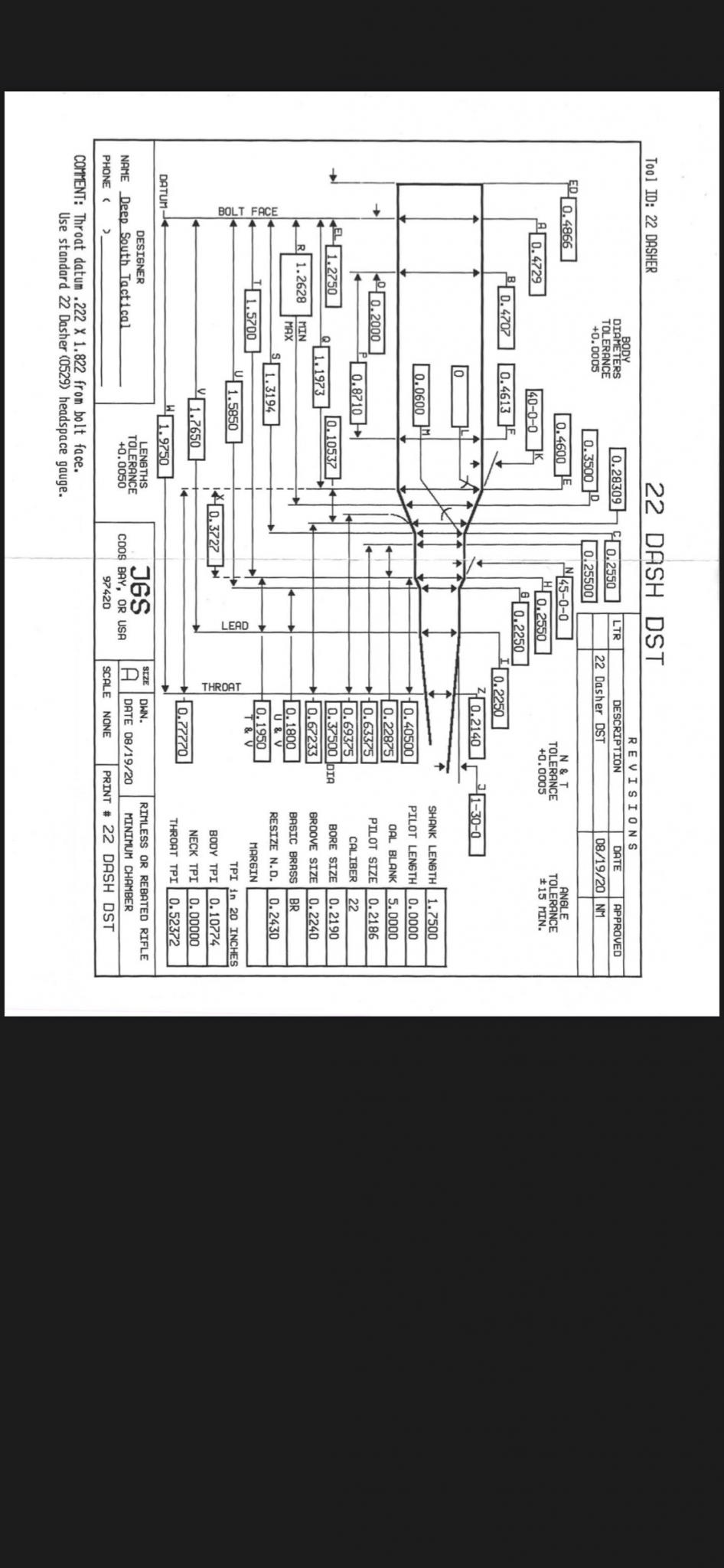

Best way is a custom FL sizing die. Typically can knock it down in one shot... but due to the 40 degree shoulder it's typically easier to neck turn 6BR, knock down to 22, then form as 22 dasher.
However, you can take small steps with a dasher bushing die, but all at once might risk collapsing the shoulder.

If you have access to the schematic of the reamer, you can figure out where the shoulder will be blown to and create a false shoulder by only turning the neck back to where the new shoulder will be. Best way I have found to produce nice clean shoulders on dashers and brx's, short of sending them off to let someone else hydroform them... :unsure:
