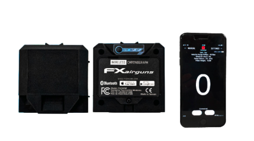

This is what I use most of the time. I do have a Magneto Speed V3 as well. The Velocity difference in the 2 is null. You just need a good starting point. The Sporter will work on RF as well a few people at the club have them.
** This was a test done at out Gun Club by @Chopping Broccoli **
