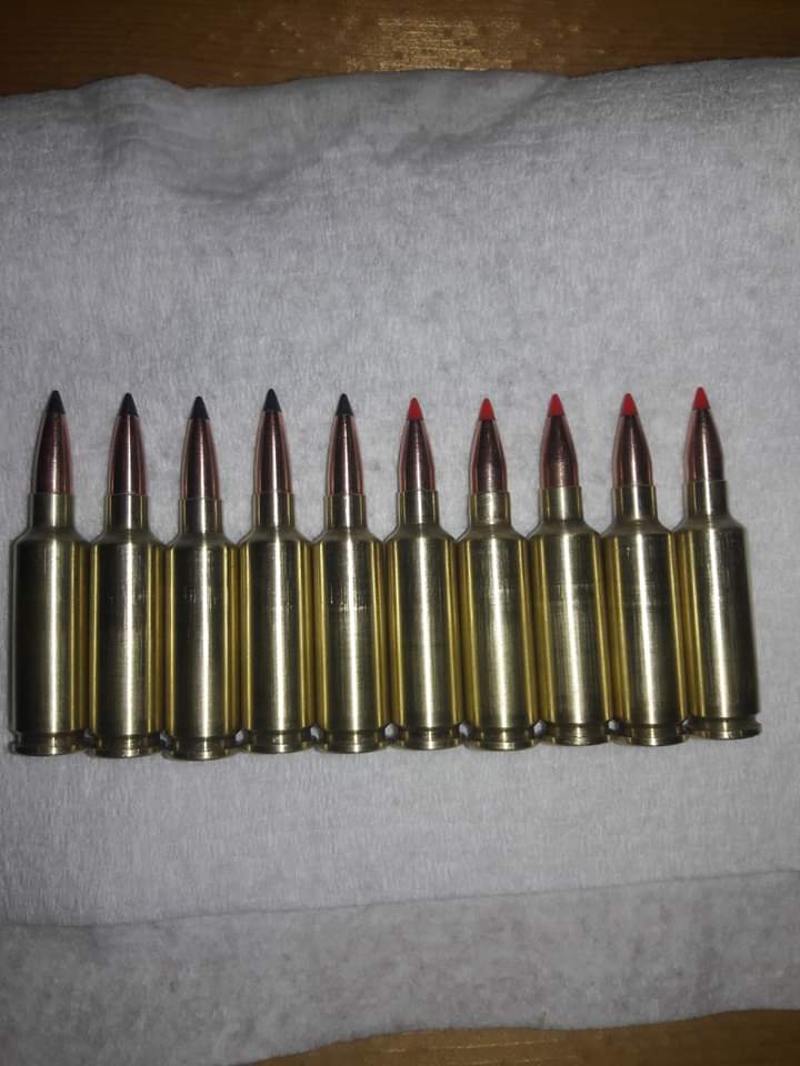

I machined my own reamers for 22 Grendel IMP, basically a Grinch from what little info i can find.
I can tell you Norma 22 PPC brass will offer 1+ gr capacity increase over Hornady and Starline and others from what info i can find from others.
Necks are thinner on Norma, I machined my reamers based off Hornady brass as is what i had at time, so have like .008 neck clearance with Norma which doesnt seem to shorten brass life or cause any issues.

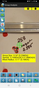

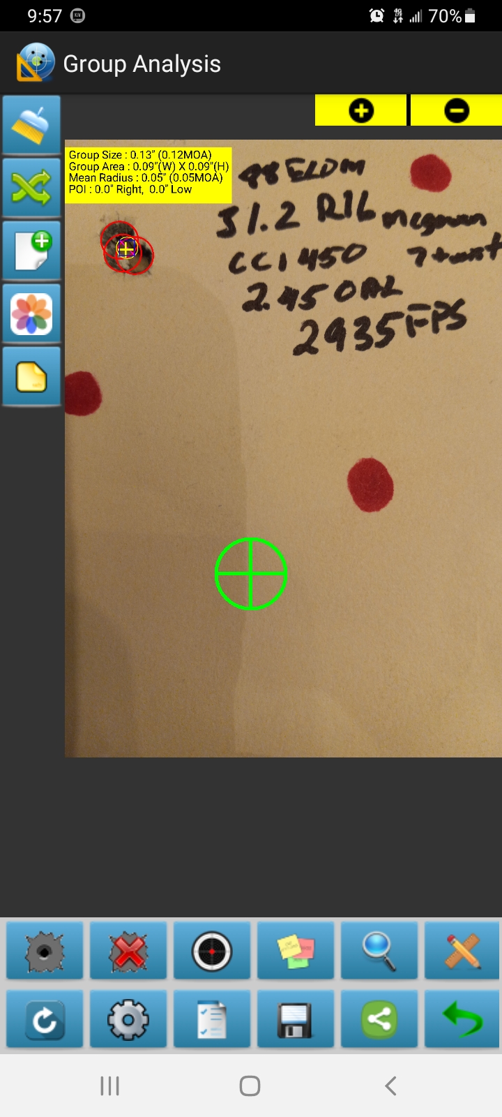

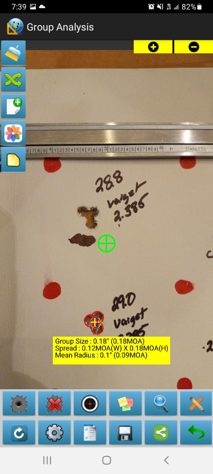

Originally this was a "feed 88 ELDM From AR mag " project...... i now have a 14 twist AR, 7 Twist AR ,8 twist bolt gun and will be finishing up a 7 twist bolt gun this weekend to stabilize 88 gr bullets.
Shot the 8 twist bolt gun at 1000yds (80 ELDM @3120) last weekend, was very happy with results. Hits and misses were easily spotted . Crazy switching winds prevented a hit on 4"×6" plate @1000YDS , 1/2moa plates were easy enough at lesser ranges
Posting on another forum promted atleast one other to have PTG grind him a reamer , so far he loves it.
My reamer has a shorter neck , slightly more capacity than what they came up with .
53gr and 50 gr
Or if you could give me base to ogive of a loaded cartridge with the bullet above the neck shoulder area for the 88's? I'm having a very difficult time figuring freebore.
What neck length will your reamer have?
Assume this will be for a bolt gun ? If you want base above shoulder.....
My reamer has a .2 neck , and because i knew i would more than likely chamber several barrels for different bullets..... i machined reamer with a short throat and also machined a throating reamer to lengthen throat for which ever bullet/oal i wanted to shoot in that barrel at same time/set up as chambering.
7 twist AR is at .140 freebore and load 88 ELDM 2.27 , obviously not going to get base above neck in AR platform but still get decent velocities and feed from SS AR mags no problem.... could load out to 2.31+ (in SS mag) but left some room for growth of throat.
On 7 twist bolt gun oal is 2.385/1.775 BTO and puts base of 88 right at neck/ shoulder junction for my reamer , this works out to .255 freebore.
Here is shots 57,58 and 59 from 7 twist bolt gun (88 eldm@ 2965 fps from 123 yd), first 56 were fireforming loads with 50 gr bullet for barrel break in.

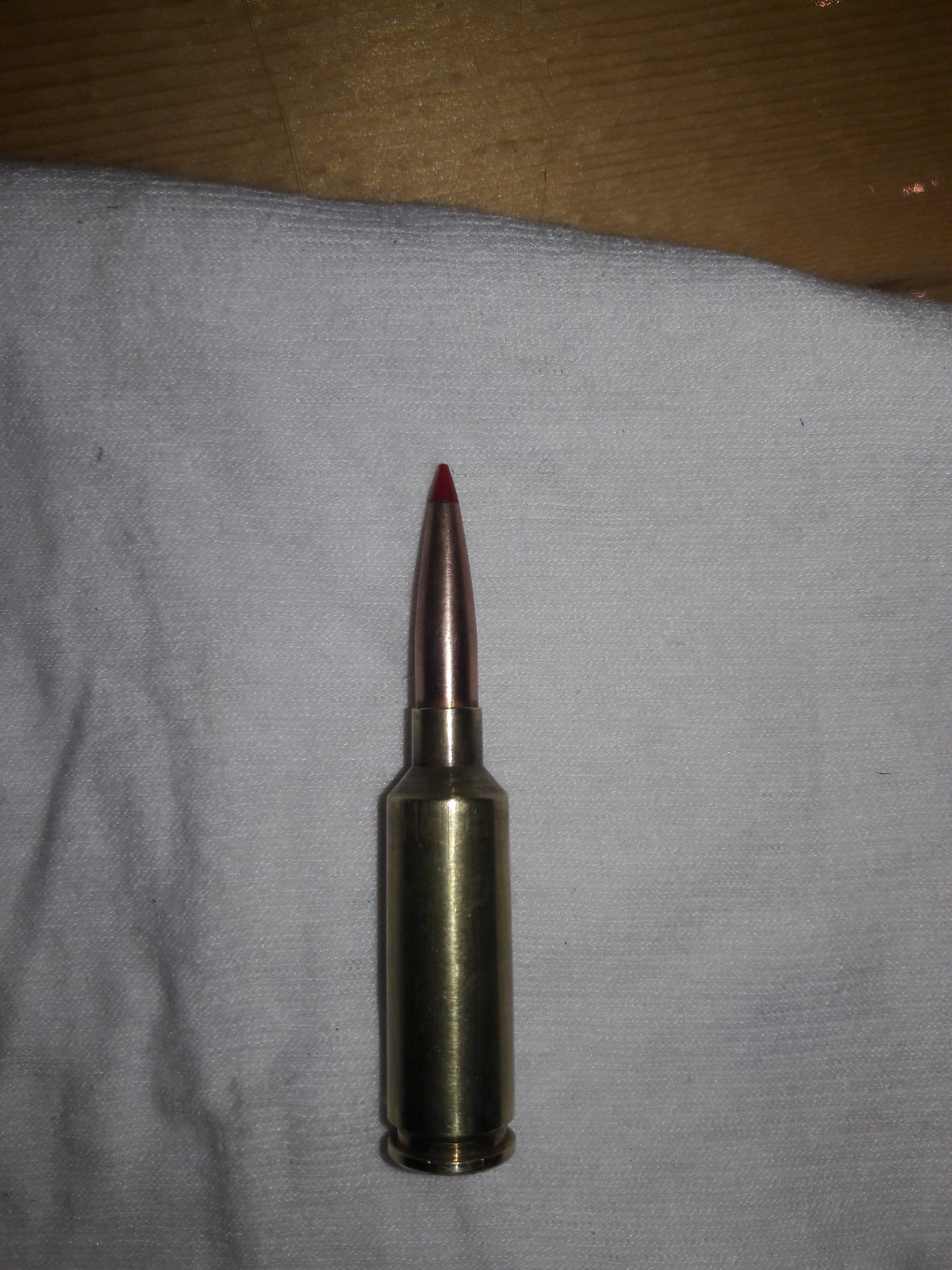

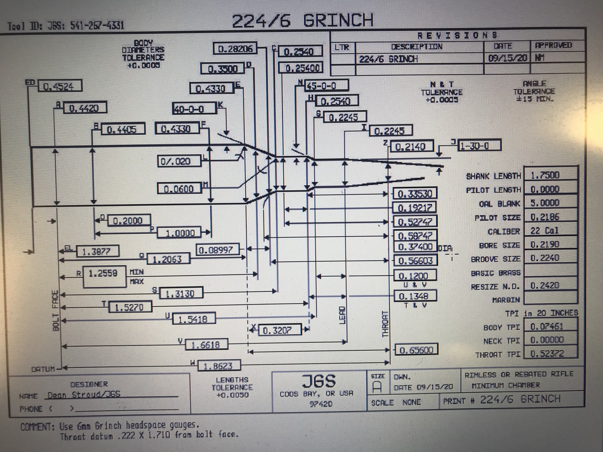

Nice little group there. Here is my reamer so far. It was done by JGS. I believe the neck would be 0.214 using the given measurements. 0.255 freebore sounds like a lot! Maybe you could give me some advice on my reamer? :)
.255" is alot.... but 88 is 1.24" long -.175 for BT =1.065 of bullet above BT+ 1.52 ,case length=2.585 -.2 neck length (my reamer) = 2.385"
Long bullet and short neck = long freebore to be at/above neck shoulder junction.
Your neck length (of loaded rnd) should be @.207 IF your brass is at 1.52", if trimmed shorter or use Norma brass actual neck length will be less but not an issue other than possible carbon ring ... something i am keeping my eye on with Norma brass as it is 1.505 after forming in my chambers, but as already mentioned i only had Hornady 6.5 brass when i machined reamers for size die and chamber...... so far all is good with shorter Norma brass.....
Other than small differences your reamer is really close to mine ...
What size die will you be using?
For life of brass should make sure it will not size brass down too far (dia) that fired brass grows more than 1.5 to 2 thousandths at .200 line and shoulder.
.254 neck should work fine.... mine is .2555, which is larger than i prefer for Norma brass but what i wanted for no turn Hornady....
Not sure how easy it is to see in pic ... line around bullet (towards bottom of black sharpie) is start of bearing surface of 88 ELDM , there is ..872" of bullet outside of case @ 2.385" oal.
Makes sense. I put some dykem on a bullet and just did the same measurements. Came out pretty close to your measurements. There is a little eyeballing involved. Lol.
Would I be better off borrowing your reamer? 🙃
I haven't even thought about dies yet. I plan on reaming the chamber myself. How hard is it to make dies?
With a mic. and depth mic. You can get exact measuements on bullet.
I did the above pic for reference.
The reamer print you have is fine, (sorry , i dont loan or rent my reamers/tools) i would just prefer to have size die/sized case or have reamer manfacture also grind a size die reamer of correct dimensions to ream size die blank or machine your own blank.
Dies are not hard to make , just need a reamer couple thou. Smaller to ream size die.
Use mandrels to expand neck for proper neck tension/ necking up to form false shoulder to fireform, these are easily machined as well
I use a seating die (Hornady 223 in this instance) to seat bullets. Hornady seat dies are same per caliber...ie. 223 is same die as 22 250 etc....
If building a bolt gun 22BR or one of its offspring would be easier/cheaper as dies are available . Only reason i built bolt guns is this started as a ultimate (for me) AR caliber to push 88's as fast as possible and feed them from mag.

I machined the reamer exact dimensions i wanted (actually machined die first , then chamber reamer to match) but is also different design than any i have seen before..... might try to patent it or sell idea to die maker.....

Work and deer hunting have kept me busy. I haven't had time to order the reamer. Question: How much do you have to trim your cases after fireforming? I am curious if you could spec the neck length a little longer because of brass stretch being that it is sizing down to 224 cal. Have you thought about using the starline un-formed grendel cases? I was thinking that these might allow you to get longer necks?
Grendel brass is 1.52 max length, 1.515 trim length. After necking down to 22 cal ,brass is less than trim length.
22 PPC is 1.505 IIRC before forming which also is less than trim length.
So no initial trimming is needed and because of 40° shoulder, hardly any trimming is ever needed,another reason i love this chamber!
Some of the hornady brass has 8+firings , Norma is at 6 firings.
I do have a couple of each brand with loose primer pockets load testing 8208XBR powder which gets crazy up top.....
When i drew up my reamer..... i wanted max capacity, doing a little measuring..... 223/556neck length is .203" i figured if it works on 223 should be fine on Grendel.
Which have no reason to think i need a longer neck length.
The 40°shoulder keeps the flame intersection inside the neck of case vs in the throat, ( if you draw a straight line continued up shoulder angle through neck) my thinking is this should help with throat wear.....
I machined my reamer with a .2" neck length for a case length of 1.52".....
I had not previously seen the brass you speak of.
It would require many steps to get down to 22 caliber. It could be done and would result in a longer case. Also would require several annealing steps before actual firing, seems like lots of extra work ...
More than one way to skin a cat as they say.....
I am pretty happy with the reamer i have now..... if i see problems later down the rd with earlier than expected throat wear/barrel life i may change my mind.....but for a AR and bolt gun chamber i think it should be pretty good as far as performance vs barrel life....
Base to shoulder is 1.23" .
Adding it all up it looks like you left 0.017 space from the end of your brass to the end of the neck chamber? I used 0.107 as the length of the brass from the shoulder to the neck. For your chamber I had 1.537. Minus 1.52 = 0.017
My compound scale is off a bit, shoulder is actually sharper than 40°.
As i said before i machined size die reamer first without giving that a thought..... so instead of machining another reamer and die ...i just used same angle on chamber reamer so they would match.....
So a little longer neck for a 40° shoulder would "probably" be beneficial to keep flame intersection inside neck instead of outside in throat...... this is all "thinking" have not actually tested..... but makes sense in my mind.... unfortunatly Norma brass with shorter neck puts flame deflection point right at/just in front of case mouth until it grows.
Shoulder is 1.23, base of neck is 1.32 for .09 or .290" shoulder to end of case.
Total chamber length is 1.526 to try and keep a carbon ring from forming at end of case.... so with this reamer cant run a longer case anyways.
This was dimensions for hornady brass, the Norma neck length is less than .2" , measured after 6 firings and is growing some, but doubt i will ever have to trim other than for consistency in length .
I know we are not talking lots of gain in case length, but making case longer (in AR platform) is heading towards Valkrie short comings but no problem in bolt gun.
Like i said more than one way to skin a cat.... this is my way, not saying its the right way.

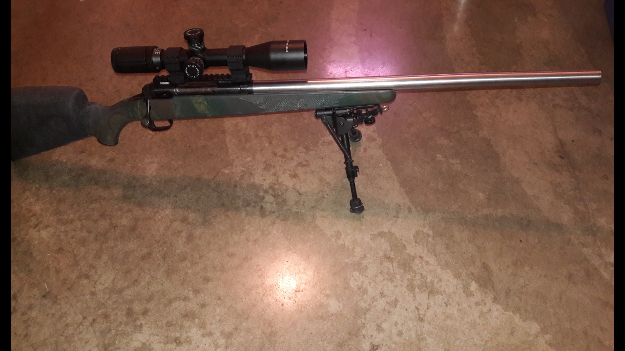

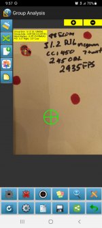

I recently chambered up a spare 7 twist , this one a 28".
Doing load development it likes same loads as other 7 twist and hammers like all the other barrels cut with same reamer.
