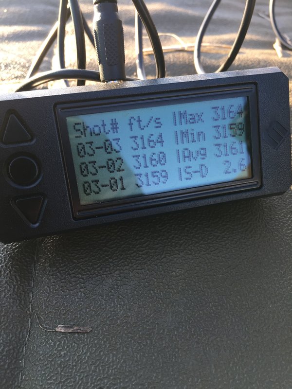

22 Grendel is a nice little cartridge especially with the current lot of high bc projectiles on the market.
Speeds shown are with 75 eld's. I've backed them down to 3080 with no pressure signs.

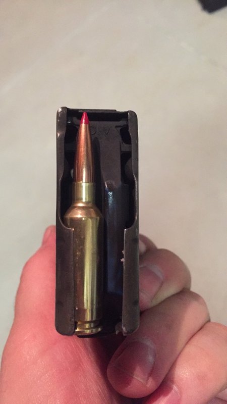

Did you cut them yourself? If not, where did you get them?
Cut them myself. Takes about 3 minutes with an angle grinder. You can cut aluminum mags with aviation snips but they flex to much when cut. The 20 round SS ASC mags work perfect cut. I think I went .5" wide by 3.5" deep and it easily holds 15 rounds with no swelling.

Exactly what did you cut? You have any pictures of the mags? I’ve been looking into modifying a couple of mine, but have seen several different ways it’s done. Just curious how your turned out
