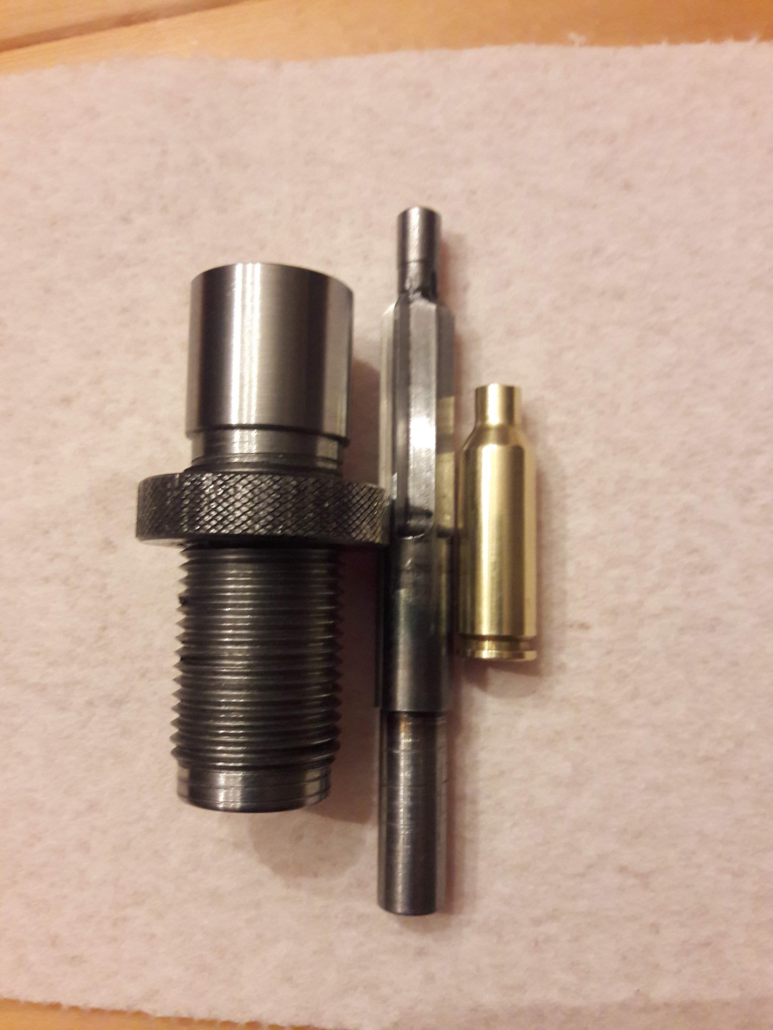

I machined chamber and size die reamers couple months ago.
Chambered 2 barrels for AR, one a 22 " 14 twist and a 27" 7 twist.

Norma PPC brass offers 1+ gr of H20 capacity vs
Hornady =36.2-3 gr H20
Norma=37.4-5 gr H20
PPC is also loaded to higher pressure than Grendel so brass may be stronger in base as well ...have not dissected one yet.
I find it easier to produce brass to fireform from PPC brass than Grendel also.
Run .242 mandrel then size back down to form false shoulder.

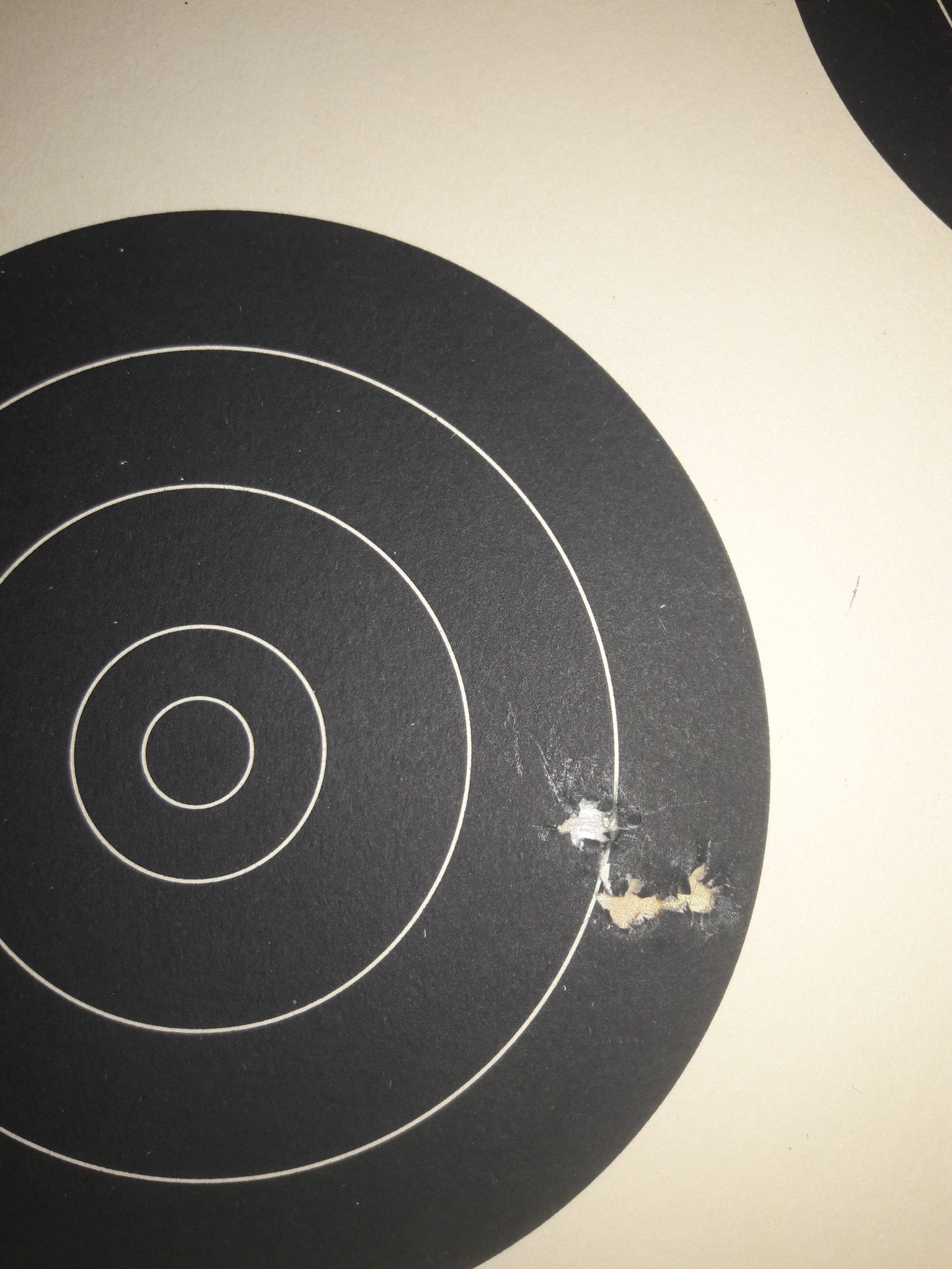

First 3 shots from 27" 88 GR/ R16 @100YD /2800 FPS
I picked up a Ruger AP in 6.5 Grendel, chambered a 27" .224 8 twist for my 22 Grendel IMP
Hopefully this barrel will pick up some speed with more rounds as it is 75 fps slower than 7 twist on AR with same 88 gr loads.

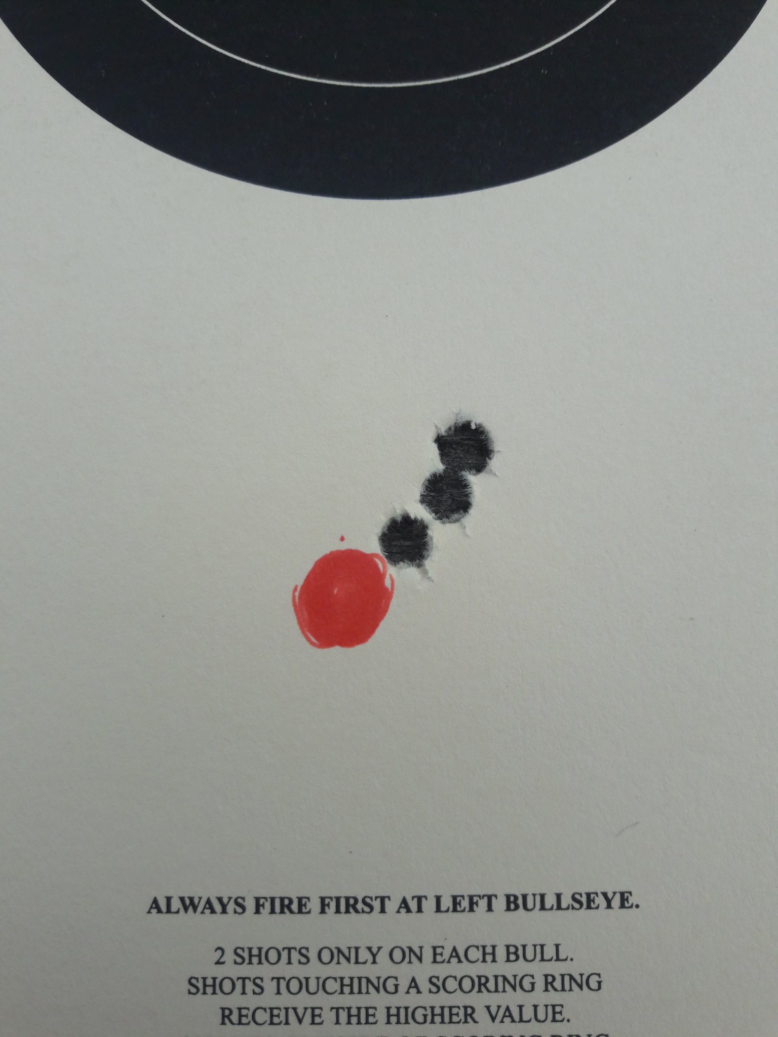

Got 80 Eldm's up to 3150 but node was at 3100 fps.
5 @ 100 yds
3 at 650 yds
88's seem to shoot ok from 8 twist, 3 i loaded to test was under 1/2" @ 100 yds.
Imagine B.C will be compromised somewhat, will report findings when I have a chance to shoot 88's at longer range.

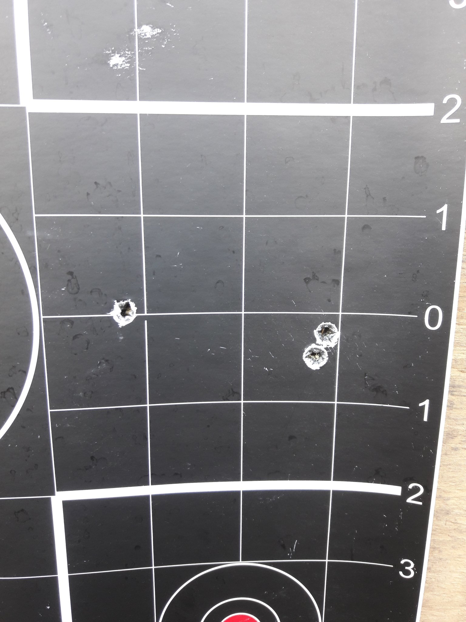

Loaded more of the 88's..... no go from 8 twist . Must be on ragged edge of stabilizing, even at 100 yds every once in awhile is throws a flyer that upon inspection of target shows a not perfect round hole.
On the other hand 80 ELDM's shoot good at 3120 fps (same 3100/load above, barrel picked up more) .
Testing couple days ago i shot 3 80's at hole made by 88 flyer @108 yds all 80's went through same hole.
3 80's upper right

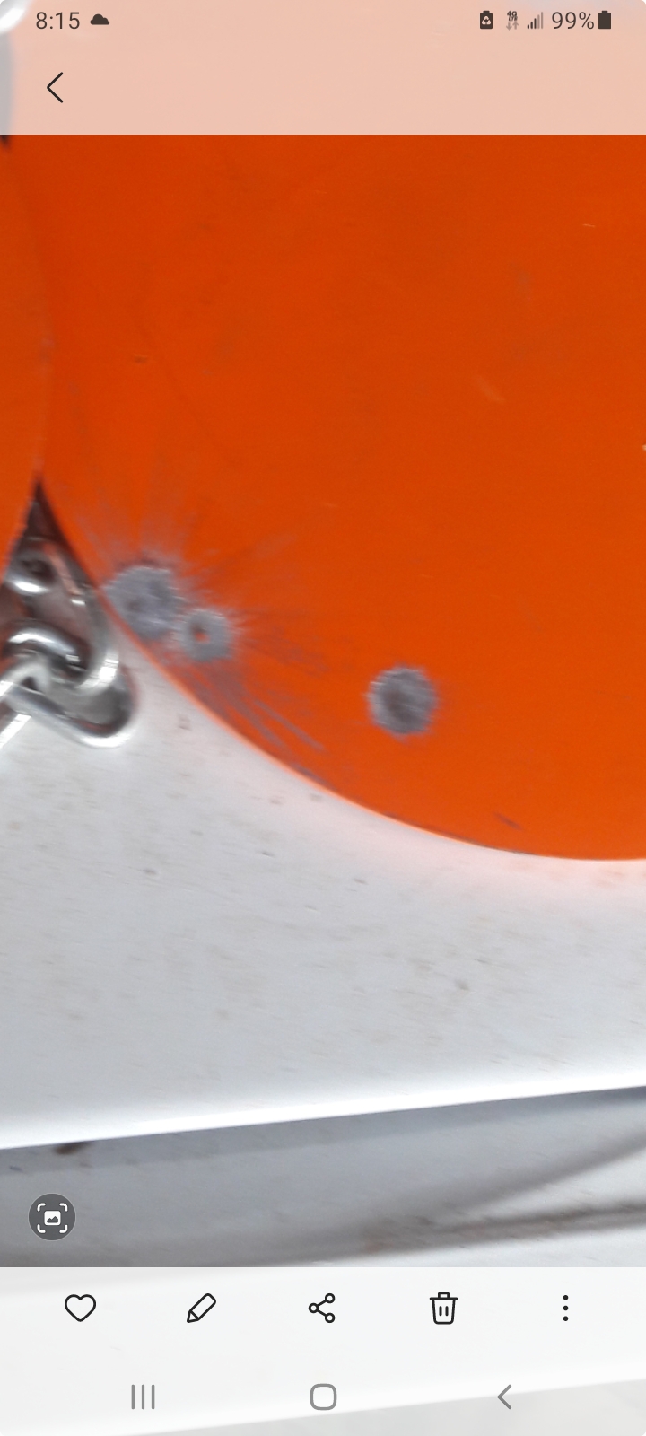

Took bolt gun to 1000 yd range yesterday , hits and misses easily spotted .
.5 moa targets were easy enough except at 1000 yds, time we got there wind was 6mph but switching constantly, making it tough to correct for wind.
Just couldnt connect on the 4"x6" plate. Impacts was barely off left or right edge, all in all happy with 22 Grendel IMP.
