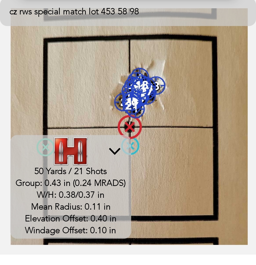

if you're doing bench rest Abra or Ara near me they shoot around about .5moa at 50 yards for 20 shots, consistently with the boltys. about 1moa for the good semis.
for a precision rimfire build my goal is about the same at .5moa for 10 shots, same as my centerfire prs guns.
my rimfire build isn't near done yet so I have no idea if I even got close.
I feel like this is a solid shooter, I'm sure there are plenty of rifles that can do this good or better at times. But this isn't a cherry picked group. It's the only lot test target I shot with this ammo and the only 20 shot group I have shot with it.
Same lot of ammo the got me 4th place at the 2020 nrl22 championship in mount pleasant.
Reactions: epags

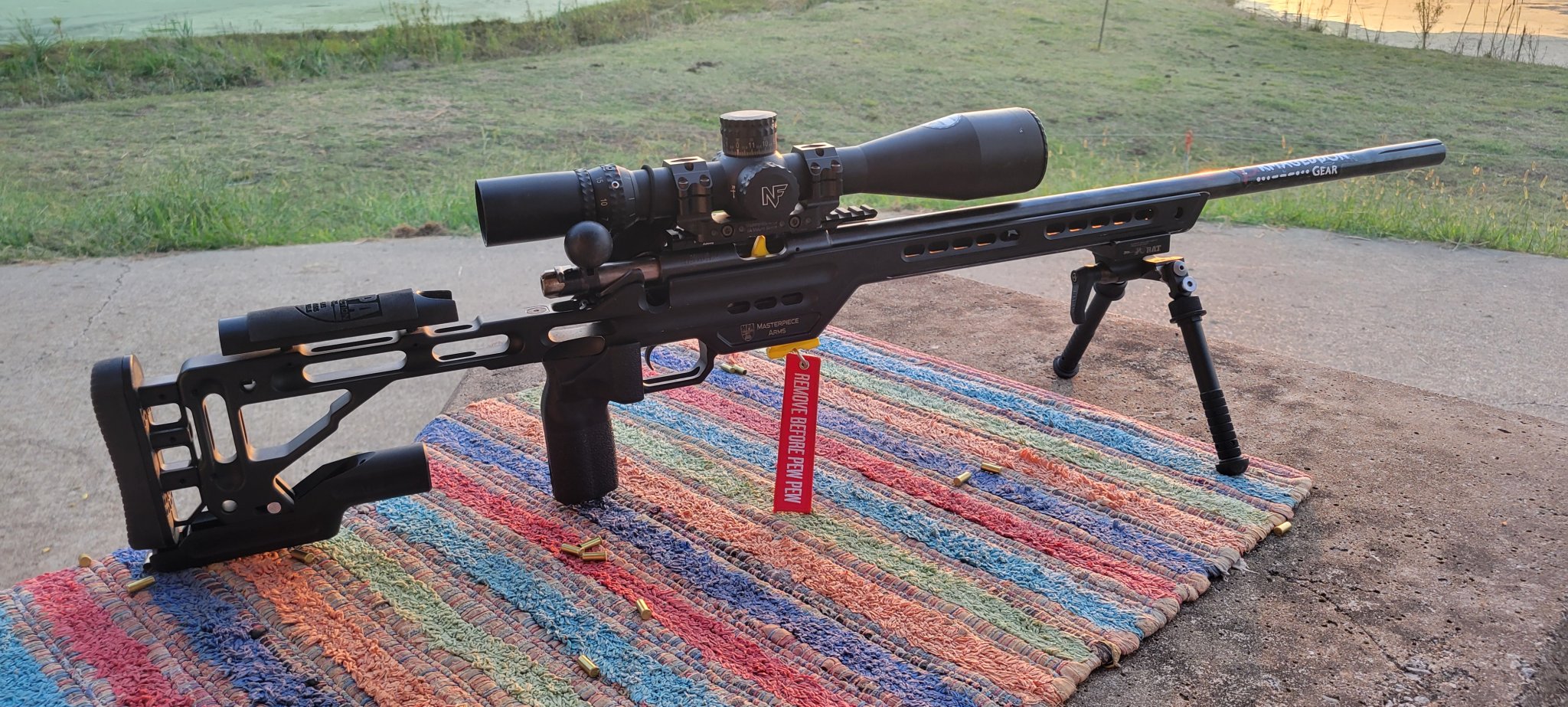

How about a photo of you rig?
