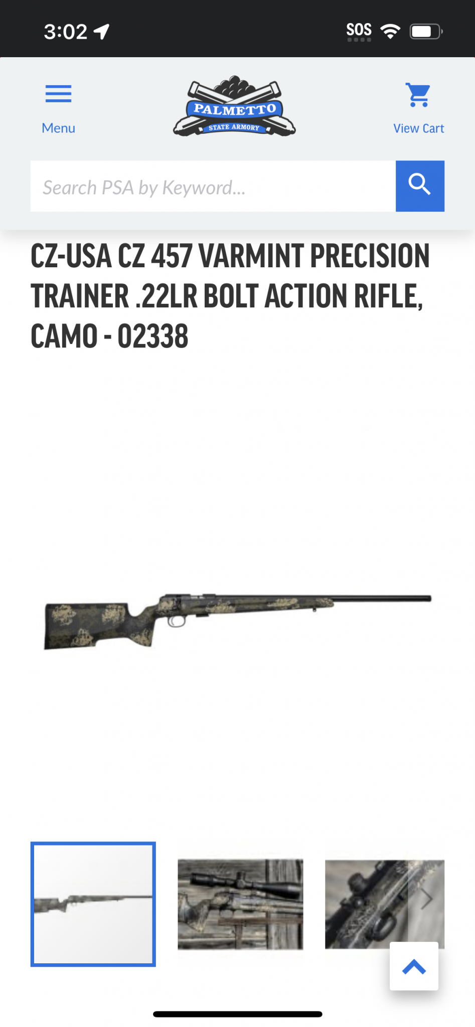

So I have been debating what type of target shooting I can afford to do on a limited budget. I want to get into practicing every weekend with my little nephew, and teach him firearms safety and a passion he can enjoy for a lifetime. I have no idea where to start, except regarding caliber, and distances. I need help with the following; rifle make, model , features needed, price range to expect, semiautomatic or bolt action(Ruger 10/22 vs CZ 457 MTR), build or buy, what can print the smallest groups, at what point does price dictate accuracy, can a $400 rifle be more accurate than I am and should shoot up to a higher dollar setup, at what point would price be only adding features and not accuracy, what barrel lengths are best for range, velocity and accuracy, is the $2,000 Bushnell XRS 4.5–30xs 50mm scope with G2 reticle a good choice for plinking, is a 22 LR rifle like a factory Remington 700 in which I can buy a base model and upgrade the barrel plus blueprint to achieve the precision of a much more expensive setup(like putting a Krieger barrel on a Ruger Precision rifle), accessories needed like a range finder and what is used for long range/caliber shooting, ammunition preferences like CCI green tag, if a suppressor is worth having for a 22 caliber, and anything recommended? I love the “Know your limits “ competition. It would be for that and bullseye competition. I would not be running around trying to be Keanu Reeves. Basically is there a formula or guidelines for shooting rim fire rifles in competitions? And if being an expert in 22LR shooting translates over to big bore long range precision shooting? Any help is greatly appreciated.

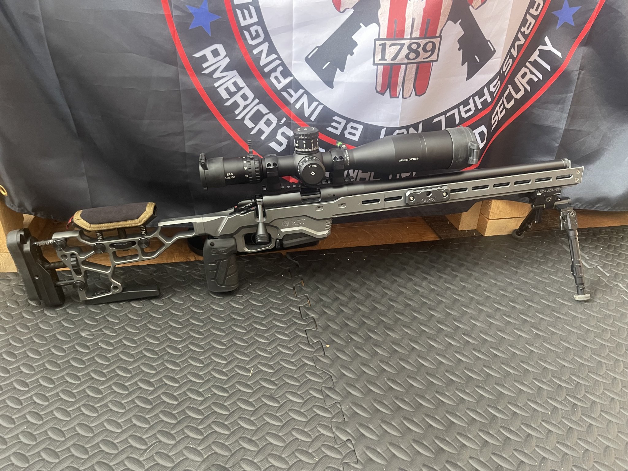

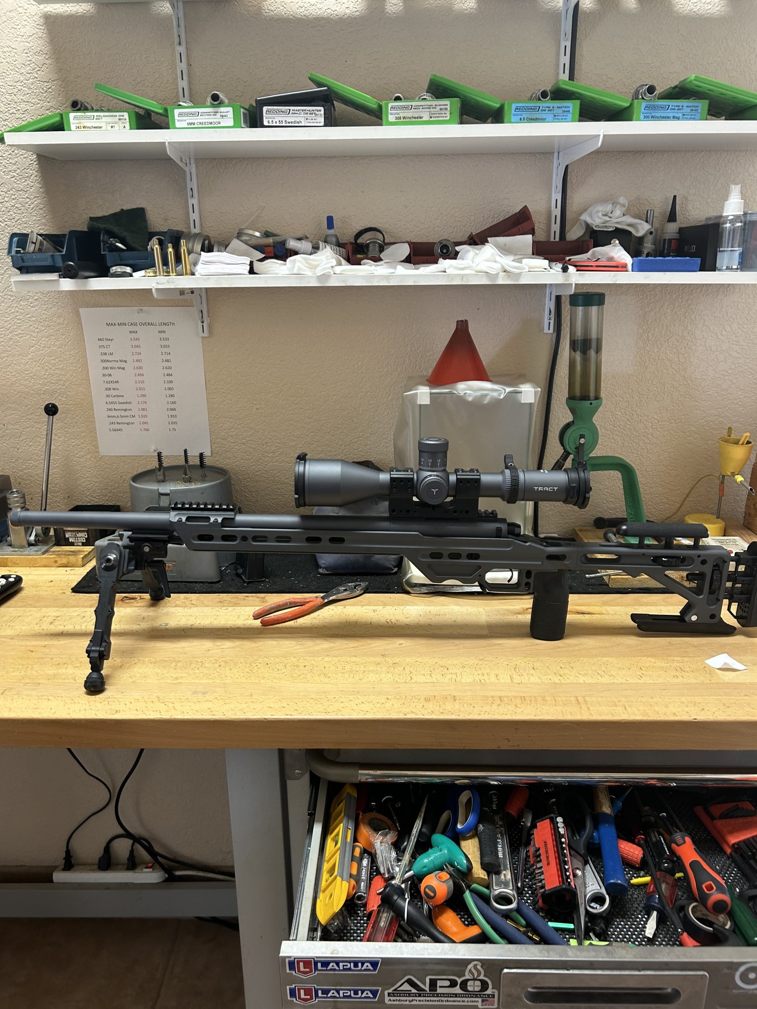

I just went down the 22lr rabbit hole and this is my set up. I went all out and i am into is about $5200 and it shoots awesome.
Vudoo with 22in MTU barrel
MPA chassis
Tract Toric 4.5-30x56
sphur mount
Accu-Tac WB-5 bipod
Ammo Lapua Long Rang shoots best in my rifle followed by RWS100 then RWS 50.
If I had a lower budget I would go the CZ 457 with the heavy barrel I think it's a 22in and get the area 419 scope mount. I would still use the same scope, scope mount and bipod. You can shave about 2k off what I spent.
There is always the Ruger Precision Rifle and put a new match barrel on it.
Good luck

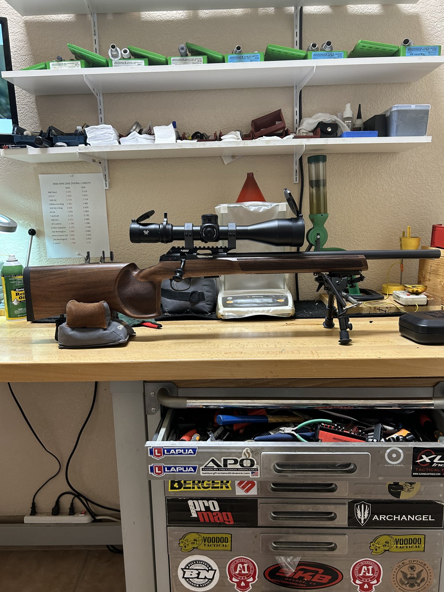

I also went down that rabit hole. I boughtCZ 457 Varmint MTR almost two years ago and have fired over 1600 rounds through it. However, I changed the MTR stock to a PDC Custom G5C Chassis, Timney Trigger (8oz) with the Area 419 30MOA Base. And changed the barrel out to a .900 21. Lilja Barrel. Reason: the MTR stock was great, however, it was condusive to the type of shooting I wanted to do (NRL22 Matches). 2nd CZ went with the CZ457 Pro Varmint and again changed to a chassis (XLR) and changed barrel out to the Lilja 18” Barrel, along with all the other stuff. The CZ 457 Pro Varmint is a good start and easy to upgrade. Started with an ARKEN Optics scope which worked well.

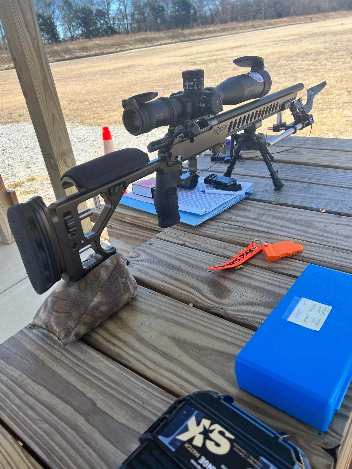

Just finished a B14R in MDT ACC chassis. I’ve been down the information rabbit hole on this recently so I’ll help where I can
Avoid the Ruger. There’s better out there. Without going to rimx or Vudoo I’d suggest the following,
B14R - if you like R700 pattern rifles. 18” barrel. They are known to be a “poor man’s Vudoo”. They tend to shoot very well. Steel barrel or carbon. I’d suggest steel for better balance, reports of better accuracy and not effected with a suppressor like the thin/sleeved carbon models. The carbons can be very accurate as well though and save some weight. The B14R is compatible with any R700 trigger or chassis. So endless upgrades. If you don’t like it you can replace the B14R barreled action with a Vudoo or RimX in the future.
Tikka T1X- lighter option. 16.5 or 20” barrel. Known to be very accurate. Short bolt throw. One of the best factory single stage triggers. Somewhat of a plastic flimsy stock. But can accept stock pieces like grip/forend etc from the T3X model like the CTR stock.
CZ- known to shoot very well. Short bolt throw. Easy barrel swap if you want to upgrade to something like a Lilja down the road. Factory flavors of about 15 choices and price points.
If I was on a budget it start with a T1X or CZ. You don’t need a $2k optic. Something like a Arken EP5 works well and are very common. ($600 with accessories from Arken)
Of course the gun only shoot as good as the ammo. So budget that in and keep in mind it will effect performance. CCI SV may shoot very well or be a crap shoot. Others like eley, SK and Lapua will tend to shoot the best. But accuracy varies not only between brands but between the same ammo of different lot numbers.
For a touch more $ a B14R with Arken EP5/30 MOA rail is a good start
I’m working on a T1X currently and just finished this B14R. Waiting on TBAC takedown .22 and Griffin Optimus Micro for cans.
