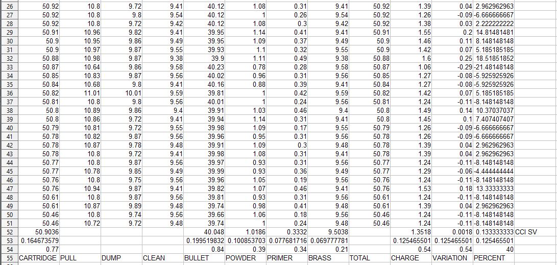

As I’ve said in the past, I’m a cheap ammo king. I’m sure I’ve given friends heart pains from some of the crap I’ve shot through my guns over the years. That said, I decided to conduct tests years ago with a selection of mid grade ammo. I sacrificed a 50 round box, disassembled each round and weighed the separate components.

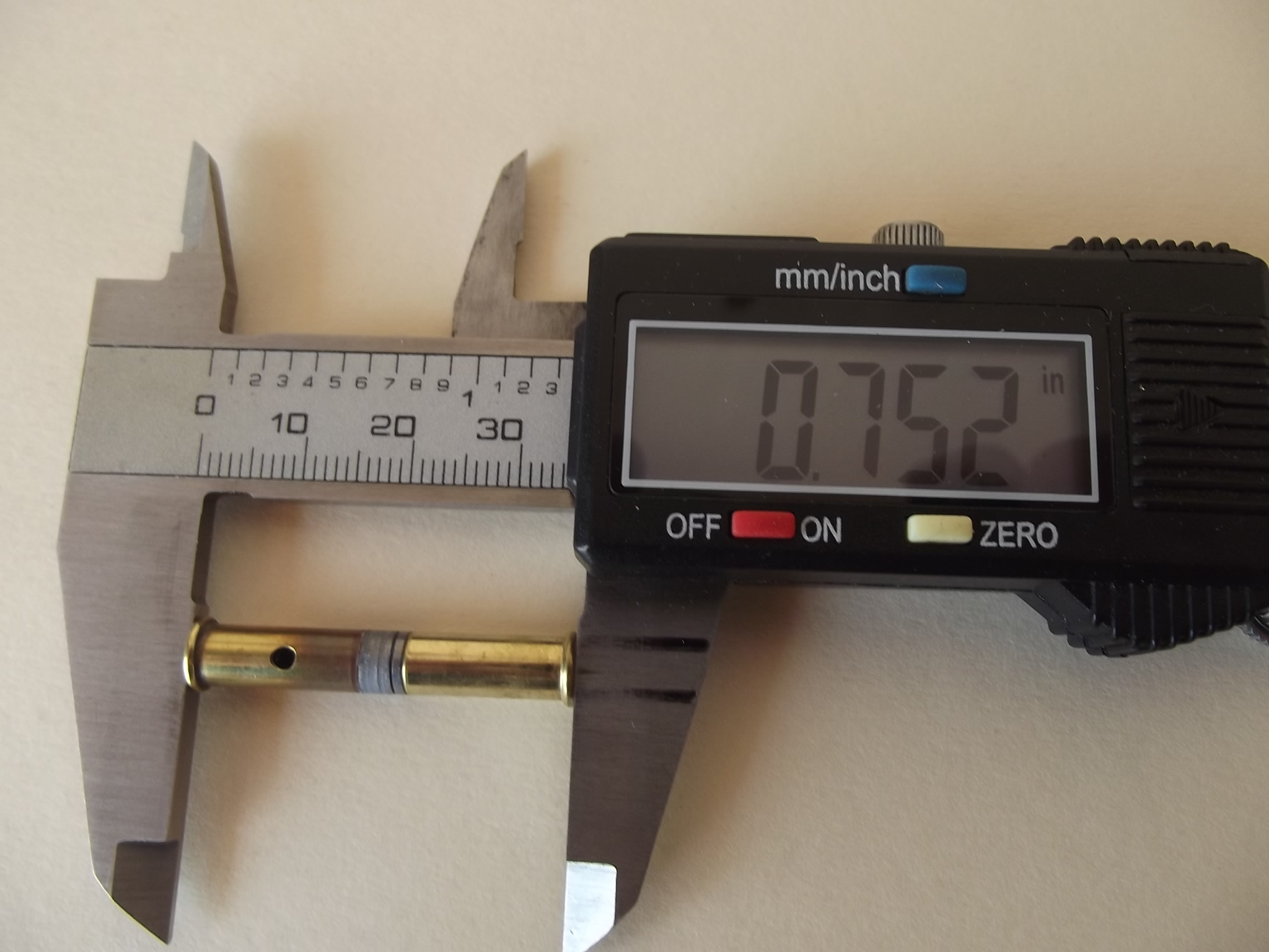

I used digital calipers with a home made sleeve I dropped rounds in for rim thickness. Please note it only measured the thickest portion of the rim, and said rounds were not “clocked” in the chamber.
I would like (at some point) to sort/test for length based on measuring from ogive to rim base.

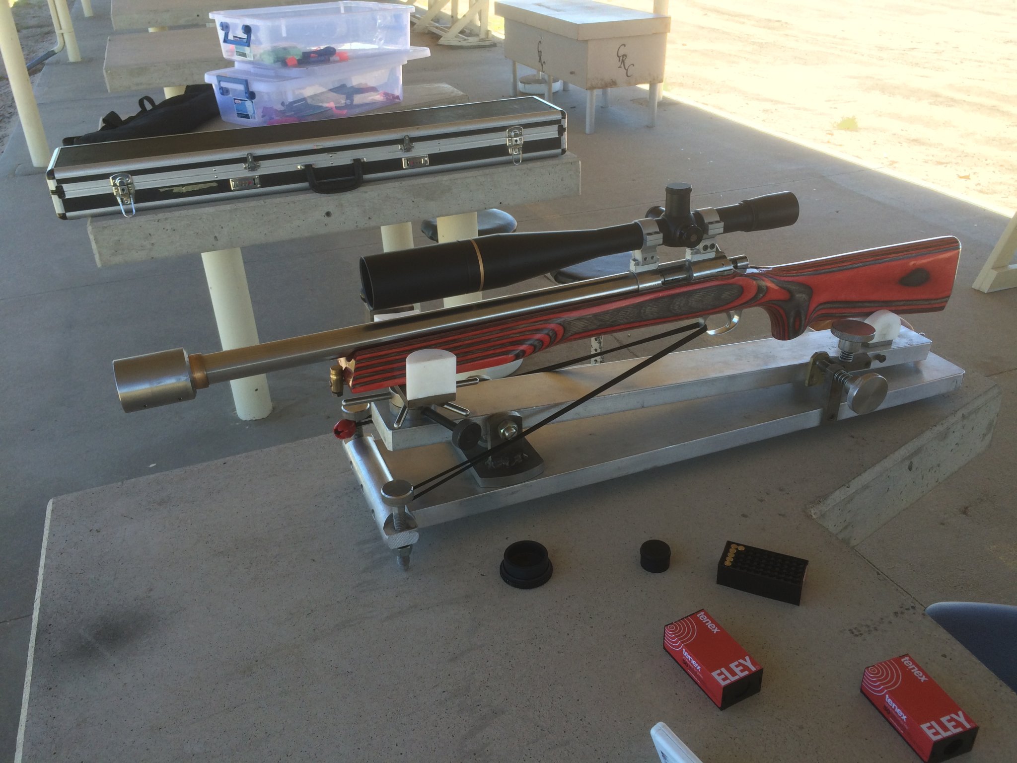

Not much benefit to a tuner once the barrel diameter gets to an inch or above. You'll never see a serious bench rest competitor using one of the truck axle barrels designed for prs.
Tell that to this ARA competitor. He won a fair amount of wins and outscored me all the time.
