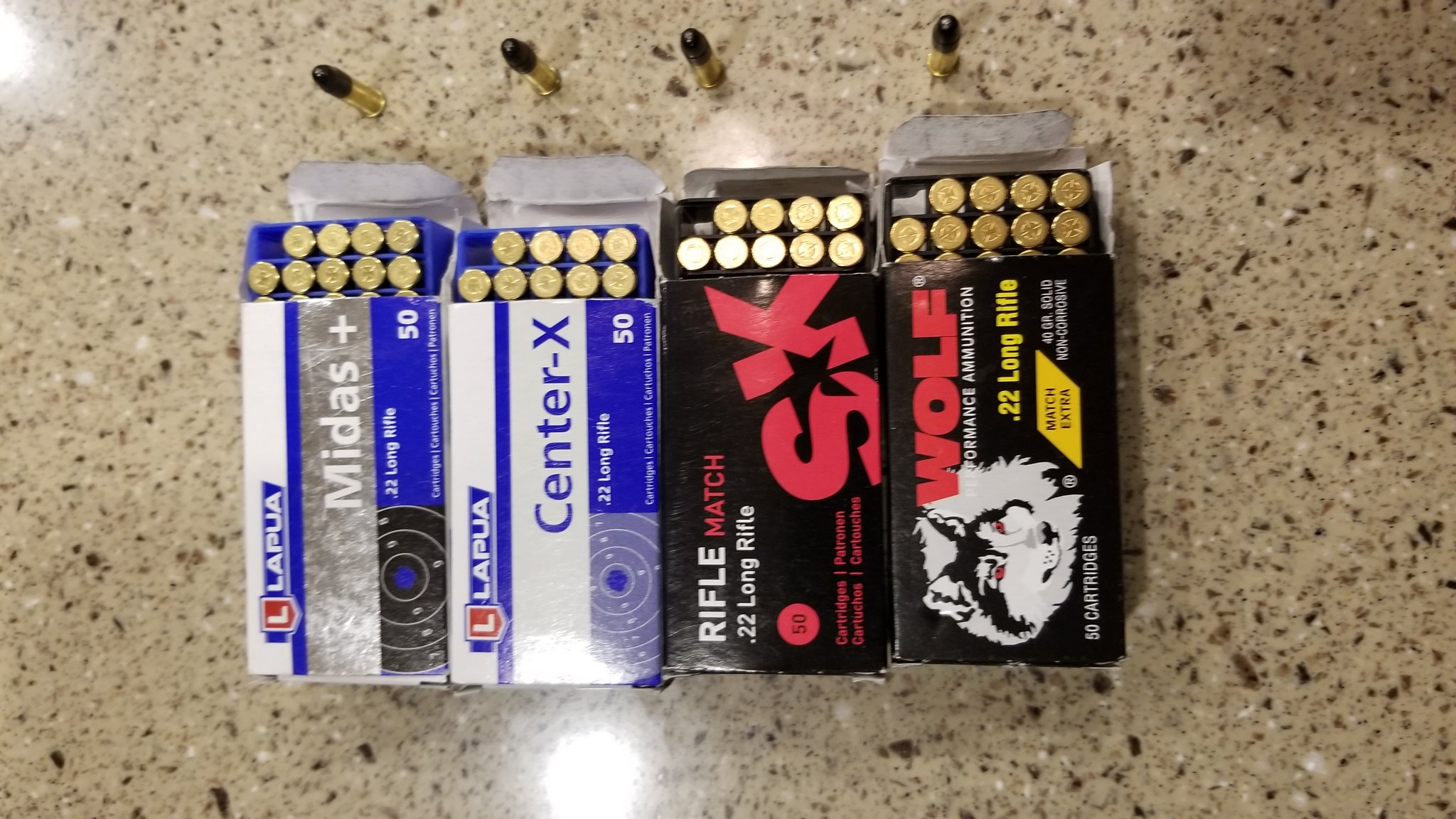

22 match ammo. Is lapua. Wolf and sk made at the same place. Pics below
Axel314
Feb 18, 2017
938
178
Indiana
All of these have same head stamp and appear to b the same bullet. . Does any body no if they r all the same and just paying more for the lapua brand or is it held to a higher quality control.
Read a post recently that stated yes they are all made on the same line. Certain lines like SK Standard Plus is ammo that does pass as Midas and Rifle Match is CenterX that doesnt pass, etc...
They are lot tested for accuracy and consistency, and potentially have different powder, etc. The Lapua stuff generally outshoots Wolf and SK and has less fliers.
There is a direct correlation in the more expensive ammo and it being more consistent. When ever I chrono lots of ammo, the higher priced will always have a lower SD. The CenterX has always been my go to for price pt and performance even tho the Rifle Match is a close second. The Tenex shot very well as well but for 99% of my shooting, its not worth the $5 premium over centerX.
That DOESNT mean that the more expensive ammo will shoot better in your particular rifle. Rimfires are so finicky sometimes. I had a lot of $3 box Win ammo that shot one hole. So weird and obviously an anomaly...
Try them all and see which shoots best.

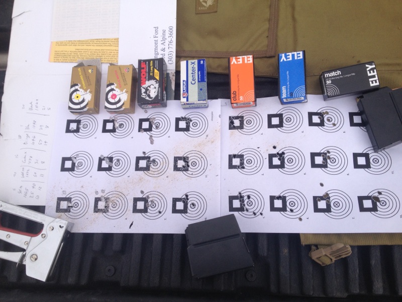

Old pic, and I think it was cold that day and the wax was gumming up, but that lot of CenterX won the day...

Welcome to the nether world that is 22lr. I saw the same thing a year ago and had the same questions. From the reading I've done I've concluded that the Lapua, SK and Wolf 22lr ammo is all made in the same facility. The Lapua is made on a separate line from the SK and Wolf. After the ammunition is produced they do batch testing using their own proprietary criteria and established standards. The results of their testing determines which packaging it gets and therefore pricing.
There is speculation that the SK Rifle Match and Wolf Match Extra use the same standards. You will also see that the lower grade ammo of the SK line has the same head stamps. The pistols types of ammo are different and have different velocities. All 3 lines of rifle ammo show either 1050fps or 1073fps depending on where you get the information.
Right or wrong that is what I'm running with after sorting through the maze that is known as the World Wide Web.

X-Act, Midas+ and CenterX all are made on the same Lapua machines.
Statistical sampling and testing determine the labeling.
SK is a Lapua product. Wolf used to be.
Recently I read that it is now being manufactured by Eley.
Remembered where I read about the change...
Wolf manufactured by Eley
That is correct...Wolf is now being manufactured by Eley. I have some old and new and difference is negligible (MT Extra). I am trying the SK Rifle match this weekend for the first time to see how it works in my Annie.
