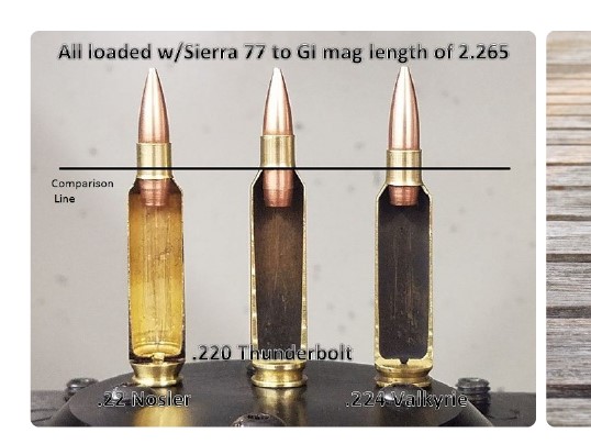

I have a 220 Thunderbolt. It's fairly similar to the 22 Nosler and 224 Valkyrie. (it has a 6.8/Valkyrie bolt head).
@padom did a lot of testing for the 220 Thunderbolt and he successfully used AICS style mags with BR spacer kits. Here's a link to the thread.
I have two AICS 5-round mags with BR spacer kits that allow me to load 88gr ELD-M out long. I had to play with the feed lip spacing, but they work really well now. I also have two plastic MDT mags that were modified by C&H Precision and they work really well also. When MDT released their Valkyrie mags C&H stopped offering these modified mags (as an FYI).
Good luck
Ross
