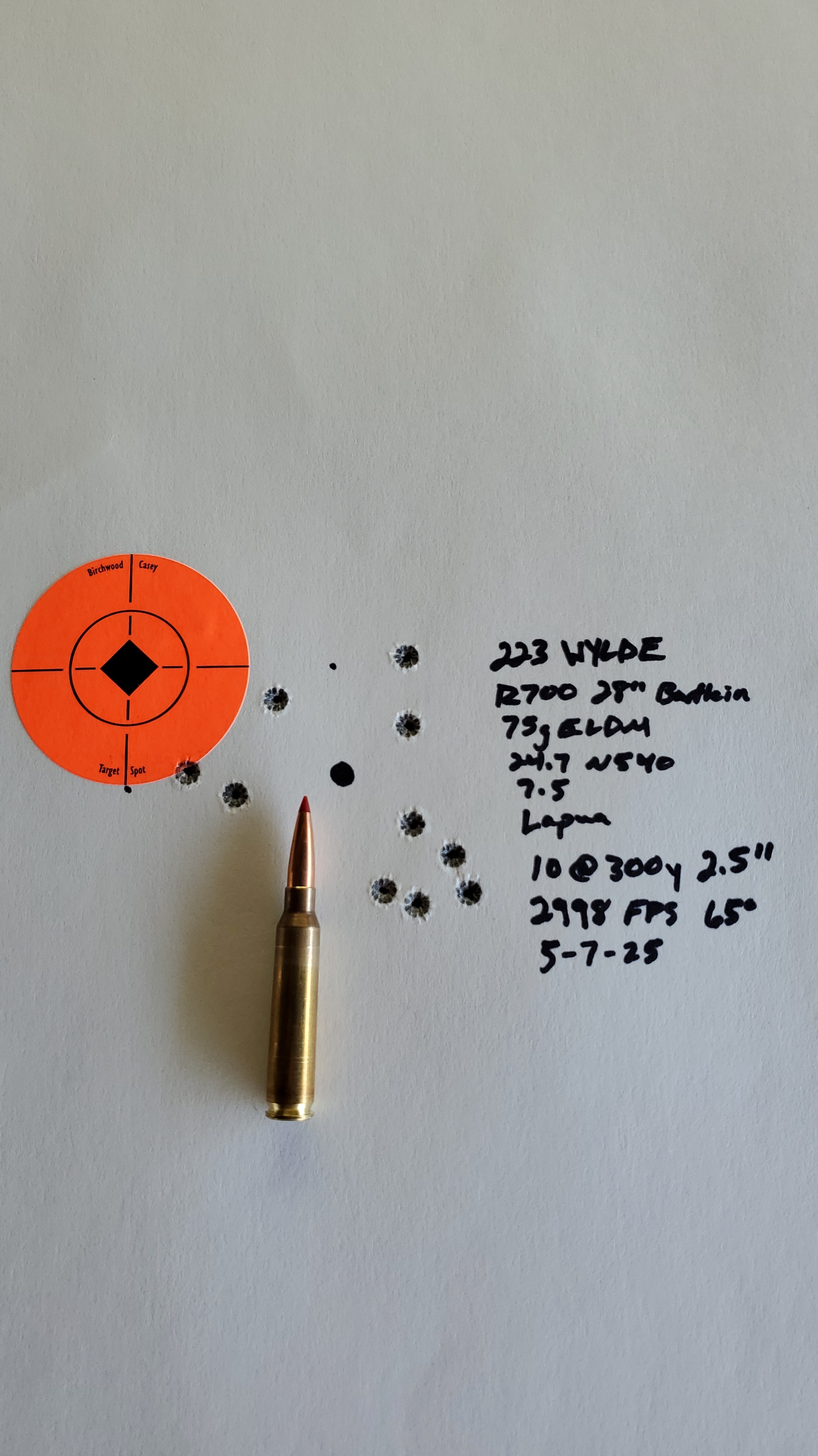

Went shooting earlier today and took my R700 223 Wylde with a 28" Bartlein 8 twist shooting 75g ELDMs at 3000fps with 24.7gn N540 in Lapua brass and Rem 7.5 primers at .025" off. I wanted to see what a 10 shot group off the bench would look like. About 70 degrees, 1-2 mph winds, little bit of mirage, but not bad. The result was approximately a 2.5" group. Now if I was to cherry pick, I'd say the 5 shot cluster was from 1 group, and the other 5 were from another, but that's not how it went haha. With that said, how happy would you be if this was your rifle? Would you try to further improve on this, or just load them all up and just shoot? I definitely feel the rifle is capable of more, whether it be a different bullet or powder, maybe tune the current load as the numbers on the Garmin aren't to promising with the ES/SD. I also put the last 5 rounds on a 2/3 ISPC target into approx 3" at 500 yards to end the day.

I feel the same, just not sure if you can expect that with 10 shot groups across the board? It will do 1/2 MOA for 3 and 5 shot groups, but this was the first time I did a 10. Its a HV contour and rifle weighs like 16# or so. It's mainly just a coyote and LR steel plinker out to 1K. I've pretty much done everything with this particular rifle/bullet/powder/seating depth combo. Tried 5 powders and did ladders at 300 yards to start off with the 75g ELDMs, IMR8208XBR, Benchmark, IMR4895, H4895, and N540. H4895 and N540 were the 2 best, but i only have 1# of H4895 left and cant find it locally anymore, so went the N540 route and bought 8# keg of it. I worked up the N540 in .1g increments, did seating depth test from lands to 40 off in .005" increments. Not sure what else to do with it at this point. It's dang close to being 3/4 MOA for 10 shots at 300, so it's not horrible, but I think the rifle is capable of 1.5" or 1/2 MOA with the right bullet/powder. These 75g ELDMs have always been pretty picky in this rifle. I haven't tried any other bullets as I just had planned on and intended these to shoot really well, so I bought 15 boxes to start with. I did however just buy 1 box of 80.5g Bergers just to see how much better they'd be over the Hornadys. Not a BR rifle by any means, but always like to try and wring out the best of things.

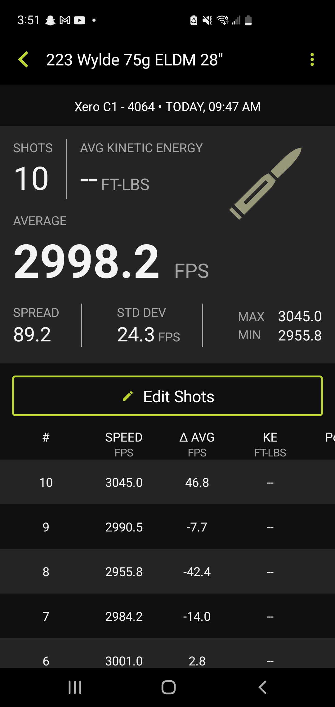

I agree. I have read some where the 223 is pretty hard to get low ES/SD numbers, but this is trash, doesn't shoot bad though.
It's 1x fired lapua brass, FL sized with a Redding bushing die, .002" bump and .002" neck tension. Powder was weighed individually with an RCBS balance beam scale. Bullets were seated with a Forster micrometer ultra seater with a +/- .001" CBTO.
Any recommendations?

Did you use a mandrel after FL sizing? If not, I recommend doing so (remove your expander ball). Then, use dry graphite neck lube or NeoLube #2 to uniform the seating force.
Lastly, though it won't do much on the second firing, going forward, look at annealing your brass.
The group size is pretty good, but as you stretch out your distance, the big SD will really come into play.
If you haven't watched this video, I recommend doing so. It brings to light the impact of SDs at range and what using a mandrel and neck lube can do for you.
The accuracy is perfectly acceptable. The ES and SD would be a concern of mine for sure. At about 6-700 yards that is going to become extremely noticeable. Obviously up close it matters much less.
I think a good question to ask yourself, is do you want to invest the time to go down this rabbit hole? If not, keep up what you're doing but understand that the further out you go the worse it is going to get until you control the ES and SD. Surprisingly, the .223 is one of the more difficult cartridges to reign in (for me).

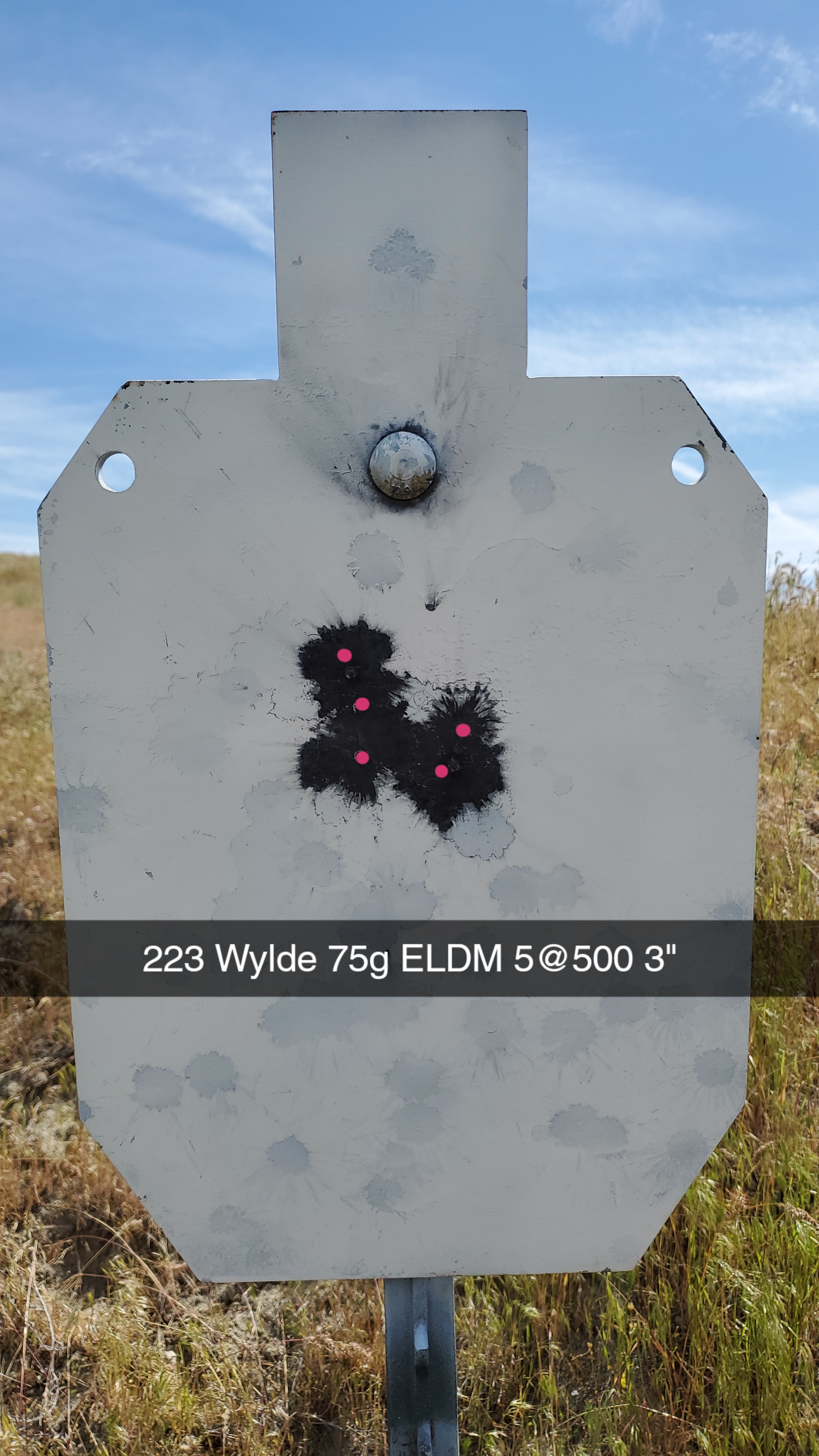

I'll try and tweak a thing or two here with it over time I'm sure, see if I can get it down to 1.5-2" mark for 10 shots at 300. But as it is, I think it should work ok for coyotes, and steel out to a solid 800 yards.

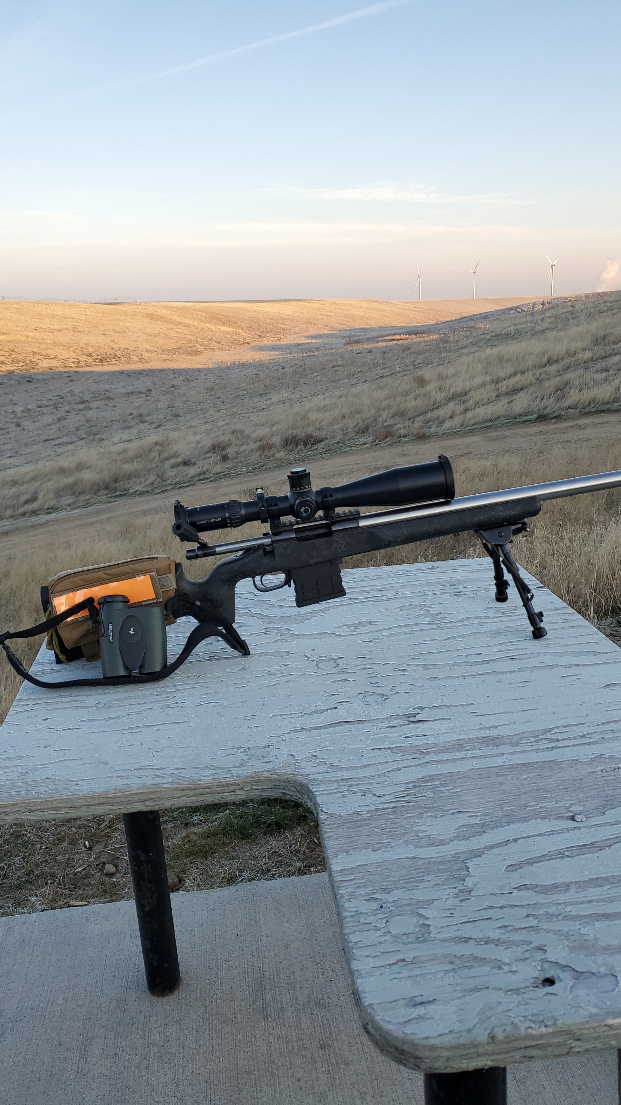

It's not a bad rig. I tried to have it built as a 1K trainer based off my 6CM and 7-300 builds. They both wear A5s and 27-28" heavy barrels w/brakes and weigh 16-17# This 223 has a S&B PMII 12-50x56 on it.

About what my 700 Varmint (stock barrel) will do with 53 SMK. I tend to agree with @RegionRat that the 77 SMK is probably worth a try. Your ES can be responsible for about 1.2" vertical at 300yds so it may well be the issue here. N540 may be part of the issue. It's a double based powder and the single based powders typically are better for consistency. Other issueis are probably related to case prep.

Change powder. N540 is a double based and more temp sensitive and less consistent than N140.
Especially if you have a long barrel might as well use varget and N140.
I keep my N540 for my hunting 223 because it yields a bit more speed but it’s not temp stable and you can see the velocity rising if you do long shooting strings on hot days.
