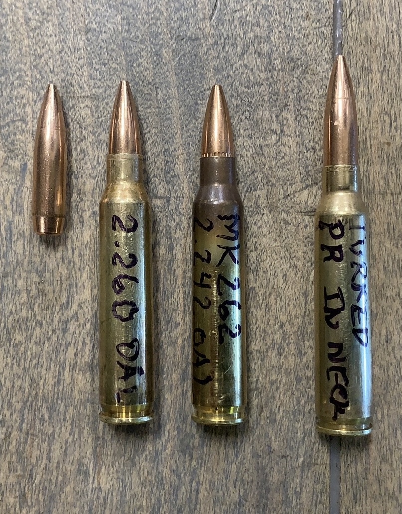

I am trying to wrap my head around your issue. Are you saying that at 2.260 your bullet just falls into the case or under pressure?
A sierra 77 isn't going to be any different. I shoot both and have never had this issue.

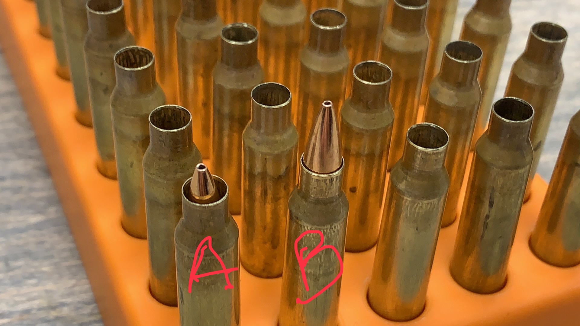

Thank you for supporting me. Yup, basically, at 2.260, meaning the pressure ring near the boat tail has been pushed past the neck and with rather little effort I can push the bullet into the case or if I chamber the round the bullet slides forward from the momentum.
I’m getting ready to buy a box of 77 grain SMK‘s with hope that they fix the problem.
Can you please watch this brief video I uploaded to YouTube and let me know if you have the same issue with your Berger and SMK‘s? Effectively it is showing how the boat tail of the bullet is wider than the Bering surface. I’m rather confident this is what’s causing my problem though mathematically it doesn’t make sense it’s only .001.
My next step is to get some 77 gr SMKs and see what happens.
I get good results with my Daniel Defense MK12 and Sierra Matchkings. I have also tried ultrasonic cleaning and have noticed increased unequal resistance seating bullets with the squeaky clean necks. Yesterday I tried shooting reloaded cartridges with case necks dipped in moly and case necks that were not. I was surprised the cases that were not dipped in moly grouped better than the cases that were. The velocity spread was also tighter on the cartridges that were not dipped in moly.
BTW, the necks on these cases were turned to 0.011” with 0.0035” neck tension.

Personally I think you turned the necks to thin. I get very good neck tension at mag length seating I am reloading Remington brass and its not as thick as factory Lapua.
Take a few cases that have been fired, size them and seat a bullet. Don't use any that you have turned necks on your premed any other way.
I'm pretty sure this is the issue. He needs a smaller neck bushing.

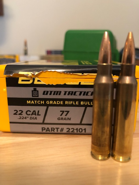

@spife7980 raises a really good point about amount of projectile bearing surface engaged in case neck @ThingsThatGoBang
Bear with me, I haven't used 77gn OTM so I'm using basic maths off .223 cartridge dimensions and Berger website
With the 77 OTM bullet OAL of 1.015 and Nose Length of 0.513, you may be seating bullets into neck even beyond bearing surface reducing bearing/neck contact.
My .223Rem load is COAL 2.25 using a little 55gn Sierra GameKing so the Berger 77OTM may be a fair bit longer in COAL you'd think than your stated 2.260"
My advice may be for nought if you want to use longer/heavier pills in .233 and AR. We aren't allowed anything that goes bang and is painted black here Down Under : )

I must have missed it. But seeing people mention that you turned the necks.
If so, that’s likely the issue. You can turn necks thin enough that they won’t be able to hold a bullet enough that it won’t move with force if your tapping or a bolt carrier slamming forward.

I spoke with Berger bullets a second time today just to verify that I am using the correct bullet and I was assured 100% that the bullet box shown early on in my post is indeed meant for AR15 magazine fed applications. It’s a mystery, and yet one more reason on my list of reasons why I drink. :).
It does make sense if there isnt enough springback on the annealed neck. The pressure ring opens up the neck and once it goes beyond the neck/shoulder junction there isnt enough neck tension to retain the bullet.
IMO, this is the explanation..

Switching to Sierra 77MK‘s fixed the problem, and also got the Redding bushing small base sizing die with .243 and .244 bushings. Same .005 neck tension as before but now the bullet isn’t slipping. But to answer your question, my friend shoots F class and he’s much more experienced than I am. He annealed the brass, and the analyzer code is 0125 or 0126 depending on the couple Lake City he analyzed. He actually analyzed and annealed nine different manufacturers of brass that I will someday load and Labradar to see how different brass affects consistency. Yes I am using mixed years of Lake City. 13 through 21 is in the collection to pick from.

Went shopping today, the Sierra 77 MKs resolved the issue, I also got a Redding bushing die which seems to be superior to the Forster die I started with, and they had Hodgdon Varget in stock so it all worked out for the best. I still have .005 neck tension just like at the very beginning of all of this but the bullet is not slipping like it did with the Berger 77.
If hes applying .005“ of neck tension and the bullet is not being retained then another sizing die wont help.
So the issue is resolved. I got Sierra 77 Matchking’s. I also got the Redding small base full length sizing die. My neck tension is still .005 but that bullet is not going anywhere except out the end of the barrel. Success!
Using the Redding die with the berger bullets still yields the same problem that once that pressure ring gets past the neck it is slips in the brass.
