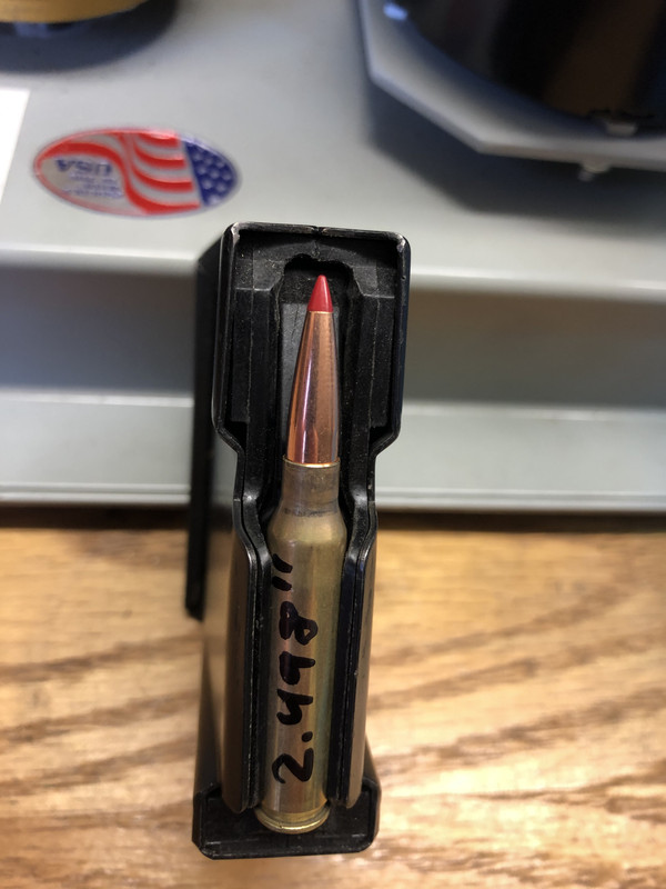

    Does anyone have any info on 223AI with max length throat to run in modded AICS mags ?
    i want to run either 80.5 or 85.5 Berger’s
    already know I’m running 223AI, 26” barrel, Accurate Mags notched in the to take longer throated 223. Still on the fence of throating, and how much.
    .223AI
    I fire formed with 88’s and 24 gr of Lever at 2,600 fps in Rem cases.
    Switched to 75’s in formed brass with 27.6 gr Lever running 3,080 fps in a 21” Bart.
    Throat for 75 eld @ 2.435” - 2.455” and you’ll be golden.
    Both my 223 AI's are short throated unfortunately, but this will change on the next go round. Probably shoot 75/77/80's. Currently one is a 12 twist so I'm limited to about 60ish grain bullets in that one.
    Reactions: trophyhunter
    Current 223 that’s being rechambered into 223AI is 7 twist, it shoots great now. But I’m almost done testing the Accuracy International 223 conversion so it’s time to play a little now.
    I shoot .223 coal 2.5" with unmodified AI mags. This is not Ackly Improved. I throw 80 grain amax at 2850 fps through 1 in 7 barrel. Does great to 1200 meters maybe further but that was all the room I had that day.
