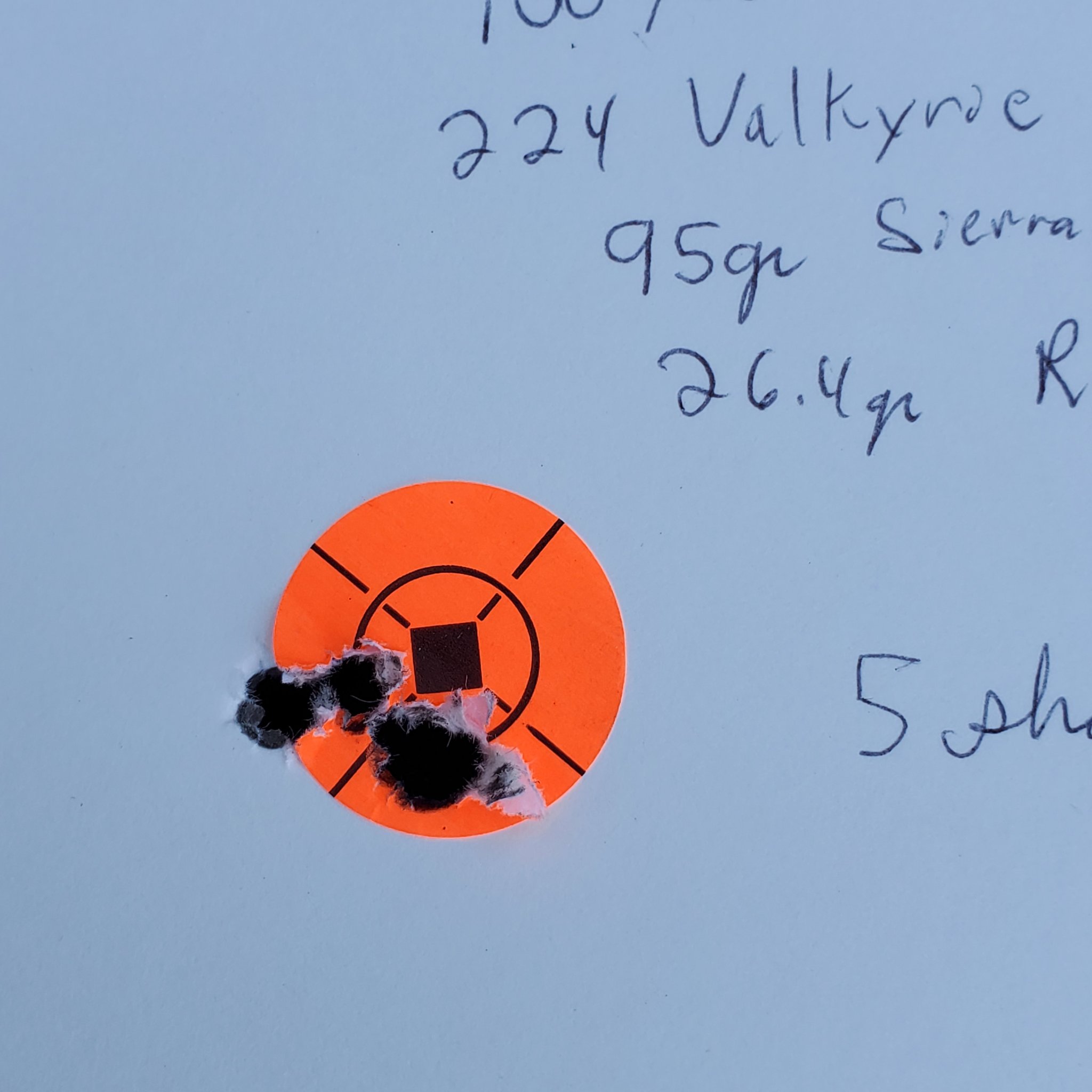

I went with the Bison Armory 24" 6.5 twist on 224 Valkyrie... first barrel was a Ballistics Advantage barrel 2 to 2.5 inches for 5 shots.
I went with 95 gr SMK, and 80, 88 gr ELDM, mostly. RL 17 was a good powder in mine at the time...fast and accurate.
The 224 Valkyrie was a bit more difficult to get to shoot. Took it apart a few times, then centered the bolt carrier with really helped with this cartridge.
