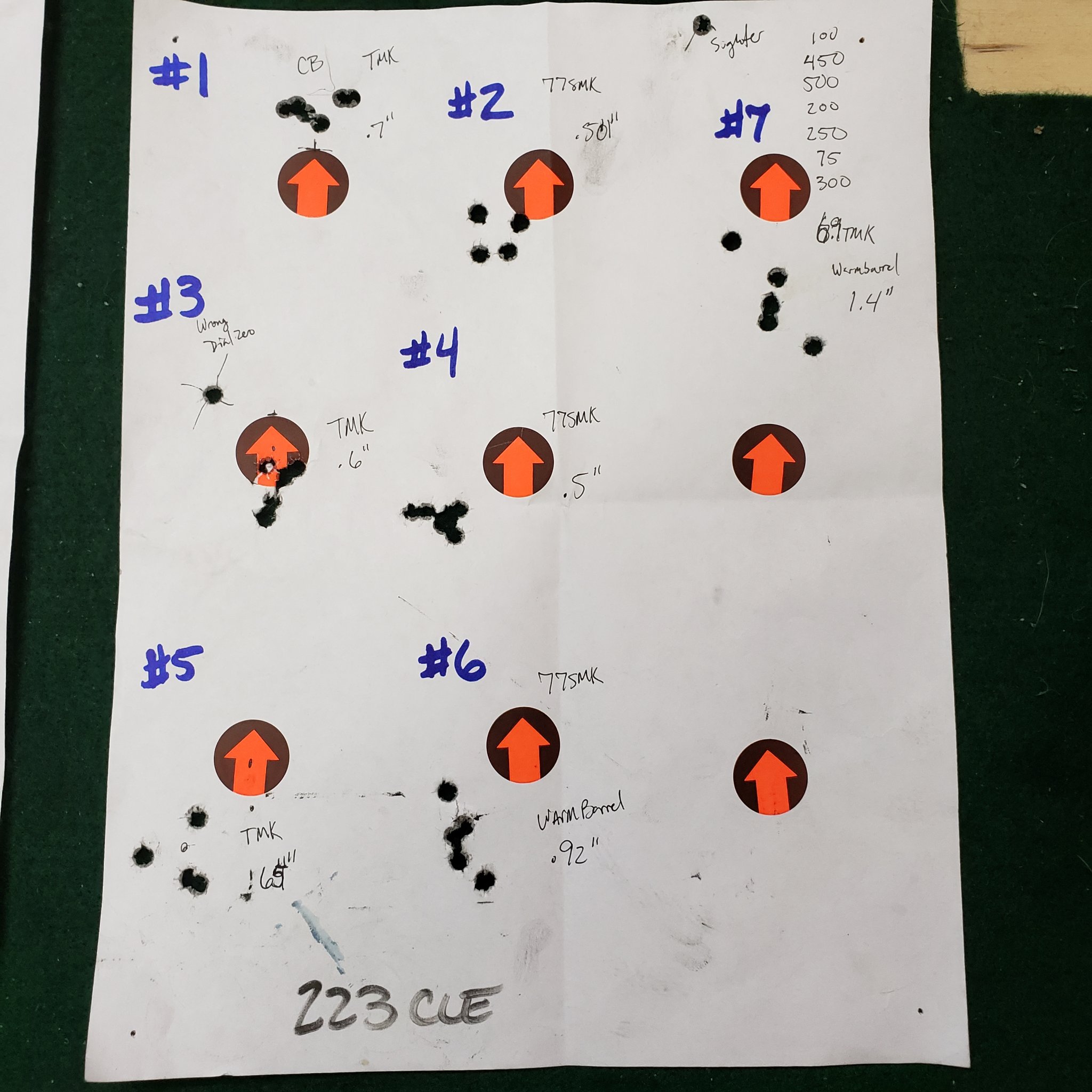

Perfect example: my 223 Kreiger AR15 just shot the following targets on two separate days:
Last Saturday, shot 1, 2, 3 etc with 69TMK first then 77 SMK and repeat with 5-10 min between groups.
Sunday same weather, fired in sequence shown 1,2,3 etc but shot 77 SMK load first, followed by 69 TMK. 5-10 min between groups.
69 TMK shot two .65" groups but also a 1.4" groups; overall average of .877" for 8 groups.
77 SMK shot best of .5" but shot a .92"; overall average of .696". Notice it shot a 10 shot group of .59" on Day 2 group #5... This is statistically much better than average and stars aligned.
This is pretty much what I see with my 224V gas gun too. .6-.9 with occasional 1.2-1.5" every so often. That never happens with my bolt guns. I'm certain it's something to do with semis just being hard to shoot and even harder on build quality because of stacking tolerances.
Will be cool to test though!

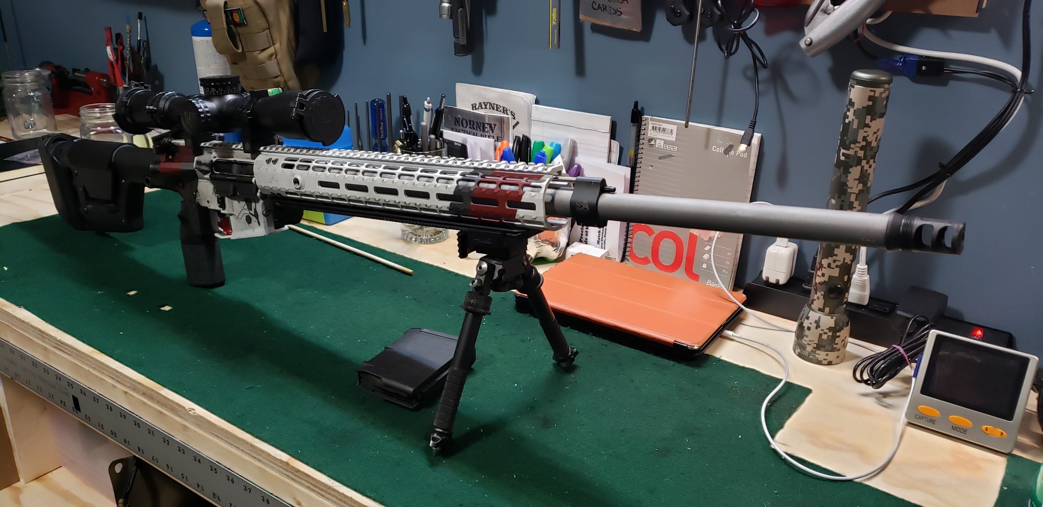

Update: new barrel 26" +3 gas barrel installed, brake time and ready to hit the range. Some subjective and objective points.
  • The old barrel was 3.6lbs, this one is 5lbs but it's very difficult to feel the extra weight on the rifle.
  • I'm very surprised at how much stiffer it feels being non-Fluted compared to the same barrel fluted. There is an easily noticeable reduction in ability to deflect the barrel by hand.
  • Balance: I went with non-fluted to move balance point slightly further forward. Old barrel balanced exactly in from of mag well, which was good before I put on the Arcalock. However, with new barrel, it's about 1-2" forward of mag well, right at beginning of the Arcalock rail. Dead nuts spot on where I wanted it.
Excited to get some rounds through it soon; may be a week or two though due to travel, work and match schedule.
New balance point:
