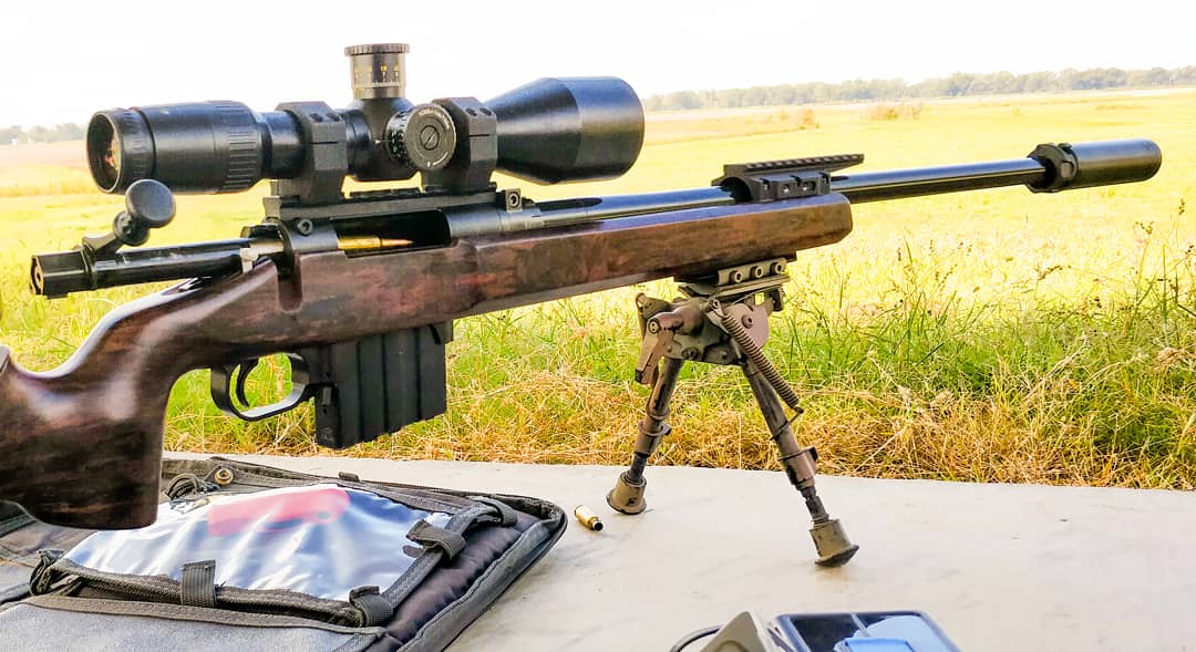

I've been running long 88eld/90smk rounds out of both an Origin and TL3 with MDT's 224V polymer mags without a single issue for what a year now. Feeda like butter 100%.
1 problem. They only hold 8rd... not an issue for me but probably is for some... they are MDT's 223 polymer mags CNC machined for 224V specifically....when MDT sent me one to test before they were released they said they wanted to see the demand for them based off how well they sell. To make a new 224V dedicated mag they have about $50,000 in up front costs to do that.
I'll have to check and see if they sold like they were hoping and if a dedicated 223V larger capacity mag is now in the works since it's been a while.
I also have they 6BR metal mag that runs good and holds 13rd but needed some feed lip bending to hold the skinnier 224V case...

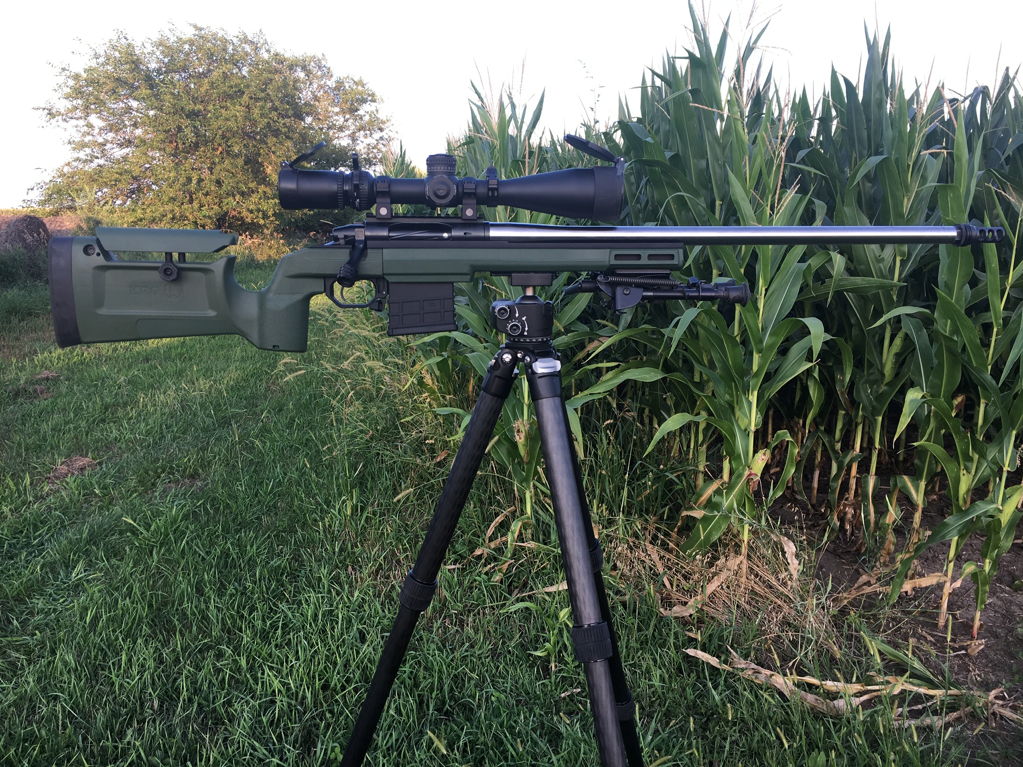

I ran the modified MDT 223 polymer from CHPWS and used the mag extensions from MK Machining to get the 10 rds. Only issue I had with feeding was if I had too much pressure on the the front of the mag. The rounds would be too low and miss the feed ramp. Ran that setup hard at a NRL match, only issue was the guy behind the gun.
I am tempted to cut the rifle down to 16”-18” and switch the scope out. Short truck gun
Reactions: stello1001
Can you link to the mag extension you have on this mag? Thx
