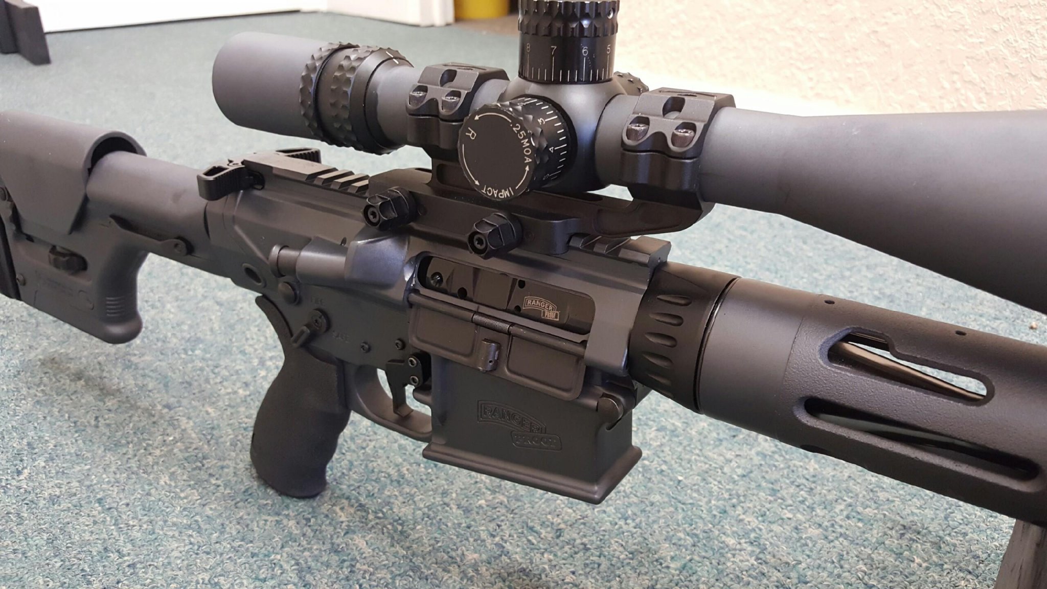

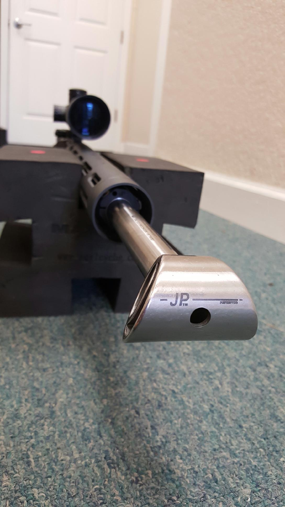

I did both, and went top quality for both and was. It disappointed. I ordered a LMT MLR when they opened up orders at SHOT show and ordered up a Craddock Precision Rock Creek barrel and built one around that while I waited for my LMT which was delivered in July.
Neither route disappointed and all said and done cost about the same. Both were right around $2K. The LMT was the least expensive at $1800 out the door from my dealer who I had ordered it and the only thing I changed was swap in a Geissele trigger and CH.
Both rifles shot and functioned exceptionally, but the Craddock really shined as you’d expect from a rifle with a $600 cut rifled barrel. It was by far the my accurate AR-15 I’ve ever owned or shot, benchrest level of accuracy. Unfortunately my rifle ADHD got the best of me and I preferred the LMT for its modularity being able to swap calibers and barrels in a couple minutes with only a preset torque wrench (included with rifle) so the Craddock upper got sold and the lower repurposed.
I know the LMT is double your budget but when you consider the fact you can pick up an enhanced 223 bolt and one of their SS cut rifled 223 barrels (Rock Creeks BTW) for about $700 and have two rifles in one it’s actually a great value. One rifle, one scope, etc. I do suggest paying the $75 upgrade to get the enhanced carrier on the rifle especially if you may be shooting suppressed. It changes the dwell time and also vents the gas out the side so you don’t get a blast back in the face.
You can’t go wrong building one either but a $1000 budget is going to severely limit the quality of the components which is going to directly effect the performance unless you just happen to get a unicorn barrel if you go for shelf grade stuff. I sold my Craddock barreled upper used for more than a grand and that was minus charging handle and muzzle device.

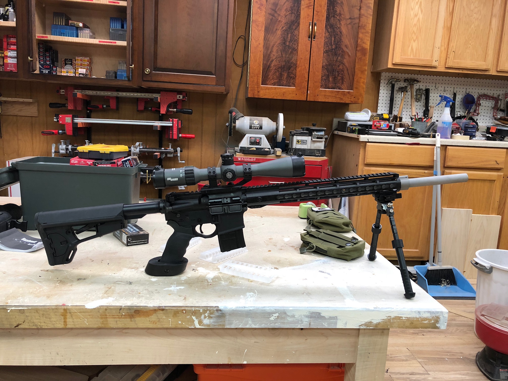

Loving my 22" Rainier Ultramatch 1:7.5 224V build. After doing load workup with 88 ELD-M and CFE223 its hammering. Confirmed my load out to 636yd yesterday on a gusty day.
22" Rainier Ultramatch 1:7.5 +2 Gas
Superlative Arms AGB
JP Headspaced Bolt
MEGA NiB Billet Upper/Lower Set
Geissele SD-E
BAD Ambi Safety
ERGO Tactical Deluxe
JP SCS
Magpul PRS Gen3
Seekins SP3R Handguard
Rugged 3 Port QD Brake
Athlon Ares ETR MIL
Seekins PMR Rings
