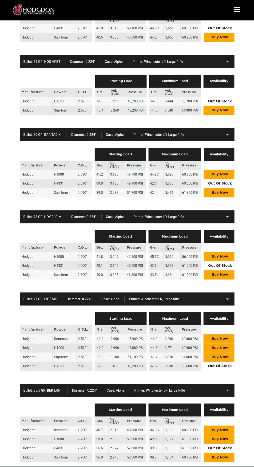

    Looks like all the hogdon load data for 22 cm is for slower powders than H4350 (ADI AR2209) especially for the heavies, can you get Retumbo(AR2225) or H1000 (AR2217) to try, I didn't check earlier as I assumed with a build like that you would be using a common load. I suspect you are two or three powders too fast to get the best from that catridge at spec pressure which would explain why you aren't seeing expected velocity without significant case expansion.
    Thank you for that chart. I have h1000 on hand, just would hate to use it for this caliber. Also have rl26 and n555 too. I will try the slower powders and see what happens. Thank you again!
