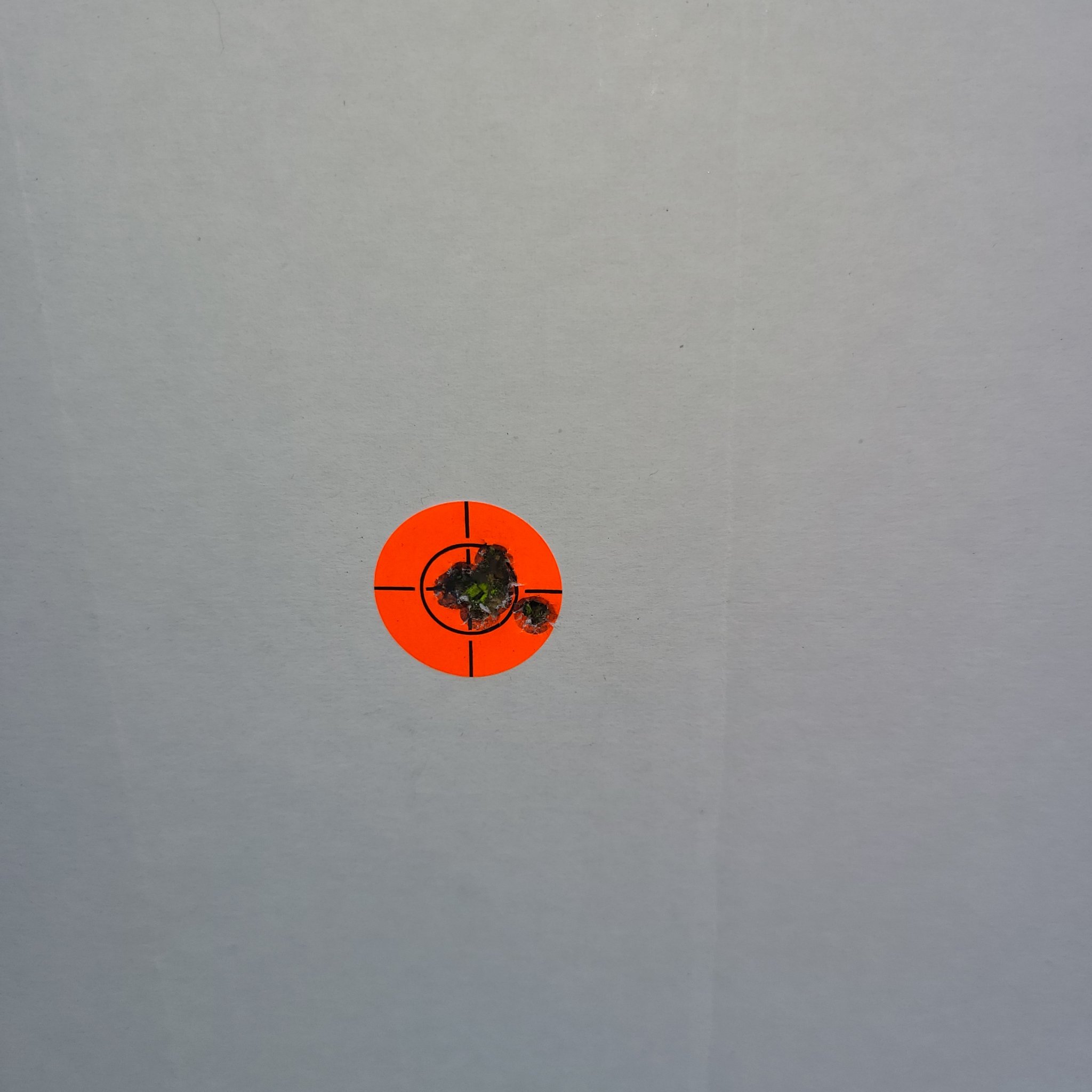

Zeroed the gun last fall at 50Y using the CCI Mini-Mag ammo and was very happy with ten round groups repeatedly punching a single jagged hole. Built a rack of NRL22 swingers from 1-1/2" down to 1/4" and could run the rack down to 1/2" every time, 1/4" was a sometimes.

I bought a brick of the super sonic SK Long Range Match. I am pretty darned impressed. These are the best groups I've seen out of SS .22 ammo. Not as good as SK Match subs, but not too far off. Thus far I only know of one place to get it, but if they can keep that level of precision it will probably give the sub sonic NRL market a run for the money. I did not change my scopes POI, because with only one source I'm not switching to it. Things are still not leveled out in the .22 ammo market. All the bullshit ammo is in abundance, but the good stuff is still in and out of stock. SK Match shoots better in my rifle than the TenX, which was surprising to me. I still have a lot of Ely, but I'm thinking I may be an SK guy now...

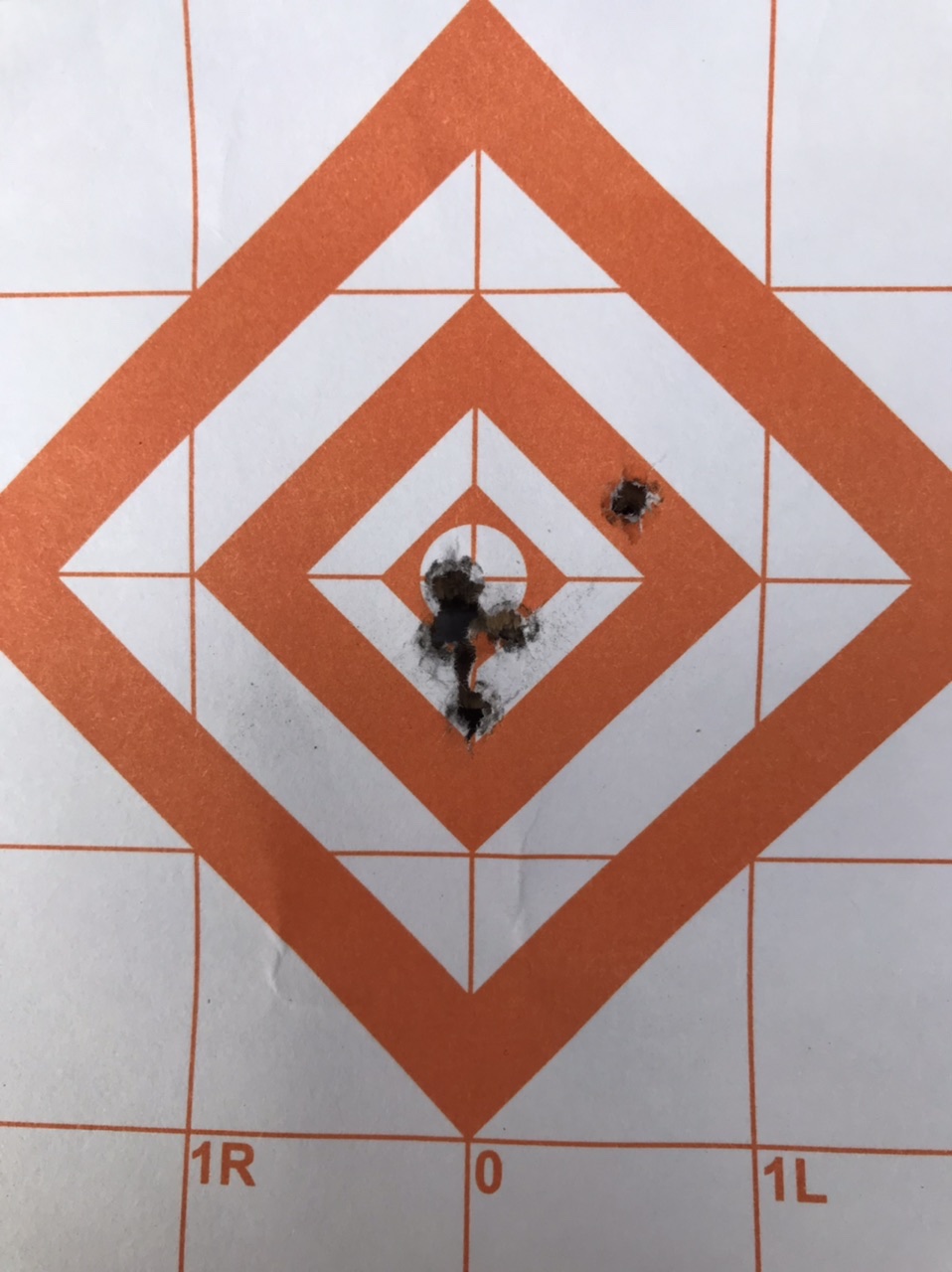

SK Long Range lot I have does much better than that in my Vudoo at 100. Why checking ammo in the rifle is important. Here’s the first shot out of a clean barrel at 2 o’clock and then 5 more in the center at 100.

Went through all the different ammo's listed above to narrow the list of what the rifle likes at 100 yards. Some it didn't like at all, few where OK. Had the best, most consistent results with Eley Target (yellow box). While at the range running my tests another shooter I know that is extremly serious with his NRL22 competition commented that he found it threw the results off a bit when switching between different manufacturers because of the coatings. Some are oil, some are paraffin. Noticed a difference on my fingers loading all the mags also. Bedause of the list of brands I was running groups of (10) and switching. After narrowing the choices down to three brands I ran all the test again running 4 to 5 groups of (10) same brand before switching. Did have more consistent results.
Attaching three of the test sheets I do while running my test. I don't mess with zero while doing test as a waste of time as each brand has a different PoI. Once I pick a load I tune the zero. I have other targets where I was getting better groups but don't have those assembled with the data sheets.
