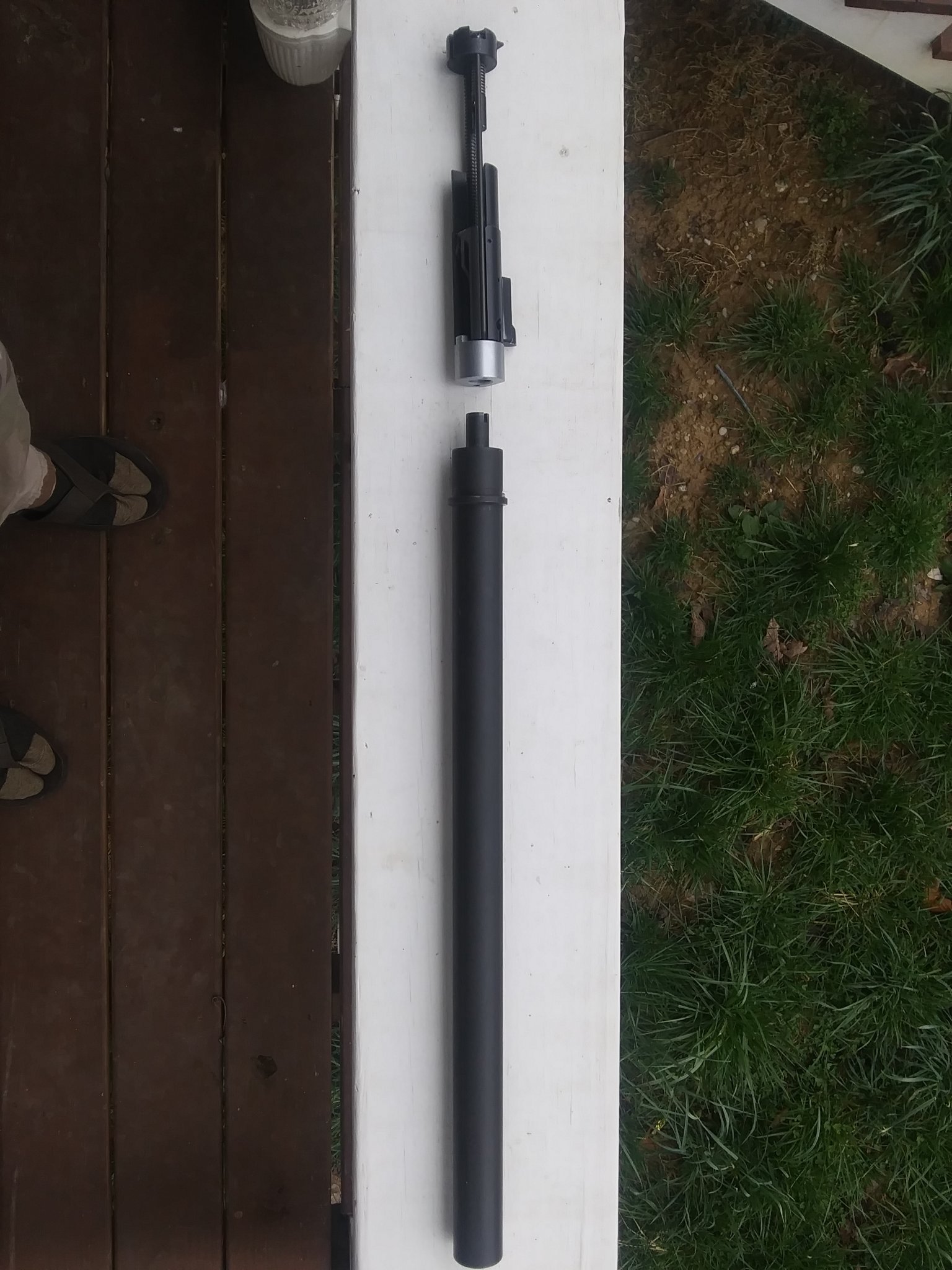

I've been hunting parts down for this thing for over a year. I finally happened upon a barrel. I had been searching for a complete upper but haven't seen one for sale in years.
This barrel/bolt combo is from an old 1st gen DPMS A/B-22 dedicated 22LR upper. These weren't made for very long and are kind of hard to find nowadays. They are based on the old Colt .22LR conversion. But instead of a chamber adapter, they have a slip block similar to a CMMG.
I have several of these Colt conversions and 8 mags, which is the reason I sought the DPMS out over the CMMG which is easy to get. But now that I have an original barrel, I can get a new barrel made much easier.
I wanted to make a trainer for high power. Since I already have the mags, this set up should fit the bill. It drops in any AR upper so I can build it to clone my high power rig. I'm going to pick up a Douglas .22LR blank. Then I just have to find someone to duplicate the DPMS barrel but with a 20" HBAR profile.
I'm going to go ahead and assemble the 16" and try it out. I am probably going to get the 16" barrel threaded.
You guys have any recommendations on who would be able to duplicate this DPMS barrel? It's almost identical to a CMMG barrel but the extractor cuts are in different locations. Looks like the DPMS barrel is one piece, no threaded extension.

Lol, yea those are basically my house shoes. But my damn feet get cold, lol. I take my work boots off on the porch and just slip these on til I get to the bathroom.

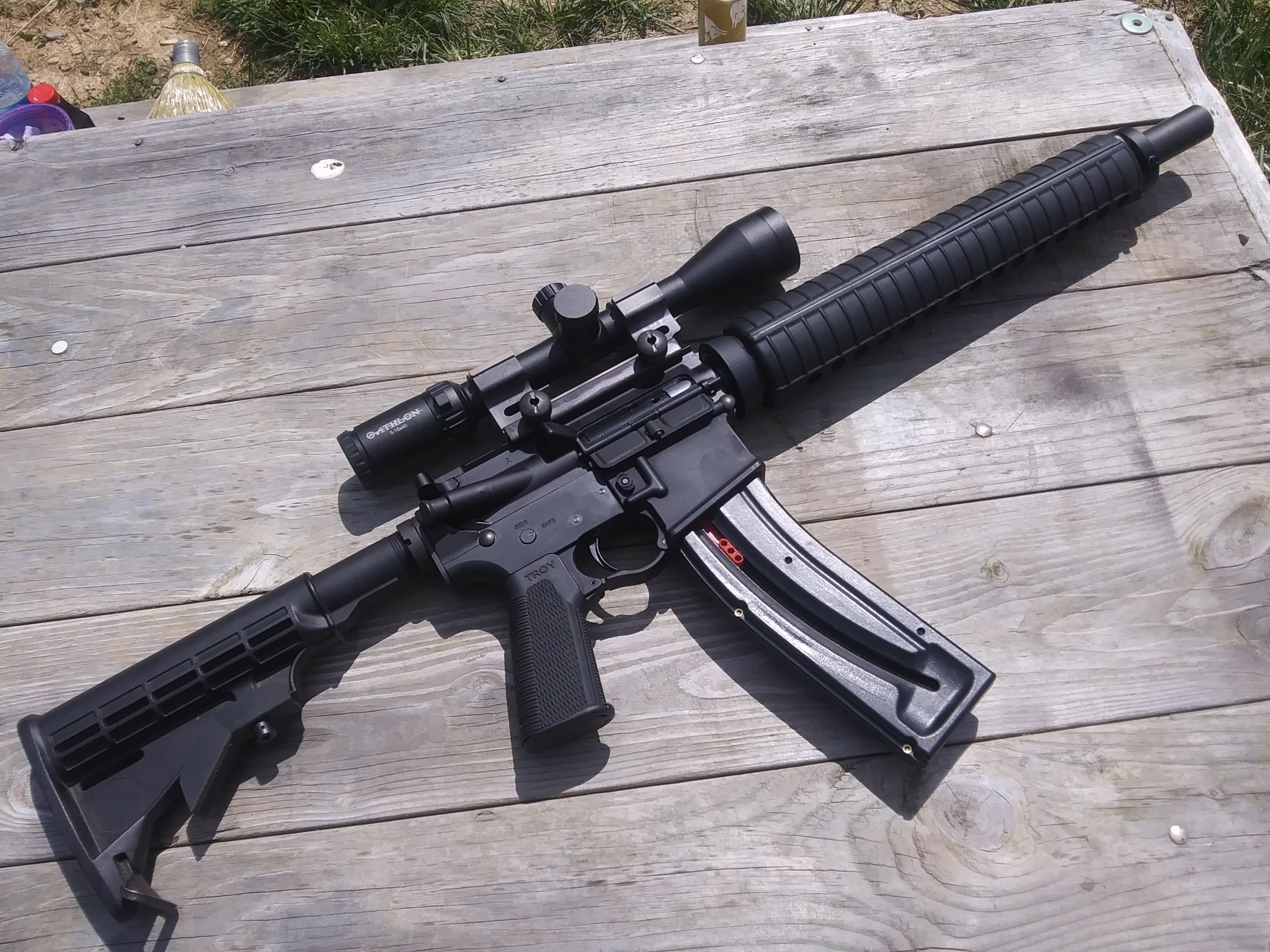

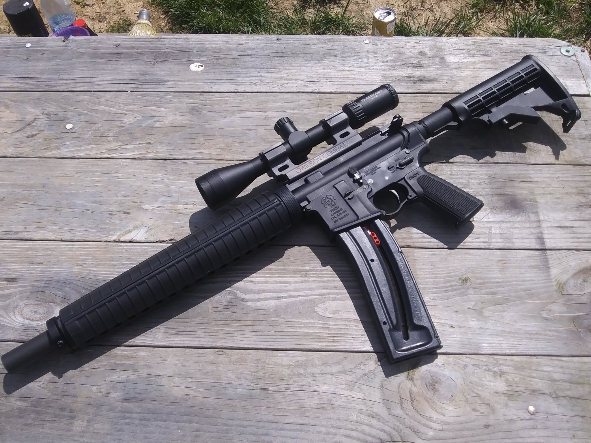

Been out playing with this little rifle today, me and my son... It makes for an excellent little trainer.
These Blackdog Colt/DPMS conversion mags are really great for these little guns. Maybe a little long, lol, but they are top notch so far for me. They hold 32 rounds and are made of some type of polymer.
Mounted an Athlon 3-15x on it I picked up here on the PX. It is zeroed and we are going to shoot some groups with different ammo tomorrow. It loves CCI Mini-Mags and Velocitors. Got a temporary makeshift handguard set up on it for now. I'm ordering this set up to be the permanent home for this conversion:

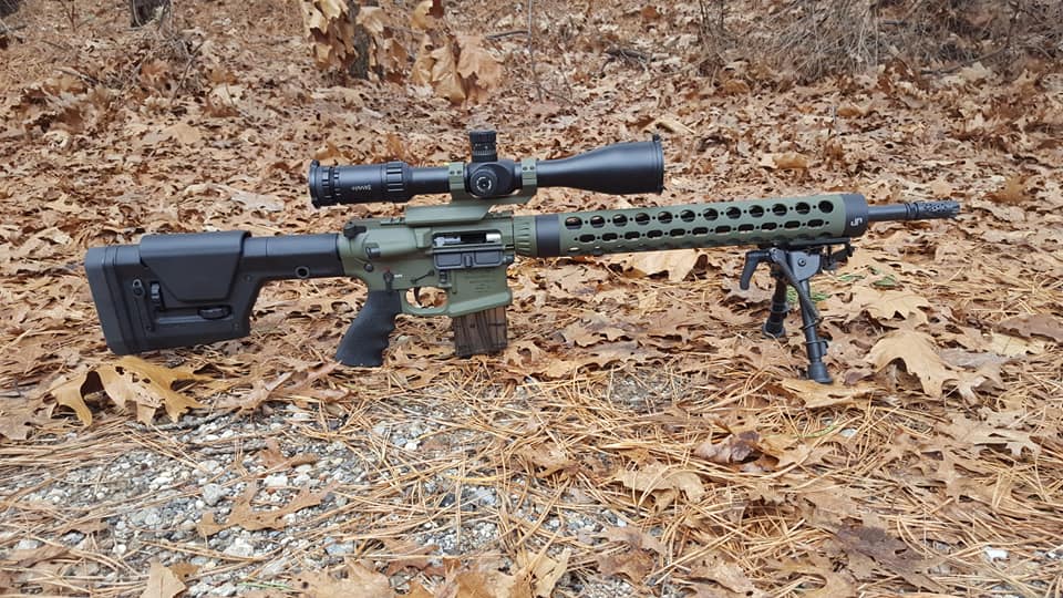

I have 2 dedicated builds. One is a DMPS and the other is a JP. Both shoot about 1/2-3/4 inch at 50 yards and run very well. I only shoot match ammo though them. Keep in mind you want a 1/16 twist in a 22LR.
Reactions: ShooterwithNoName
Been in mind you want a 1/16 twist in a 22LR.
That JP is amazing, that's a nice rig they really are top notch. My 16" DPMS barrel is 1:16 so that's what I planned to duplicate. Seems to be most blanks I've looked at are 1:16 for .22RF. Lothar Walther has rimfire blanks for a decent price and I've been pondering one of them.

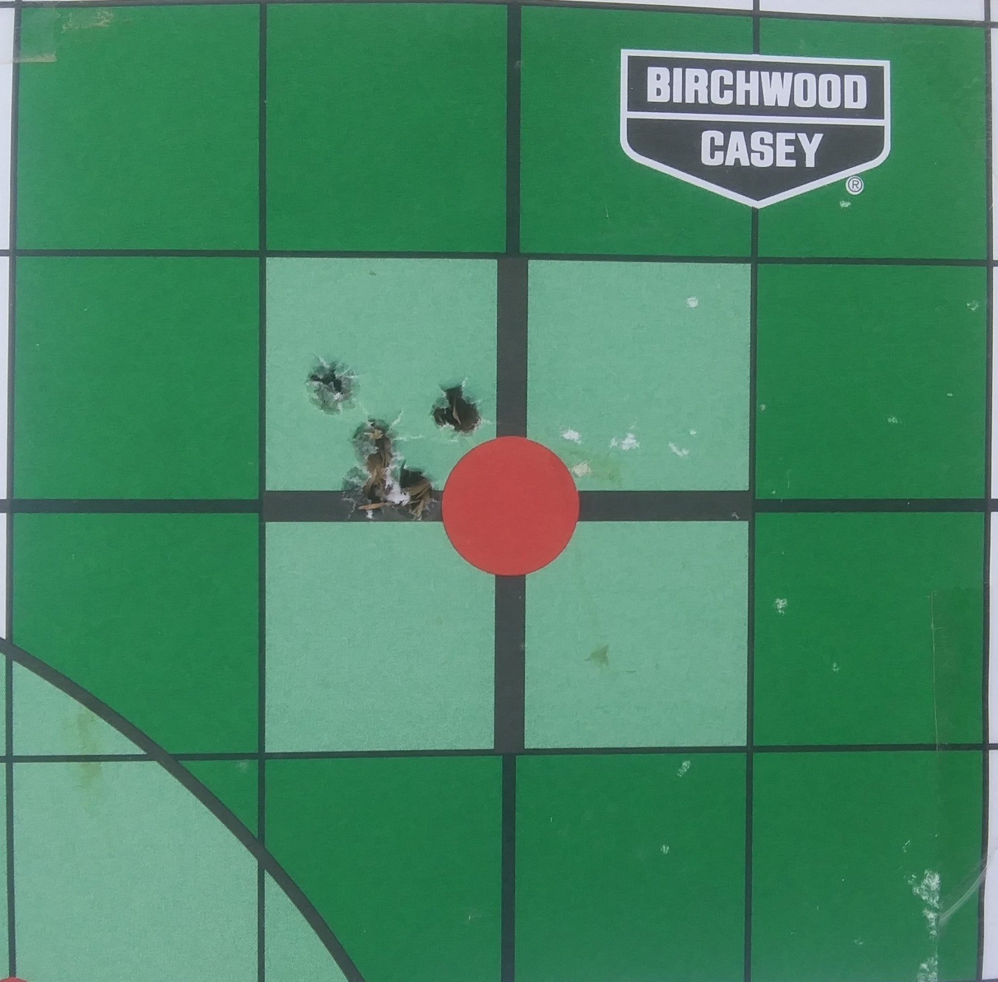

Tried a few groups today at 50yds with this 16" barrel. It shoots surprisingly well for what it is. Was shooting CCI Mini Mags so nothing special on the ammo either. But not bad I thought.
I have some Eley Match ammo stowed away I may try in it just to see how well it does. I am sure it can do better than above so why not try it and see...
