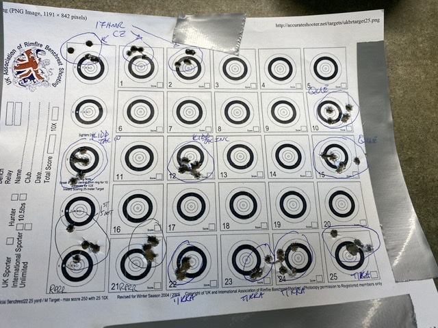

I took a bunch of my 22s out today and decided to shoot all of them on one target to test my Eley action ammo (pretty much CCi SV) and awesome see how they compared. It seems that the 1st shot from a cold gun was a flier.
Attached is a photo from today. Only the Tikka (4 groups starting from right side) and CZ 457 (3 groups) did I shoot more than 2 groups on this paper Not the best shooting but for me and pretty cheap ammo I am tickled pink (distance was 48.4 yards)
I am wondering if I should clean the chamber to get rid of the fliers or maybe it’s just me.
Rifles were
RPRr with OEM barrel
Tikka T1x OEM barrel
kidd LW barreled Tactical Innovations receiver
Reworked by Queue 10/22 with a custom shroud by brimstone barrel
CZ 457 (17hmr) and the wind was gusting when I got to shoot this one.

I found the same exact thing with both my Vudoo and my custom barreled T1X. Once the rifle cools down the first shot goes wild. Usually at leasT 1” off target but Ive seen my Vudoo go as much as 2-2 1/2” off at 50 yards. As soon as I start seeing those flyers I know it’s time to clean. I can prolong this for a very long time however if I just clean the chamber or pull a bore snake through after ever range trip. I usually give my rifle a good cleaning every 1500 rounds or so weather it needs it or not.

Eoddave27 and Frankr, yes i would suggest a good cleaning of the chamber and throat area but not the bore. Another test is to just keep shooting. I noticed the 1 cold shot flier to be further from the group after more rounds. When i clean the throat, the flier would start to show up, maybe only an inch off at 50yds after 500 rounds. Cleaning has the throat has defiently emilnated the intial flier for at least 500 rnds in my main 22lr, a Sako Finnfire II. But i've seen this issue in Savage MKII's i've owned that were very accurate, intial filer would be 2-3 inches and off the group, with a group 0.5" at 50yds
