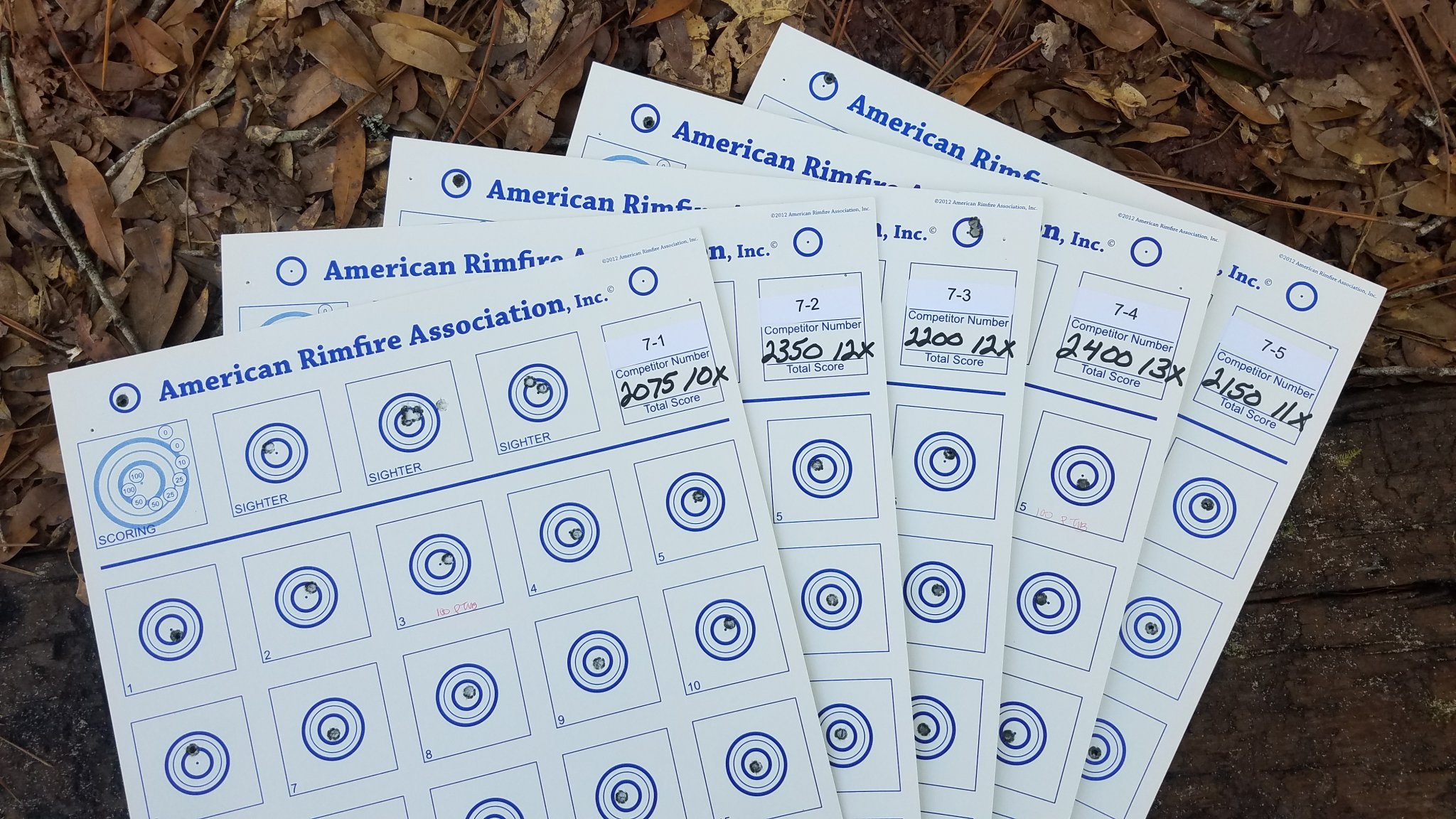

I have about 22,000 rounds on my barrel and it's still going strong.
This is the results from one of our ARA matches about a month ago. I've shot a little better and alot worse with it over the last 2 years.

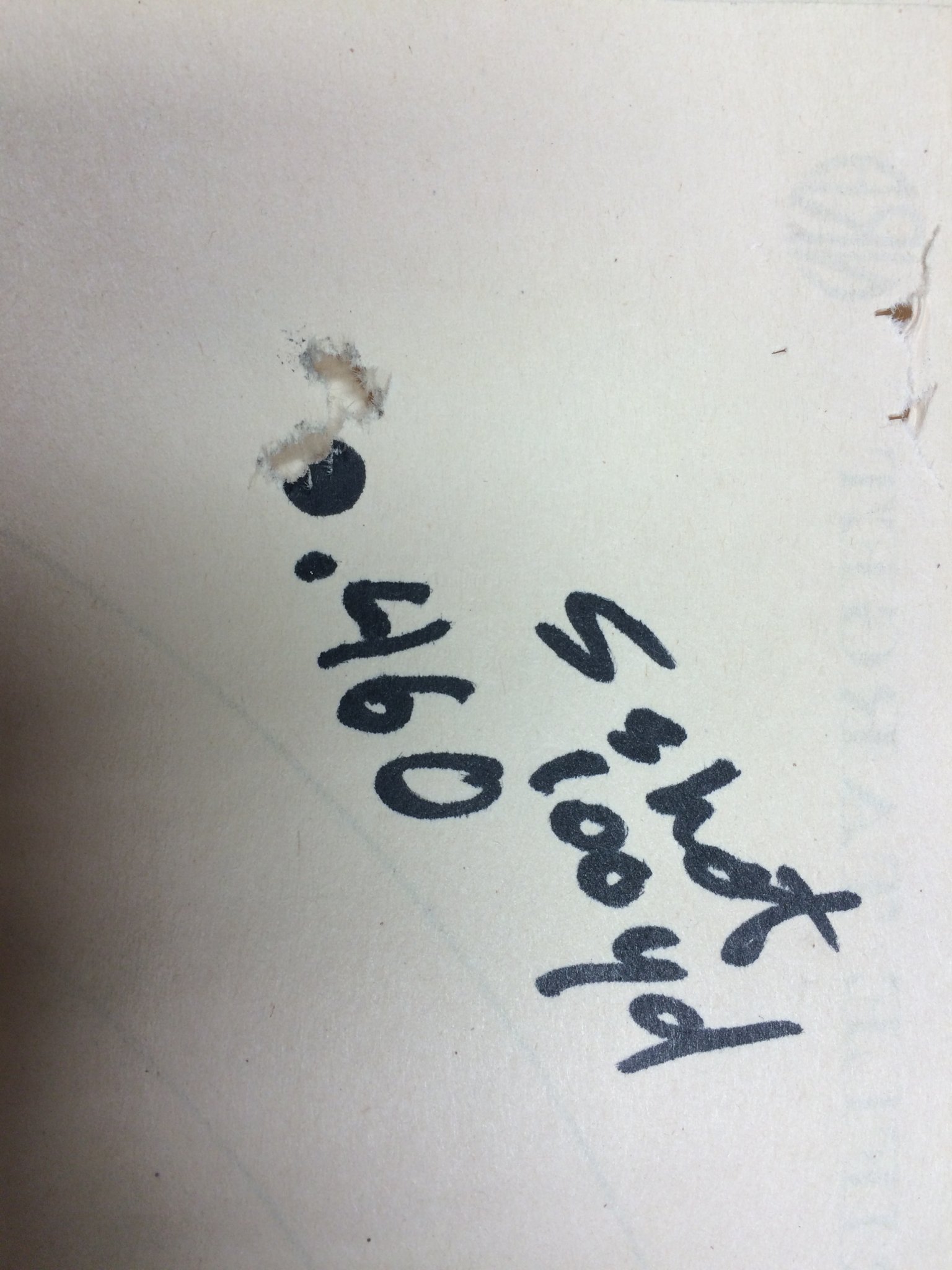

According to emails from Eley, RWS and Lapua
regarding factory batch grading test barrels,
accuracy drops off at anywhere from 55,000 to 180,000 shots fired.
The factories order replacement barrels regularly.
The difference is related to the steel used in making the barrel.
Softer stainless steel barrels wear faster than the forged high carbon steel.
Lilja had to replace a factory Anschutz barrel at 220,000 rounds fired.
Wear is caused by silica grit in the primer residue
deposited in the bore with each shot fired.
The majority of the wear takes place just forward of the chamber
producing an oval shaped bore with rifling worn away.

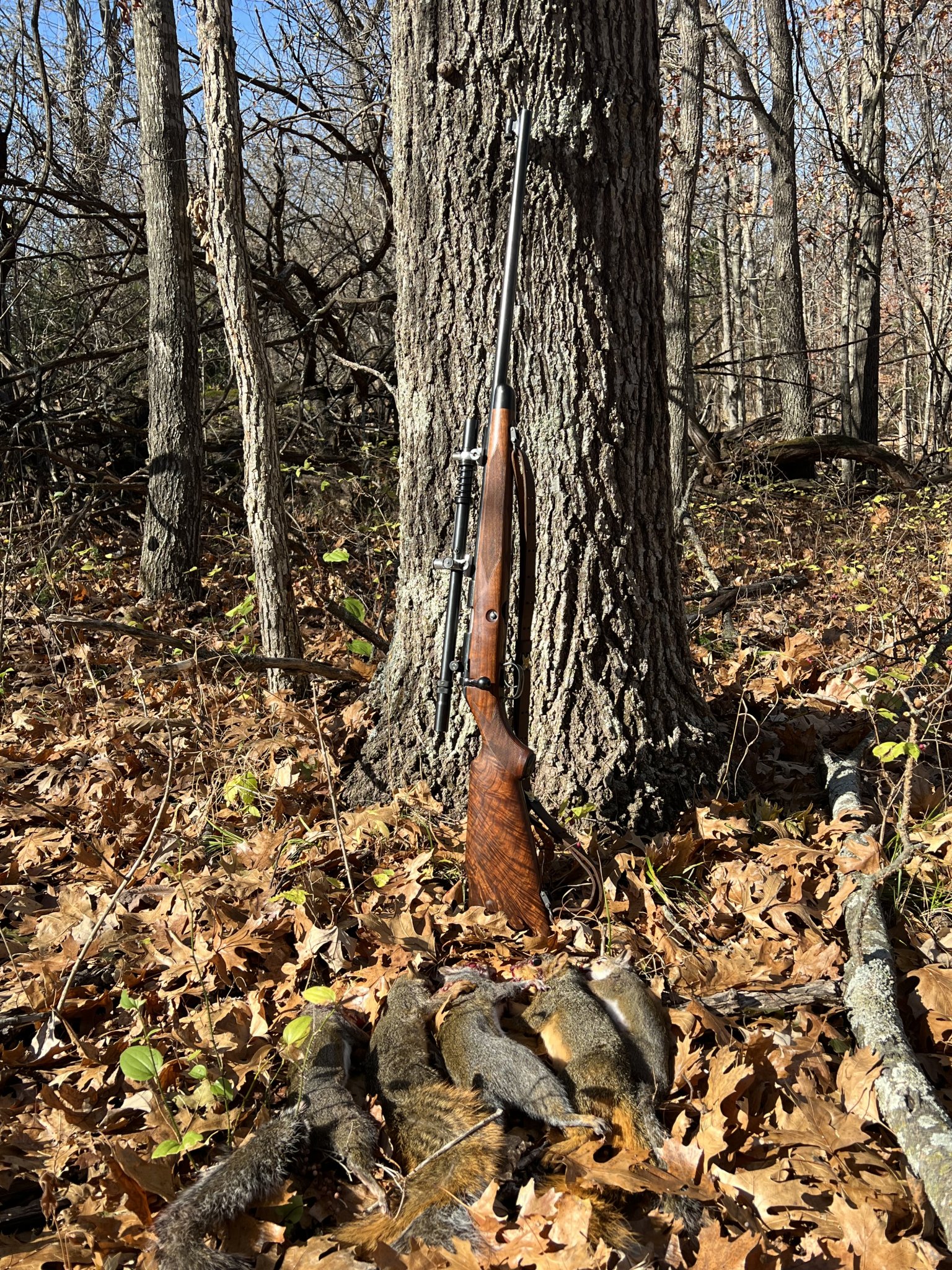

With regards to rimfire barrels wearing out, one has to answer that based on the accuracy requirement needed for it's use. For a squirrel or rabbit rifle the answer is no - the barrel will not wear out (again - for that level of required accuracy).

  • With regards to rimfire barrels wearing out, one has to answer that based on the accuracy requirement needed for it's use. For a squirrel or rabbit rifle the answer is no - the barrel will not wear out (again - for that level of required accuracy).
Squirrel hunting can require as much accuracy than any rimfire match shooting. A squirrel's head at 200 yards is small target.
