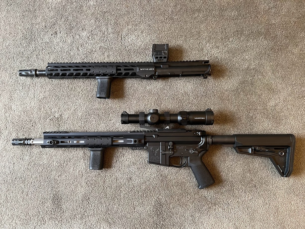

I didn't have a great luck with accuracy on my CMMG 16 inch barrel, but have heard good things about the BoreBuddy Apogee barrels so might say that's a decent route to go. Keep in mind that the conversion barrel length is very different than a standard AR barrel because of the shank length. A 16 inch conversion barrel is basically a 14.5" barrel as far as how much it protrudes from the receiver.
My 14.5 223 Wylde Barrel (bottom) vs 16.1 CMMG 22lr Barrel (top)
