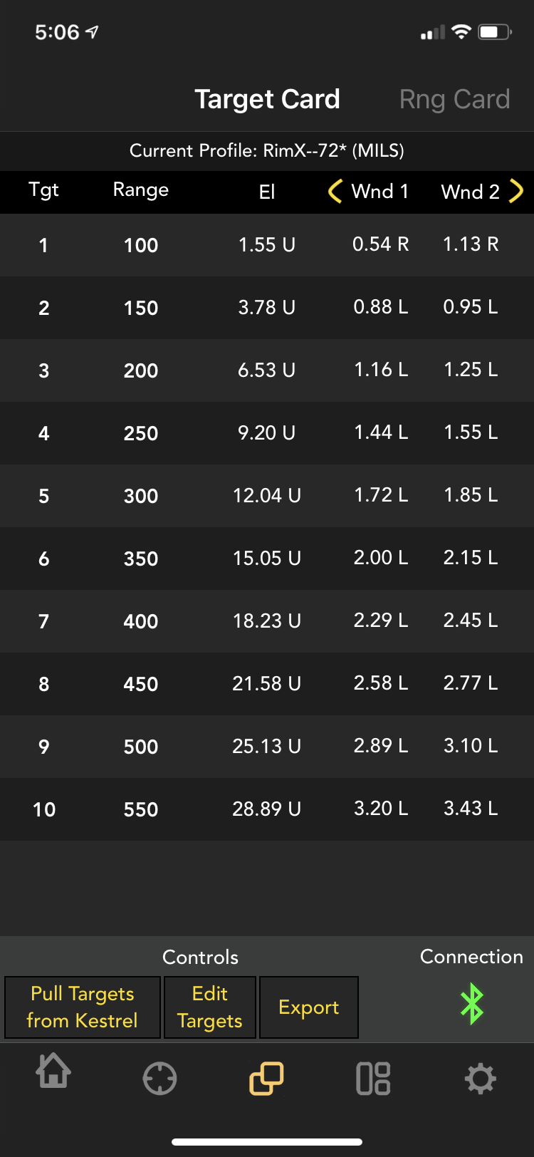

I've had this iron in the fire for wayyyyy too long, and it's nearly coming to a head.
RimX
Bartlein Carbon .22lr 20" (padom special)
AI AICS - whenever the AXSR variant is complete and stop holding up my project
TT Diamond
Era-Tac adjustable Mount
and, LOL, S&B 3-27 DTII LLR-Mil
I've got a pile of Center-X, and for those of you shooting this stuff 300-400 yards, what do your Kestrel AB inputs look like?
Pics to come once she's all perdy and complete.
ETA: G1 BC appears to be .174. Can anyone verify?

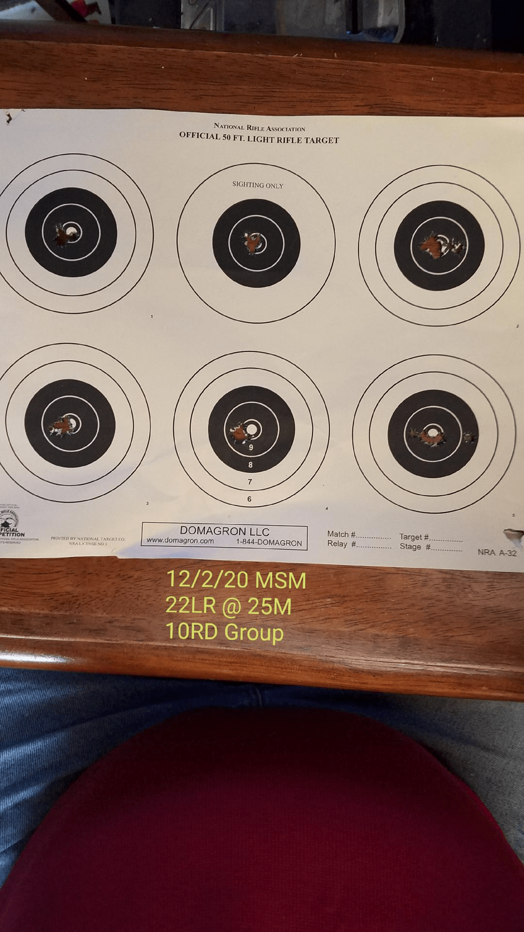

not that my results will be yours but I got for a 10 shot group
min 1087
max 1099
average1093
sd of 3.7 and this for a group at 82 feet
the middle row was the lapua center x the left groups were sk red box and the right was eley practice not the greatest groups of my life but it is what it is .
good luck with yours after shooting the sk it took my gun a few shots I guess its to settle in with the different ammo the same thing happened when I switched over to the eleys after these the practice ammo shot some pretty nice groups though its sd numbers were much higher
eley's practice
10 round group
those on paper
min 1059 max 1149 aver. 1100 sd 23.3 second 10 round group was min 1062 max 1116 aver. 1098 sd 16.4 and in case you care the sk red box shot
min 1079 max 1098 av 1091 sd 6.7
good luck with yours hope they work well for you I think its nice ammo if you can find it .

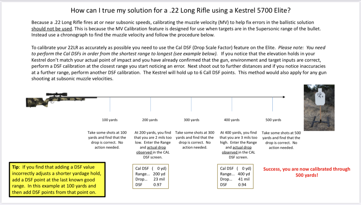

I entered all my stuff on my phone app and then transferred it to my Kestrel. Then did the DSF with my Center X and my RimX.
Did the DSF out to 275yds.
this is my inputs.
Velocity out of my 18” Green Mountain is anywhere from 1118fps @ 97* to 1093fps @ 42*
If you use the DSF function to true, your inputs don’t have to be perfect. I trued my rifle with sk standard plus over a year ago with DSF.
I did this with a center fire rifle and my results were all sorts of backwards. Are you entering dope, then going into DSF to adjust the correction at given yardage and mils actual? What’s your process?
With centerfire, did you only use DSF in subsonic ranges?
You also have to make sure the inputs are in specific order.

Yes, I jacked with DSF after playing with velocity in the center fire supersonic stuff. Didn’t know how to true for a subsonic round though. That’s easy enough!
Reactions: Dthomas3523
How closely did it match up to actuals? Did you have to fudge velocity?
Does this help?
