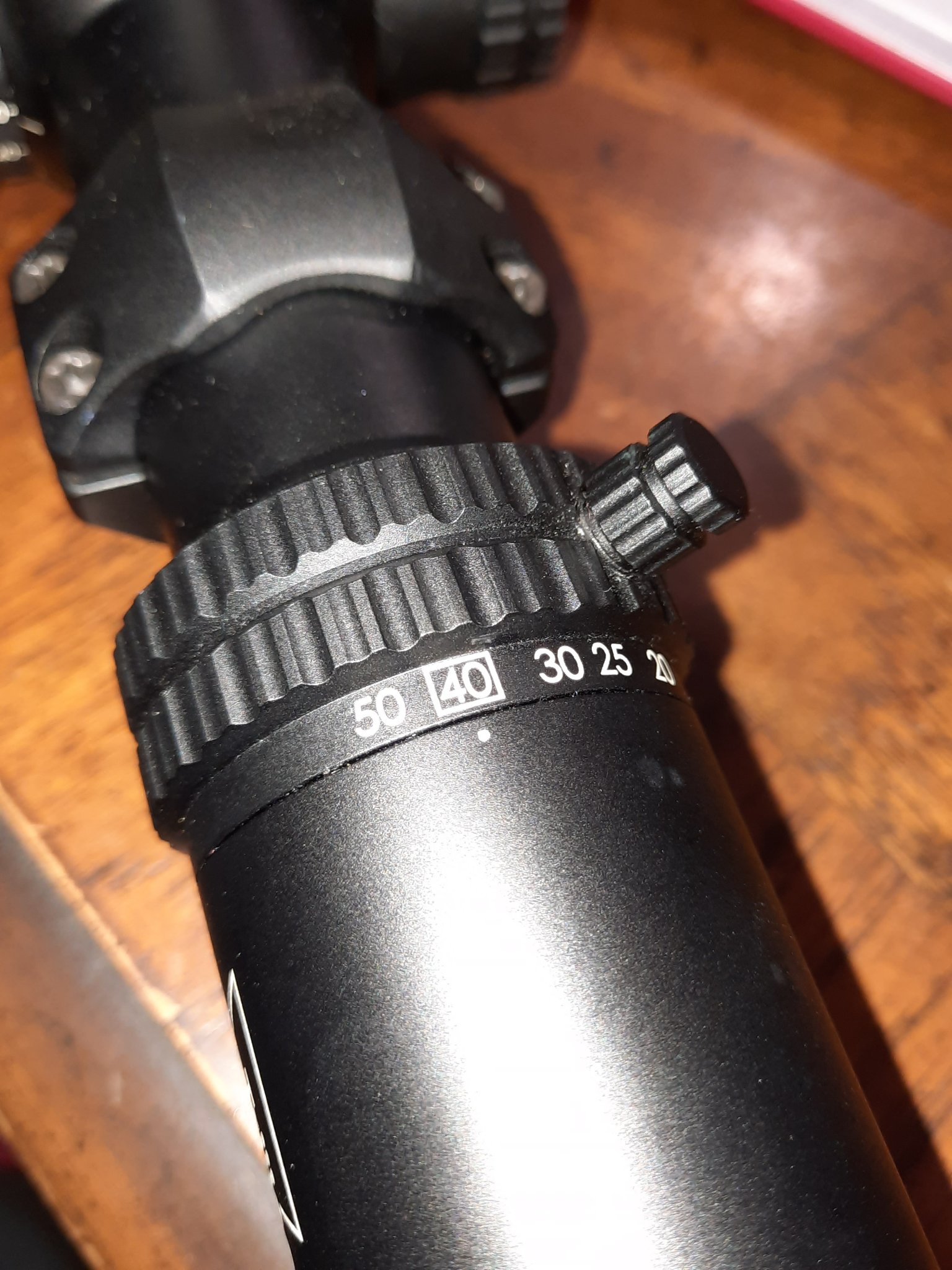

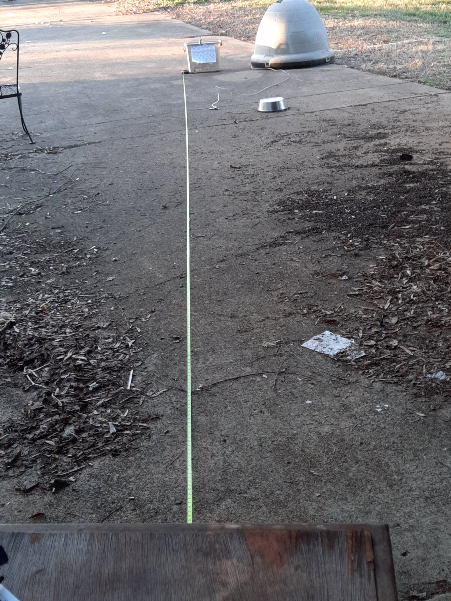

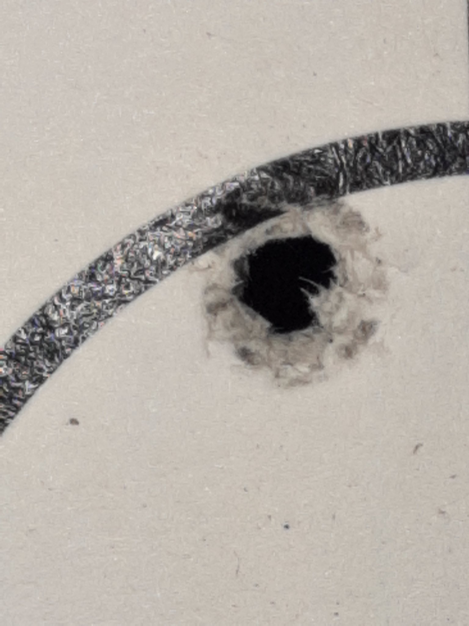

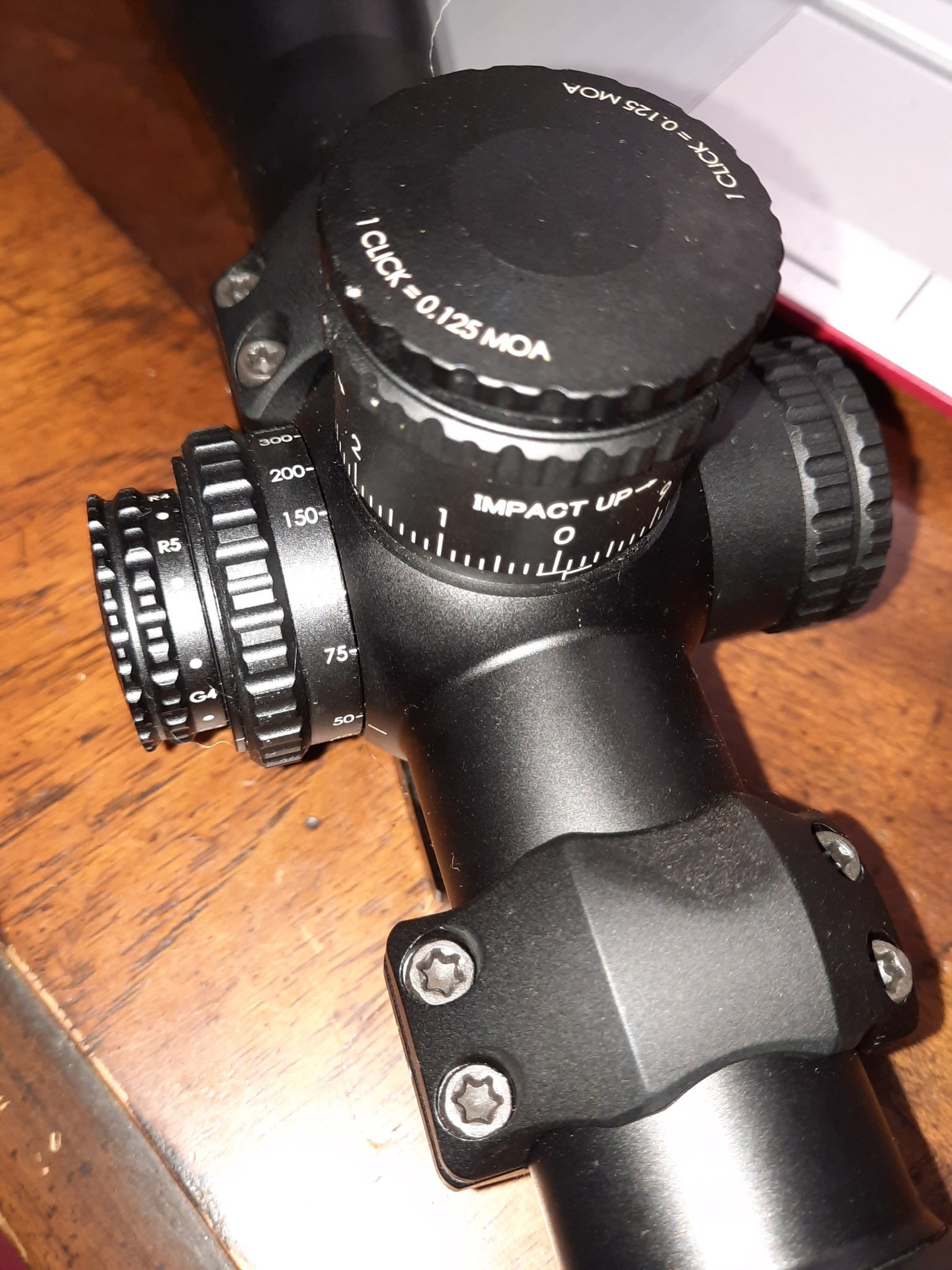

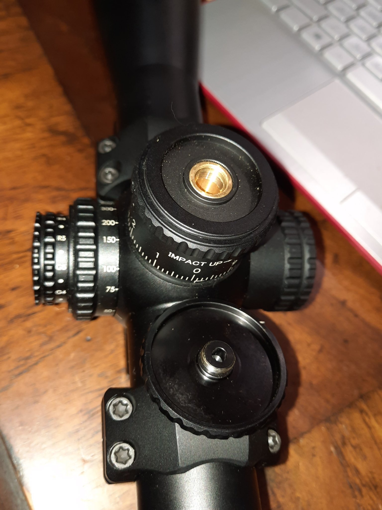

I use Trijicons for almost everything. 5-50x56s MOAs. They will focus down to 9 yards even at 50 power. That means crystal clear
and edge to edge. They adjust in 1/8 MOA increments which is another thing I have to have. The tool-less zero for elevation and
windage is very nice. Photo #3 is what the target looks like at 50X and at 9 yards.
#5 and ^ show the cap you remove to reset your zero. It also has a zero stop for elevation and a half way stop for the windage.

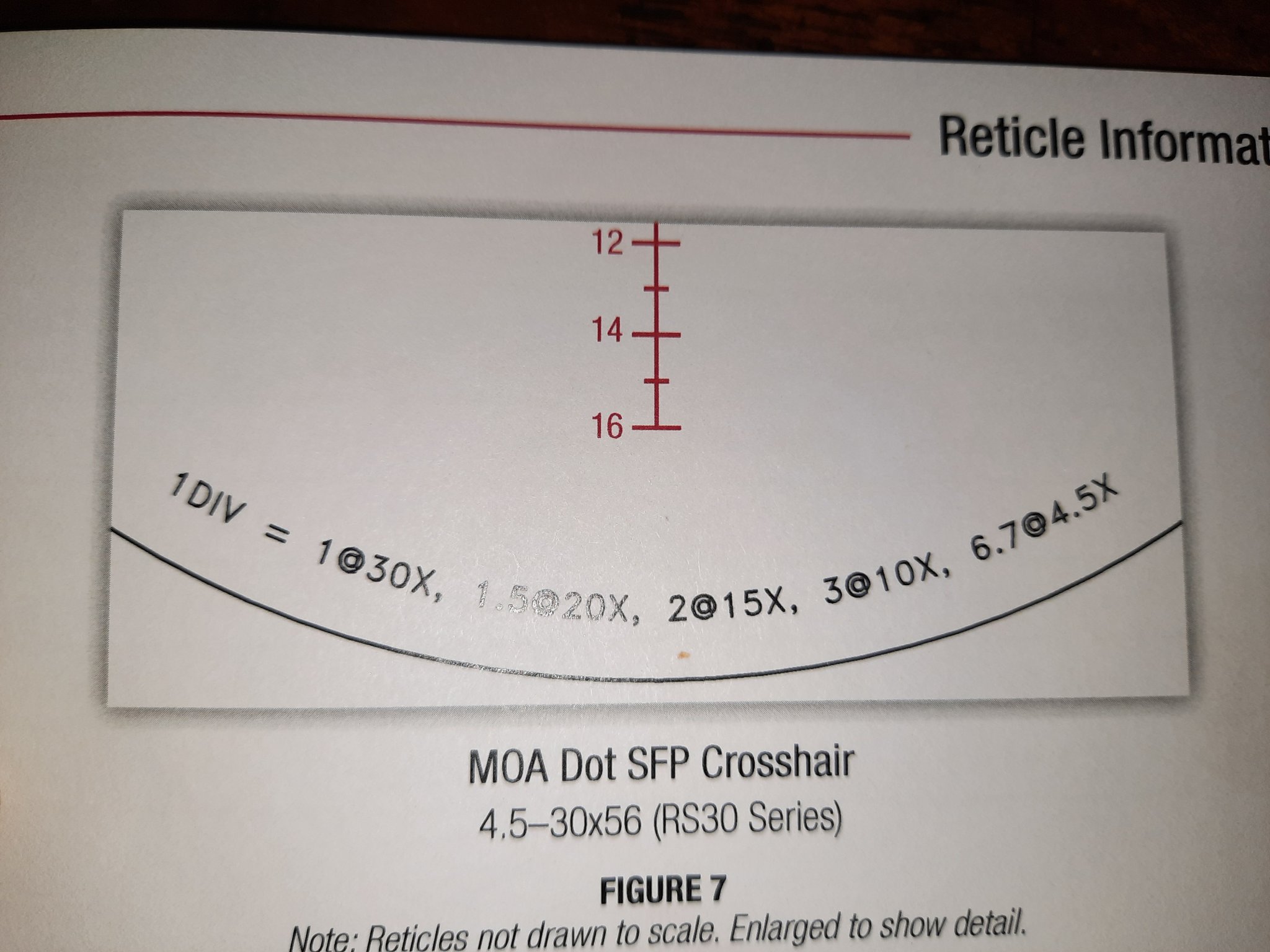

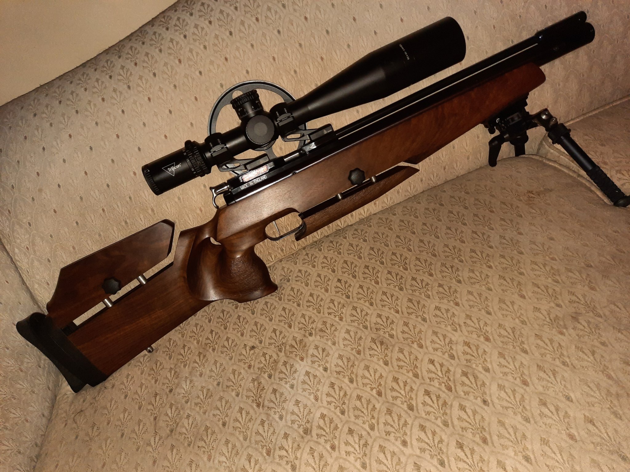

Both stops can be defeated if you want to. On the reticle you have a subtension scale. The one shown is for the 30X . With my
50X.... the subtensions are at 1:1 at 40 power. In the last photo you will see a square box around the 40 to remind you. That
feature is really handy for any hold over. I only use hold over for windage. It has a red and green reticle also with various powers
settings. I use the large parallax wheels to estimate distance. I'm not allowed a range finder in Field Target. Below a 100 yards,
I can range to about 1 yard of accuracy. 1/2 yard out to 70 yards???
They are nice and B&H photo allows you a 30 day, on the gun test drive period.
Although I would suggest a B14R along with these scopes.... I read your budget last.....
