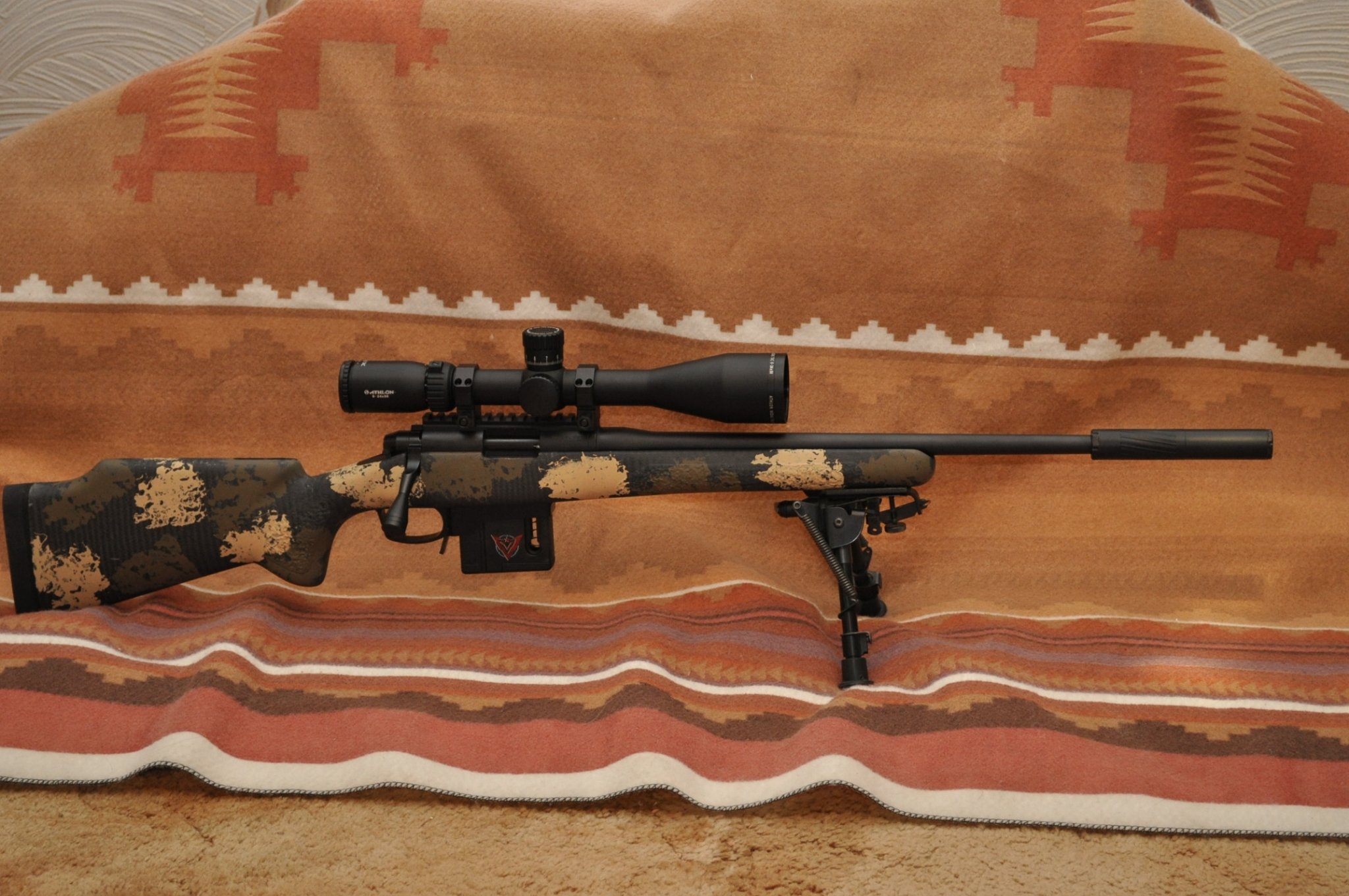

I've got several Ares BTR 6-24x50 scopes on rifles of my own, and so far one Midas TAC 6-24x50 on a V-22 Ranch. I'm not completely sure, but to my eyes, the TAC has slightly better optical quality than the Ares. The TAC's turrets definitely have more distinct clicks, and its parallax can be focused down to 10yds, while the Ares is limited to 25yds. The illumination feature of the Ares winds up costing $150 extra, relative to the price of the TAC. I like both scopes, but is illumination worth that much to you? I'm going with Midas TACs on several of my .22RF rifles to keep the weight & bulk down compared to the bigger Cronus 4.5-29x56 scopes I have on my 40X & V-22 comp rifles. Here's a pic of my little V-22 Ranch with the Midas TAC 6-24x50.
