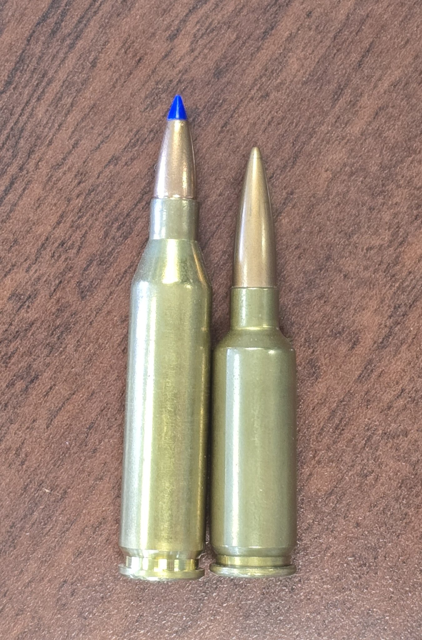

I feel like, for your first post, it would have been a good idea to at least look at a picture of the two, side by side before making such an inflammatory statement.
They are so close to being the same cartridge?
They aren't even remotely close. In any aspect other than the bullet diameter they fire.
So they are both short action, same diameter driving the same caliber bullet so yes I would categorize them as similar.
The case size is obviously different, I knew this before I asked the question.
