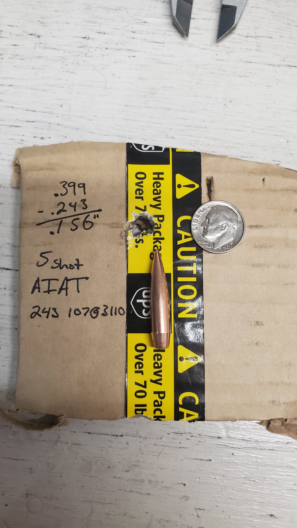

No pressure signs what so ever. I was running 3113 MV when I first started shooting it. Still no pressure signs. Not sure what my grains was at. Not home to look up. But that was with 105 Berger's. I changed to DTACS about 400 hundred rounds into barrel.

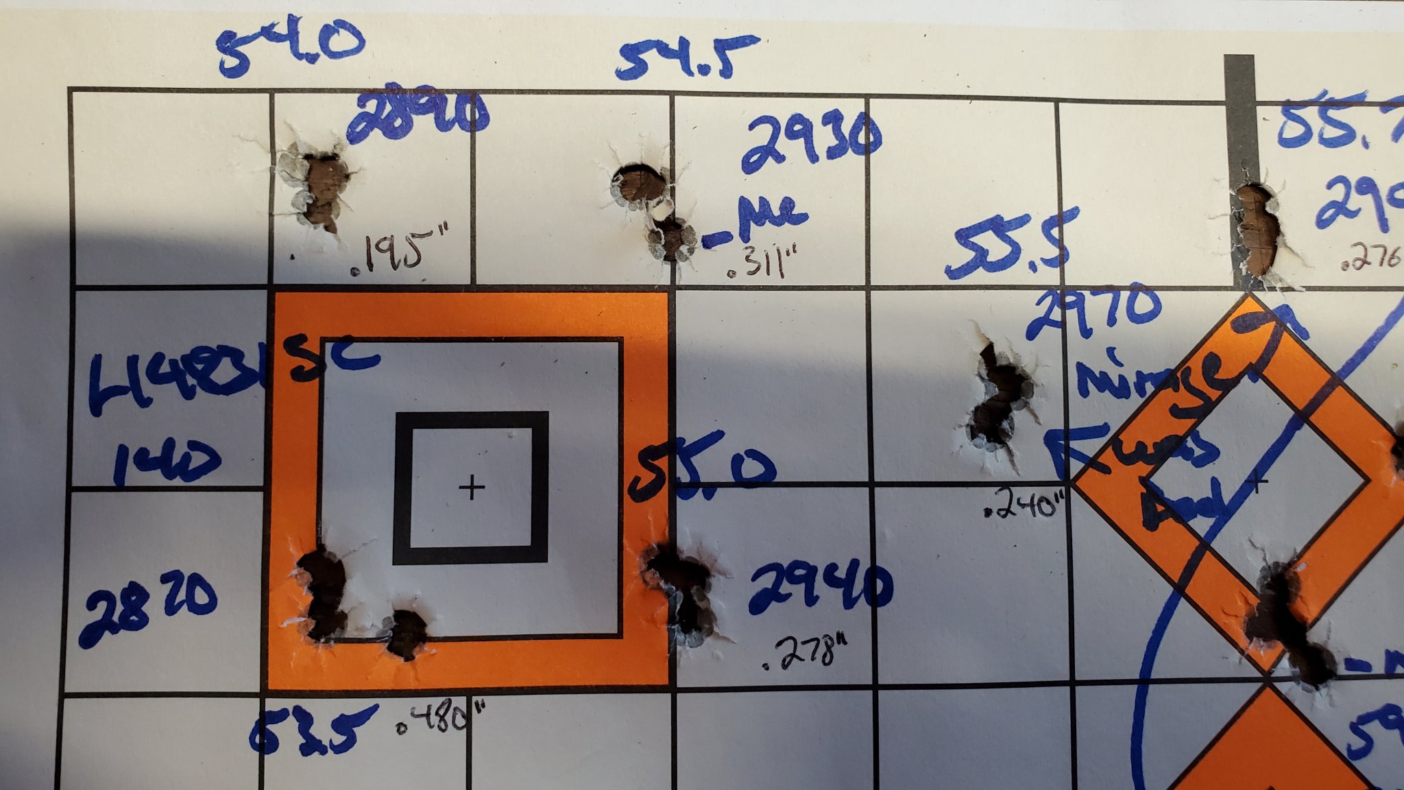

I have 4831sc for my 280ai, I may give it a try as well. I’m not trying to play the speed game at all, for me I just want super consistent load to work off of. I would be ecstatic with a 2900-3k load with the 110’s or 115’s that I could keep a low sd and Es in hot weather That I don’t have to keep dicking with.
H4831SC is a good powder. Some 3rd groups in a 6.5prc
