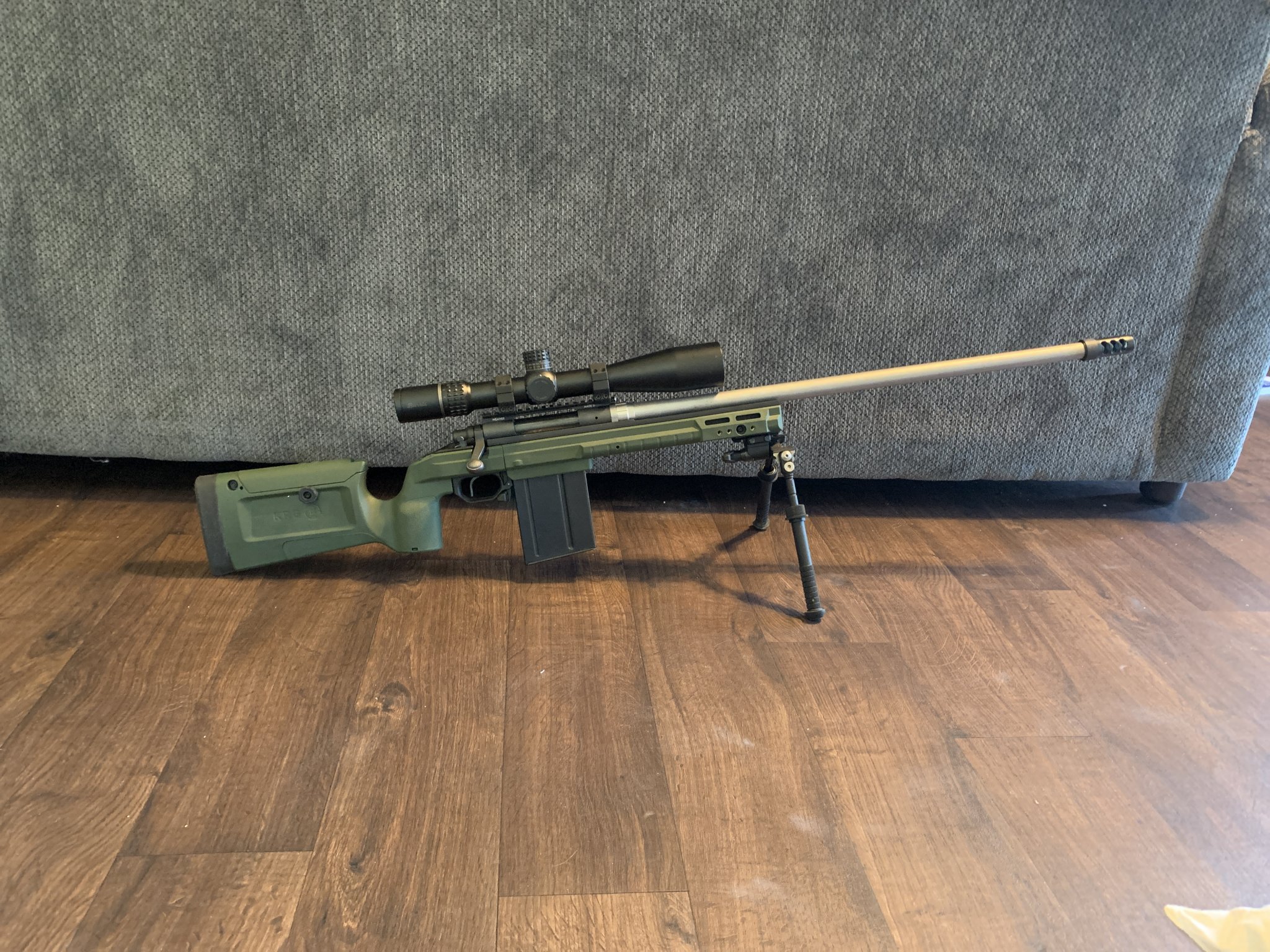

What is your COAL and bullet jump? How is the accuracy? Nice piece, BTW.
I dont have the case measuring tools for the .257 diameter i did the old seat it a little bit then use the bolt to seat to the lands then set my RCBS gold medal seating die to that length then ran it down .015 and that was giving me 5/8" groups at 100 and I was getting sd's around 13fps so im guessing that was on my brass being unfired , im all out of retumbo now so ill have to give it another go with a new powder now and see what i come up with.
Thanks. Those groups seem to be typical from what I gather and experienced.

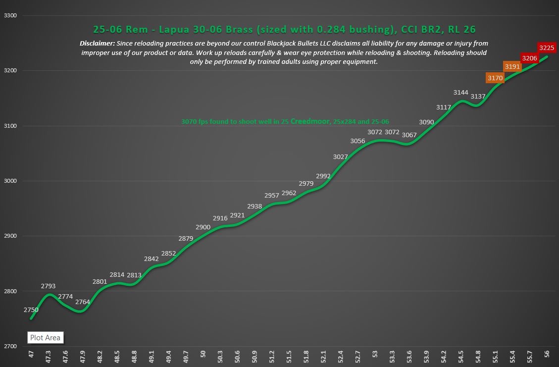

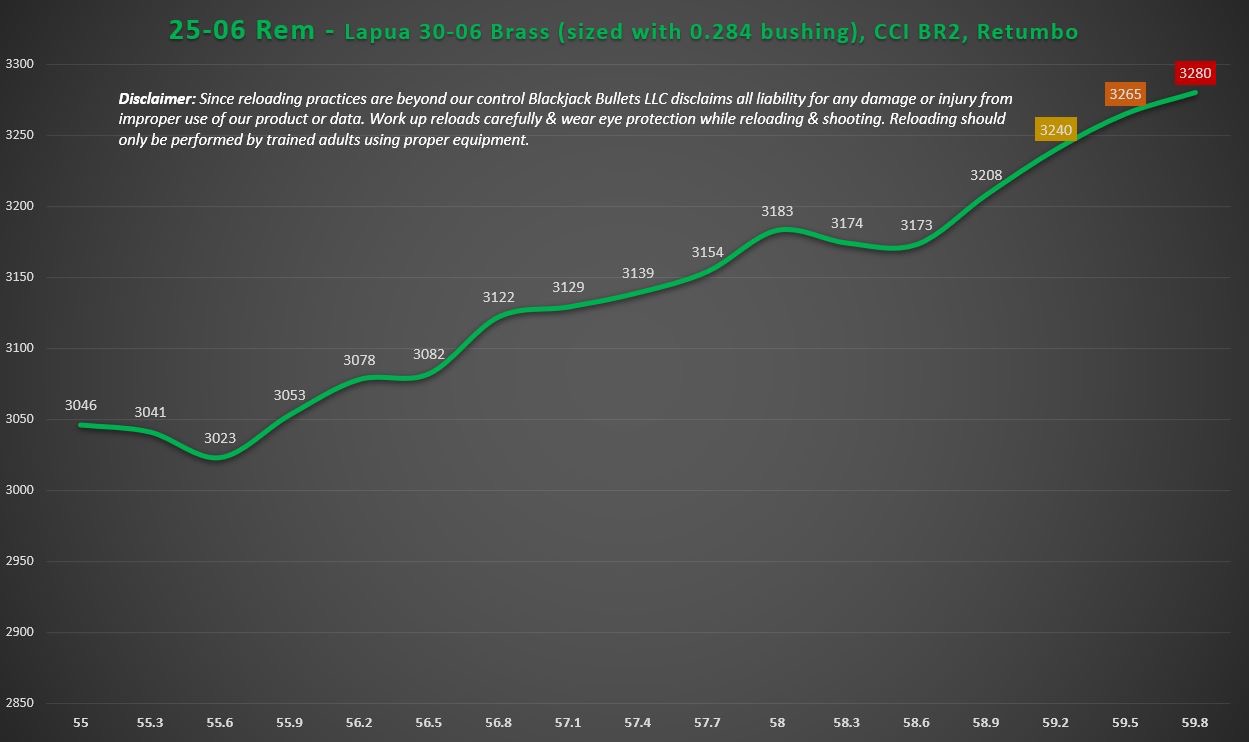

Those are from the Black Jack FB. I have a similar graph for N160 compared to the FB RL26. Except a few good nodes around 2700, 2800, and 2900. No over pressure up to 3025 where I stopped. There is no way I'm going to push a 131 over 3000 in a 25-06. I'm pushing as it is at 2900-2950 with this overbore cartridge. The Ace has been out a couple of years and I don't see much on barrel life. At 500 my lands have been pushed out .013 jammed.
I know, I made them. But I don’t know why you would not run it over 3kfps. Probably 1/3 of 25 creed barrels can run safely at 3030-3040fps for 3000 rounds. Other slower barrels still run comfortably at 2950-2970. The -06 has over 10 grains more H2O capacity, why wouldn’t you utilize it?
Because of case volume / bore area makes the 25-06 one of the most wicked overbore. Published reloading data has 100 grains or less bullets with MV over 3100. I pushed 120 grain bullets a little over 3000 and was getting right at 1200 rounds accuracy. After that it became a 1 MOA rifle. I'm suspecting less with a 131-grain bullet. And that is with backing down to mid 2900s. Some published loads have a 120 at about 3100 but most are 2900s and as low as 2800s..

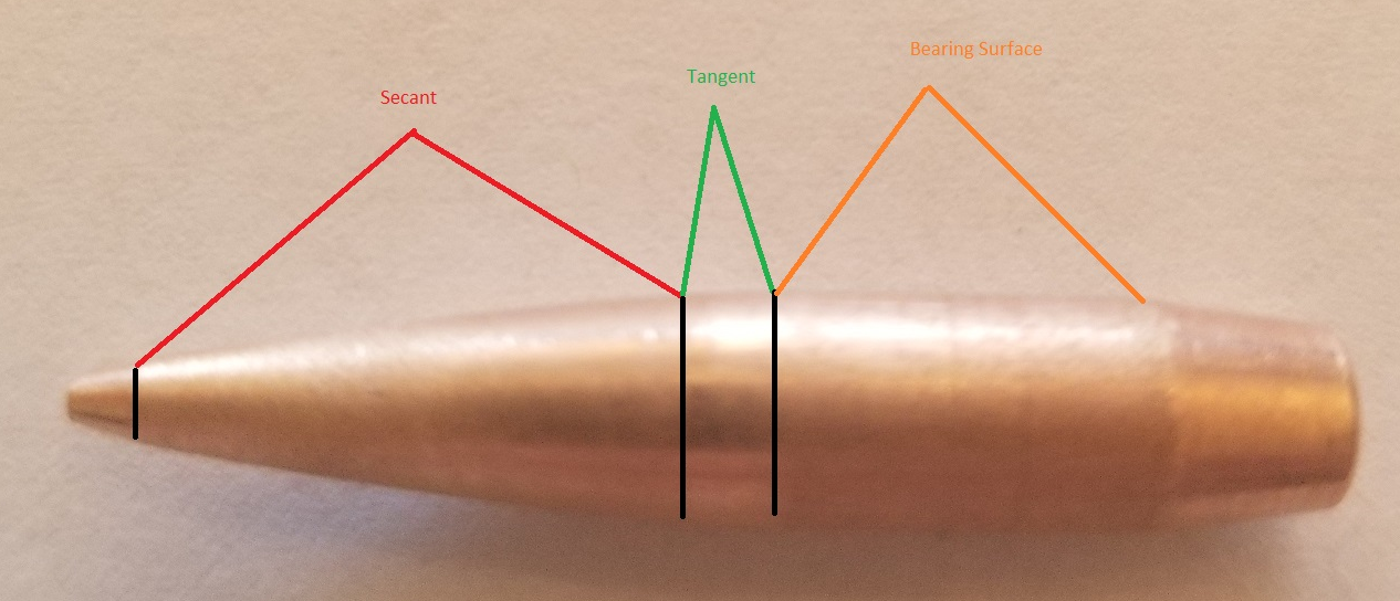

I figured out how to calculate throat angle on a tangent ogive bullet. In case anybody wants to know, lol. The BJ Ace is 1.55 degrees. The Ogive Radius is 9.33 calibers. I think, lol.
I'm working on how to calculate this for a secant bullet but it is a lot more complex.
9.3R for a Blackjack 131 Ace doesn't sound right. I'm thinking more in line with Bergers longest. In the range of 12-15R.
The Berger VLD is 14.95. I just used the standard tangent formula to arrive at 9.33. The Ace is tangent not secant but we don't know the Rt/R to determine how close to secant it may be. So, yeah 9.33 may be conservative.

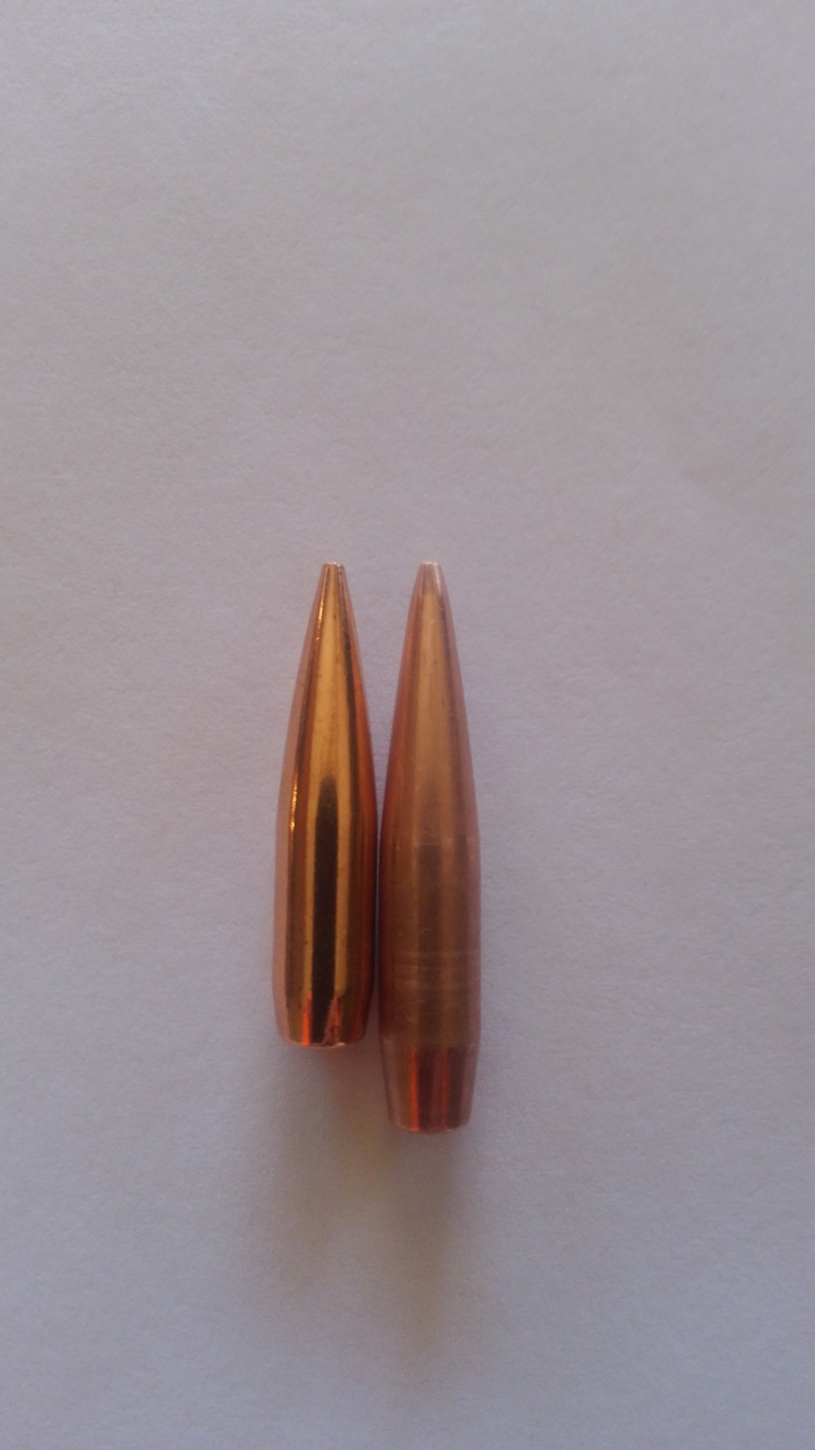

The bullet on the right looks like a hybrid. I assume you mean a 115 VLD on the left? 131 Blackjack ACE on the right? The junction looks ever so slightly tangent, while the rest of the nose looks secant. The 115 VLD looks like the ogive is blended very well to the bearing surface which would make it a hybrid as well. JMO.
Added: the hybrid 'look' on the left is going to take jump a lot better than the 'more secant' looking ogive on the right. Again, JMO/JME. I'm usually right about 10% of the time.
But, I'm certainly following what you're doing with the 25-06. I'm going to do something in the near future with a tight twisted .257 cal. rifle.
Added: Getting down to brass tacks, the ogive on the left is clearly shorter than the ogive on the right.
Yes the one on the left is the 115 VLD secant with a published 14.95 ogive radius. It's Rt/R is .56 with .50 being as secant as you can get.

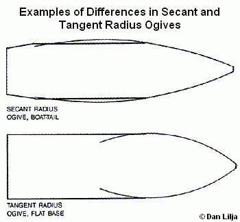

The secant in the drawing below would have an Rt/R of .50 and the tangent 1.0. Most bullets fall in-between. Remember, the 115 VLD is .56.
Also, don't miss the related posts' links at the end of the above short article.
