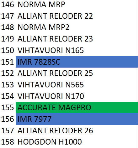

I have not rebarreled my custom .25-06 AI with the new barrel yet... But when I do, it will be with one I purchased years ago and it's been sitting in a corner of the closet in the reloading room... It's Proof Research Sendero carbon fiber blank that will finish at 26", and has a 7.5" twist rate. So, it will get done someday, just waiting on the barrel to burn-out, which will probably be a while.
As for powders, I use IMR 7828 SSC for it, currently with the Burger 115 VLD's due to the 10" twist, and achieve nearly .257 Wby performance from it. I used to have a .257 Wby as well (26") so I compared them side-by-side a lot. I ended up within 75-100 FPS MV of the Weatherby. So, I was very happy with the outcome.
Yeah I don’t think we can get the IMR powders here unfortunately
Here's a good range around the same burn rate as 7828 SSC... This is from the 2023 Hodgdon Burn Rate Chart.
You might be able to find something similar that is available in Australia.
