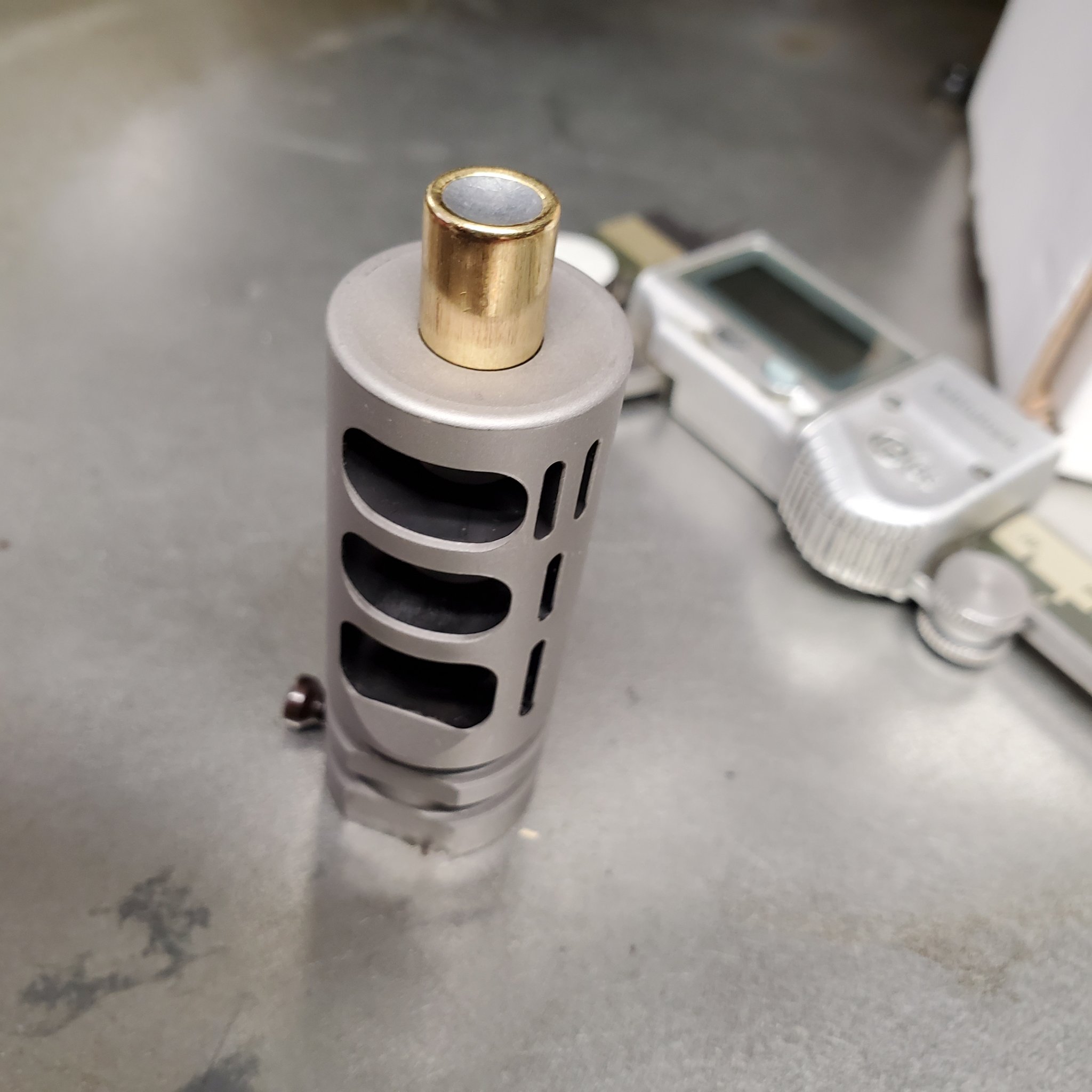

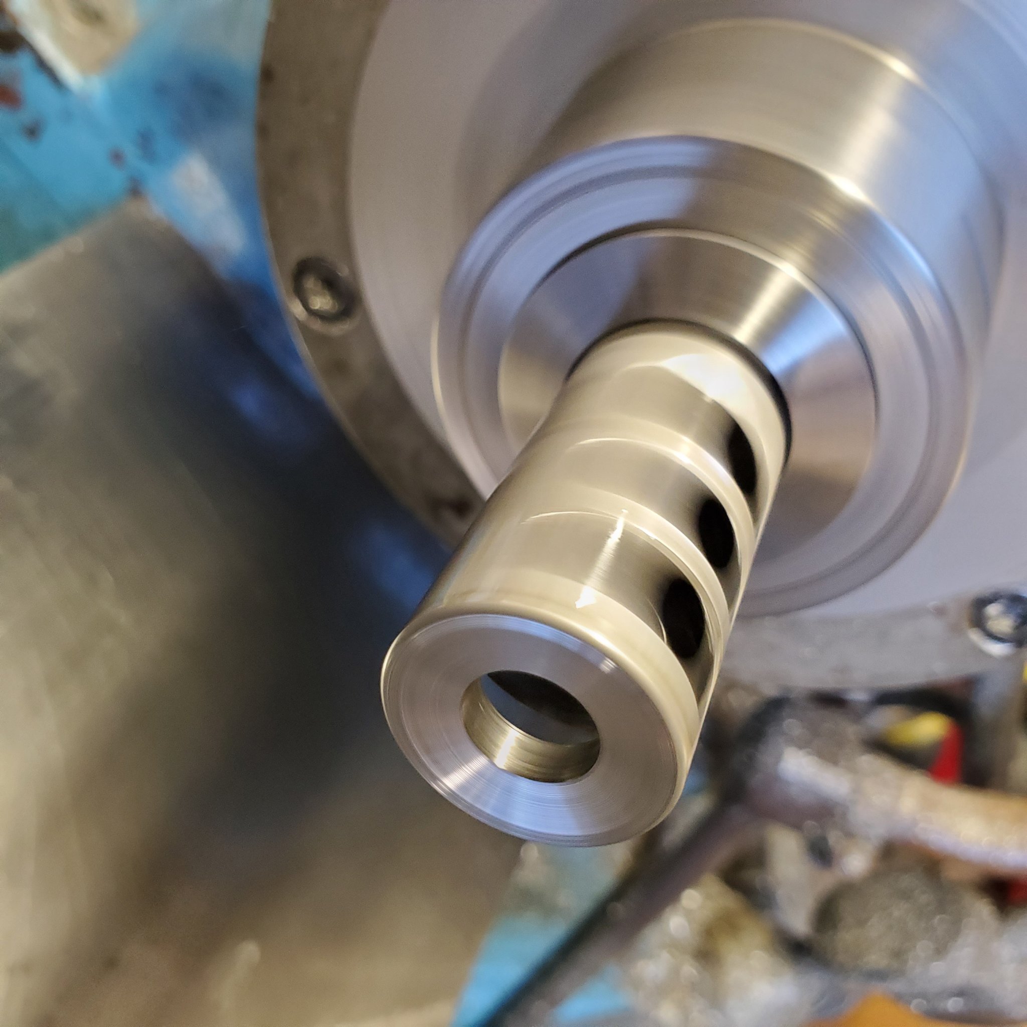

Pick any that fit your barrel thread up to 30 cal.
Any reasonable clearance only makes a little difference if it's .030" to .1" in recoil reduction.
Or...a 6mm if it fits the thread, just make sure ya have .030" clearance ... drill it out for bullet clearance...I use a lathe and boring bar. I repurpose muzzle brakes all the time, including re-threading to fit the muzzle. Simple...
Here is an example... bullet too large, so drill or bore out the brake for clearance, this one was also faced when mounted on the barrel ...so it's quite "Marry Popins" when finished. Or parallel and perpendicular, as the bullet passes through, possibly aiding in accuracy, as the bullet comes out of the barrel bore, everything is equal on all sides and the face is exactly perpendicular to the bullet on exit. Life is like a box of chocolates, sometimes ya get the yucky one...Don't sweat the small stuff ...fix it.
I've read where .020 is optimal clearance for accuracy.
Might just be internet hype.
.030" oversize is as close as you want. In tests it made little difference if it was .030" to .060" even .1" over bullet diameter worked surprisingly well. I sometimes make my own muzzle brakes, and they are .030" over, and never use crush washers. Commonly used Crush washers do not allow a perfect square seat, and can force the brake bore off center of the rifle bore, causing some rather ugly runout of the brake. Plus a host of other manufacturing faults can cause misalignment of the two bores. As in the picture above the brake runout was excessive even when butted against the square face of the barrel, and the brake bore, bored out and re faced square. You can machine and thread a barrel stub and check your brake runout in a lathe, add a crush washer and tighten more runout will be added.
That and fouling build up, can get bullet interference if the bullet and brake are too close in diameter. Plus the fact there is little benefit in going closer.

Or machine your own, like I do, if I really feel the need....
