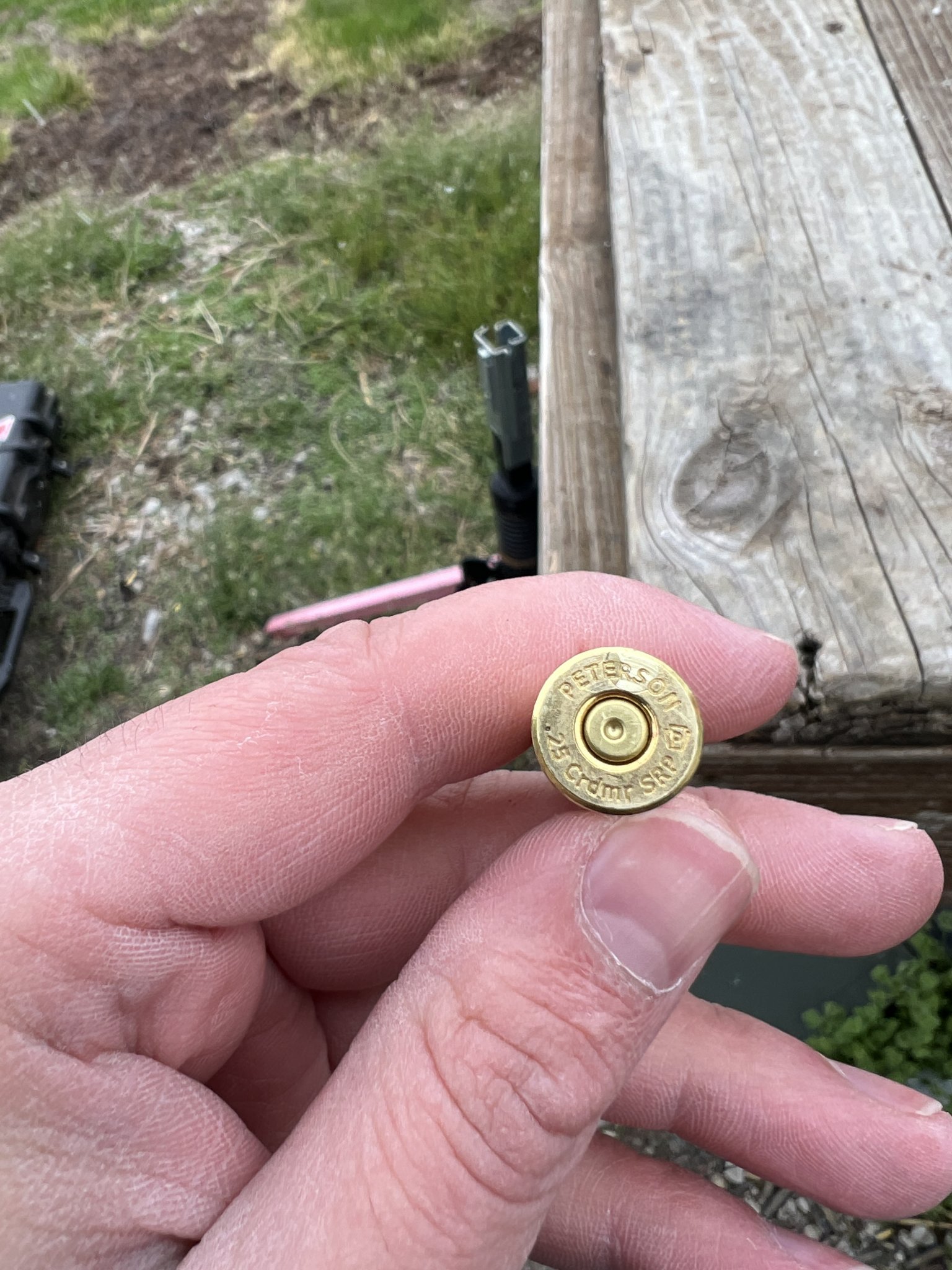

My initial load was to form the shoulders to my specific chamber
41.5 win 748, cheap 100 gr ppu bullets
Seated .200 into case (short flat base bullet)
What I initially thought was ejector smear, turned out to be ejector stamp- severe.
Backed down 3 gr- same result
Backed down to 36.5- same result
Heavy bolt lift off and on throughout this whole process, lighter loads produced “less heavy” but still harder than normal lift.
All rounds chambered like butter.
Tried what my planned final load components would be to see if the ppu barrels were causing this or possibly the powder-
Started low at 39 gr h4350
Berger 135
Same result, bullet seated .20 off lands
I’ve been chasing this around all year, bad powder? No, ppu bullets out of spec? No. Burr in the chamber? No
Cases form to same shoulder measurement after firing no matter what load
Action is high end and reputable in the custom rifle world , I’m not mentioning the manufacturer right now as they offered to look at the rifle, I swapped out another bolt for the action as my gunsmith thought that was the issue originally. Chased around the possibility of the ejector being out of spec, no.
Gunsmith is high end and reputable
Barrel blank from xcaliber, reamed with brand new reamer mentioned above.
Load data from quick load to form the brass shoulder to my chamber before starting development with h4350 and bergers.
Just wanted to see if anyone has had a similar experience, all I can guess is the action or the chamber.
The primer in your pic isn't cratered at all (which is strange if you're getting heavy bolt lifts). I usually notice cratering around the primer first (IME, which is admittedly limited, since I never really load close to max pressure).
I've seen ejector imprints like that on new brass from loads that were nowhere near max a couple of times, so IDK if that's telling you the whole story (or even anything at all)...
That said, 25CM is wading into the wildcat waters a little... wonky reamer specs (like it or not, you're an early adopter) and/or brass that isn't quite right (I doubt that Perterson stuff is widely used) would be my prime suspects...

I’d call that moderate ejector pressure sign. Severe will dig up the brass and your fingernail will catch it. It will be visibly raised. You know the load is hot then. Next primers will blow.
Goodo then.
By mentioning the neck I didn’t mean neck tension, rather the case wall thickness+projectile “width” vs chamber neck “space”.
All the best with it.
The picture makes it not look as bad, it'll definitely catch your nail, with light at the right angle I'm able to see height difference.
Reactions: db2000
Bolt out, depress ejector pin with something, like a pen or punch or whatever. Make sure it goes marginally under flush. If it doesn't,.. found your issue.
Remove ejector, clean the hole and pin. It can get gunk behind it. Rarely your ejector pin is too long.
Lastly, is the hole that the ejector is in, is it sharp ? It should have the smallest deburr. Otherwise it acts like a knife edge on the brass, cutting / shaving it. Thus, looks like pressure signs.
This is the conclusion we came to about a month ago, ejector must not be going subflush, turns out it was. Took the ejector out and examined it, everything was in spec and machined properly with no rough edges. Threw in a brand new bolt just for the hell of it just in case- same result.
