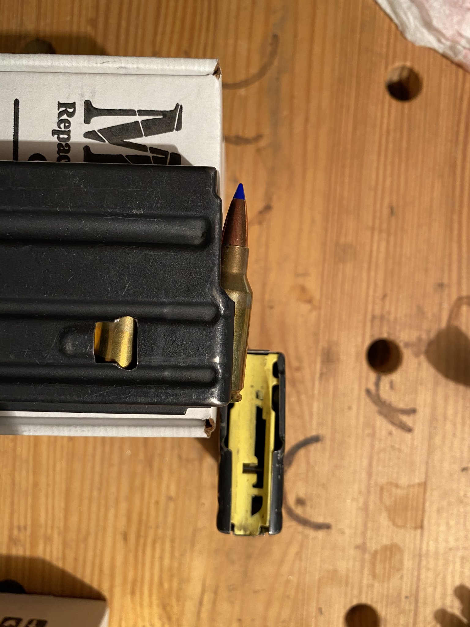

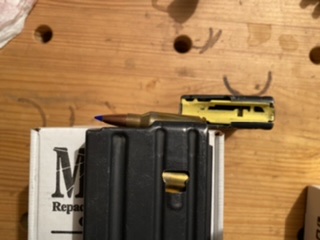

Here is one of the mags that came with the upper. If the work done to the follower was hand done then it was done quite well. Hopefully I will be able to get out in the next week or so to give it/them a try.
View attachment 7345242Here is one of the mags that came with the upper. If the work done to the follower was hand done then it was done quite well. Hopefully I will be able to get out in the next week or so to give it/them a try.

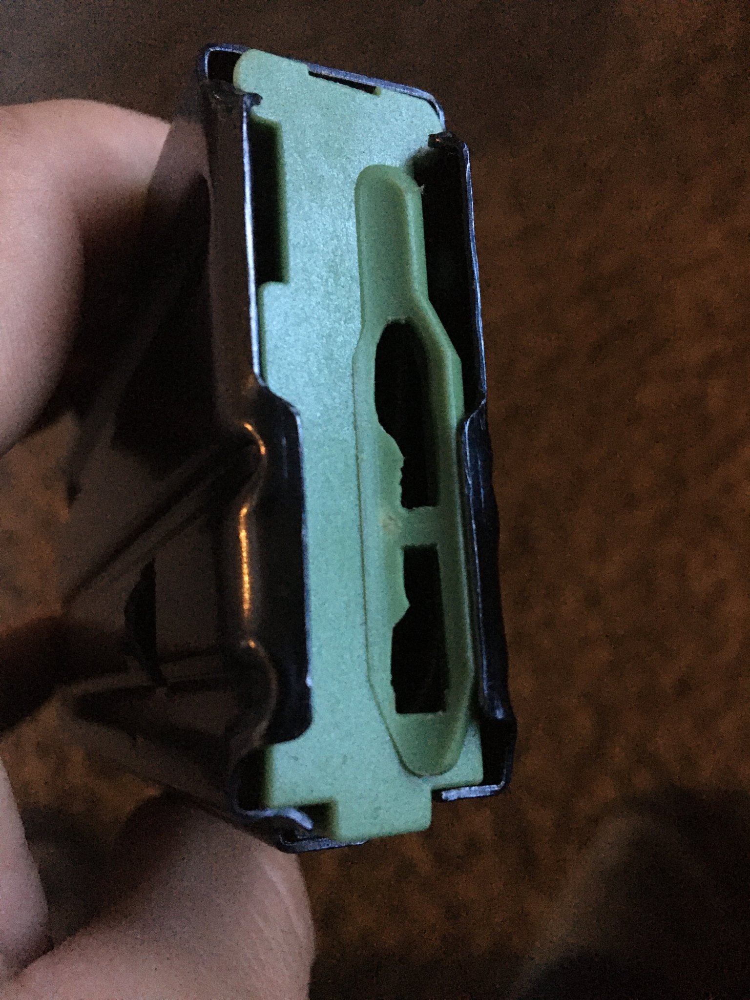

That should work. I take mine down a little farther, but I doubt it matters. Mine runs best with the feed lips bent to where the nose of the bullet is angled slightly upward. That could have something to do with the larger diameter bullet, though. A .25 may not need it, but it may. The whole magazine does sit lower than with a standard AR15 sized round.
