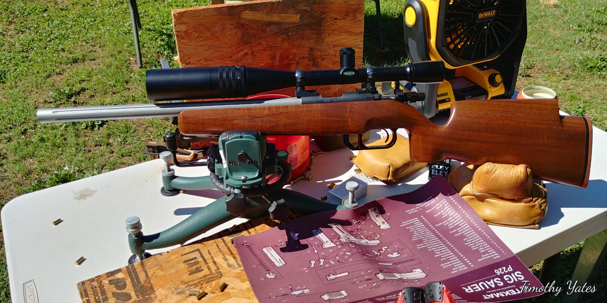

30mm tube for sure. As far as 25x or 32x goes, that would depend on the target size you are going to try and hit. For example, KYL targets would be easier to see with a 32x considering all else was equal.
But then again, I wouldn't feel handicapped with this Weaver T36 with a 1" tube.
