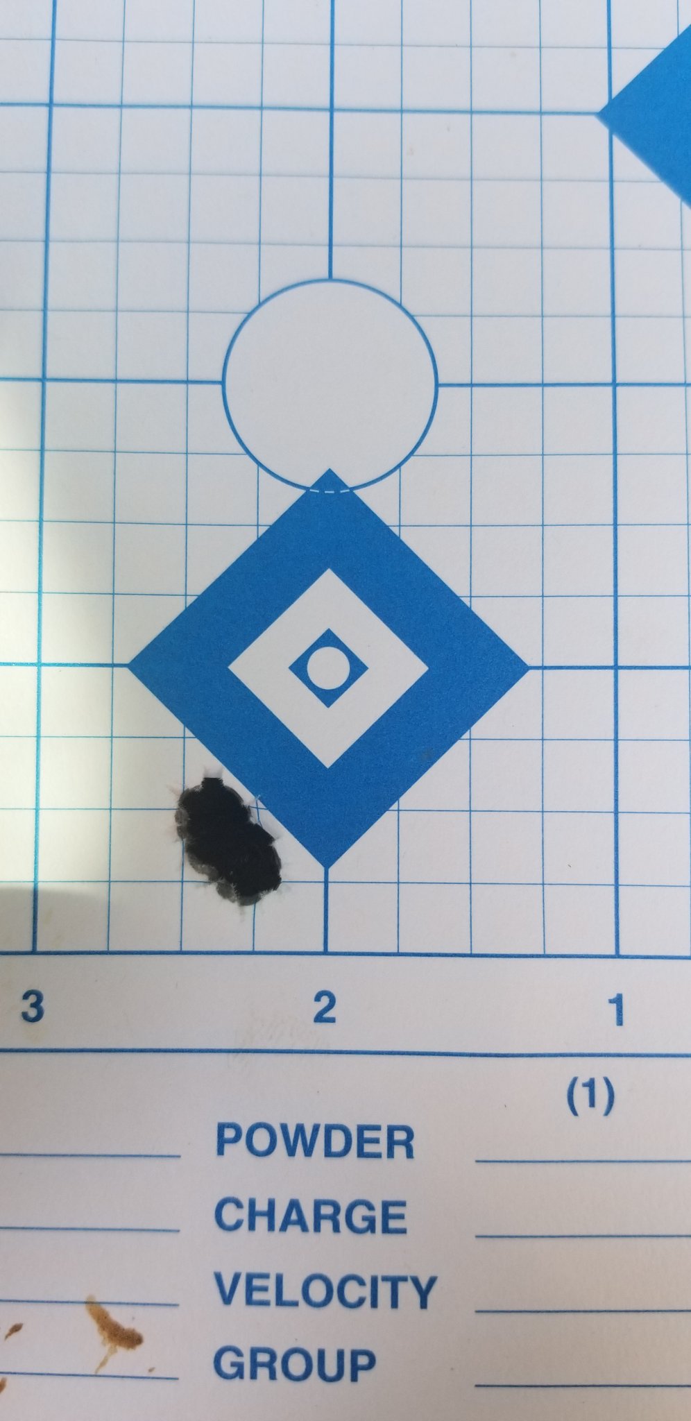

    Well this thing is a laser beam. 6.5x47 necked down with a 282 bushing. 40.5gr of H4350, bullet seated to 45 thou off lands. MV is 2860 out of a Hawk Hill M24 contoured bbl. Curtis Axiom action. Very pleased with the results, can't wait to take it beyond 740 yards

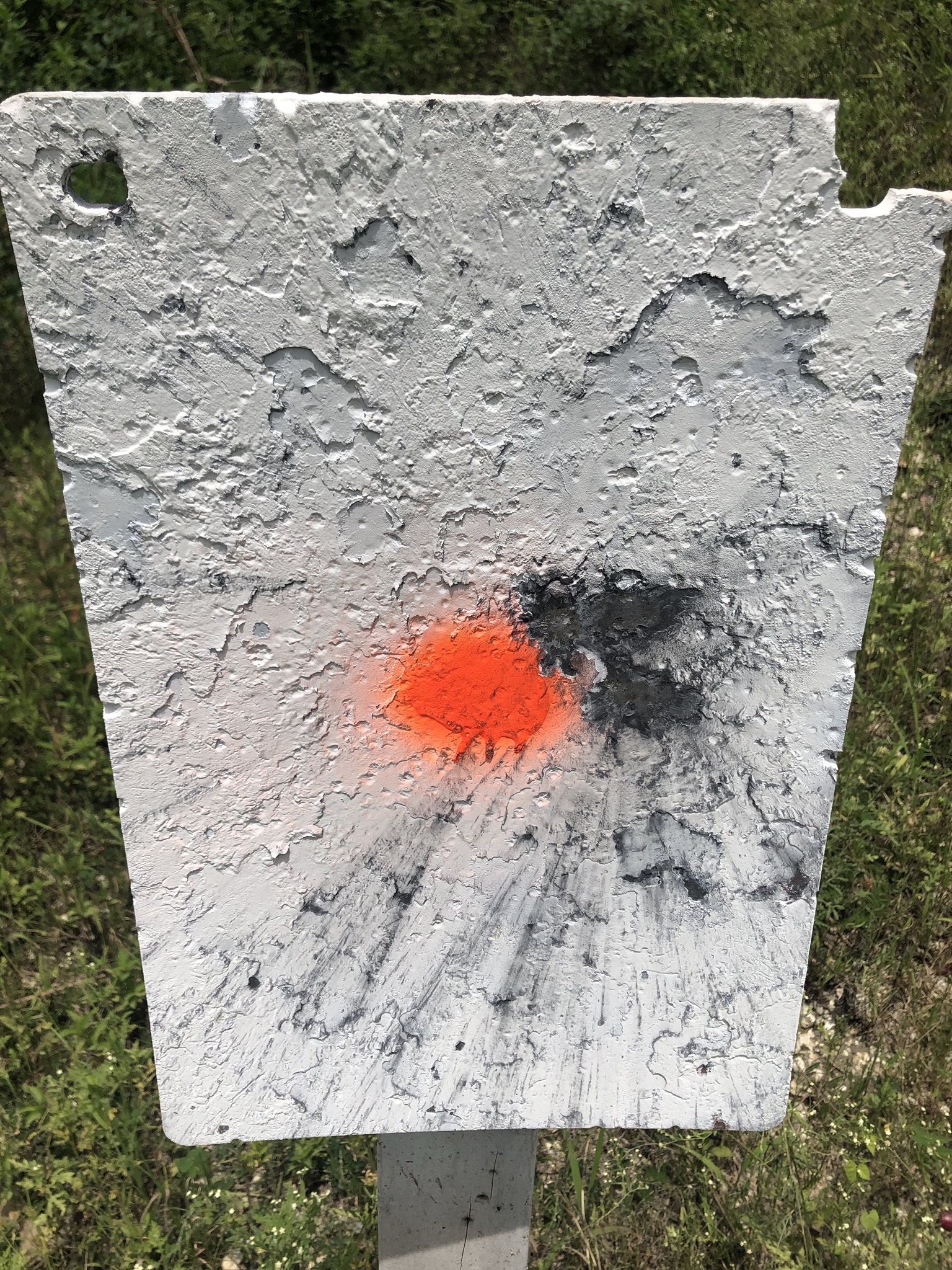

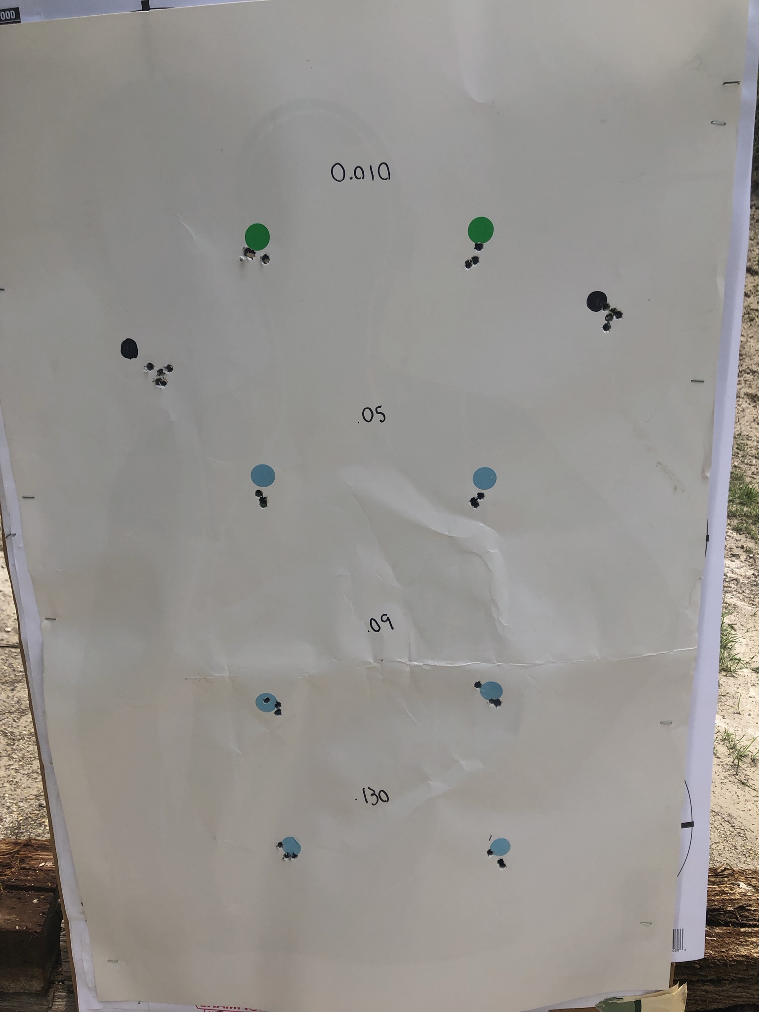

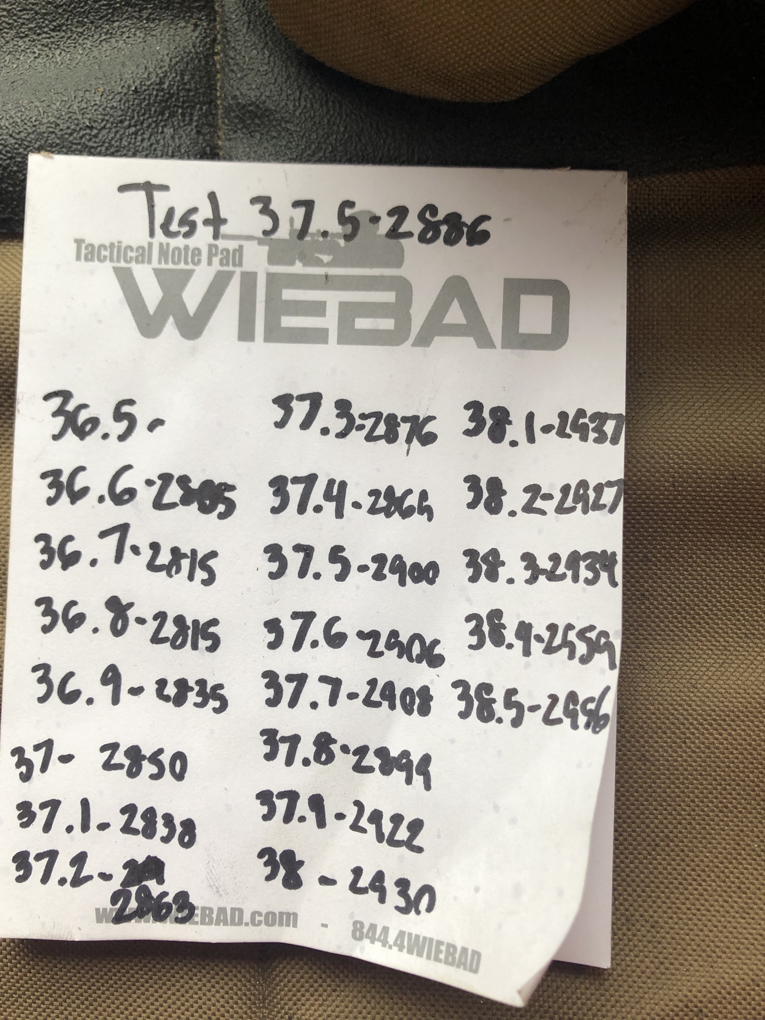

    Pretty much done with load development. Using Varget, my old 6.5x47 Lapua(who knows how many firings, all mixed) brass from my last barrel. Steel is at 500 and are the first three shots past 100 yards I took with the rifle. Pics are pretty self explanatory. .345 G7 is spot on at my limited range. Was starting to get cratering primers at ~38gr and the last two blew the primers.

    In that case, Varget will be an excellent choice for the x47. Guys are seeing nodes around 37gr

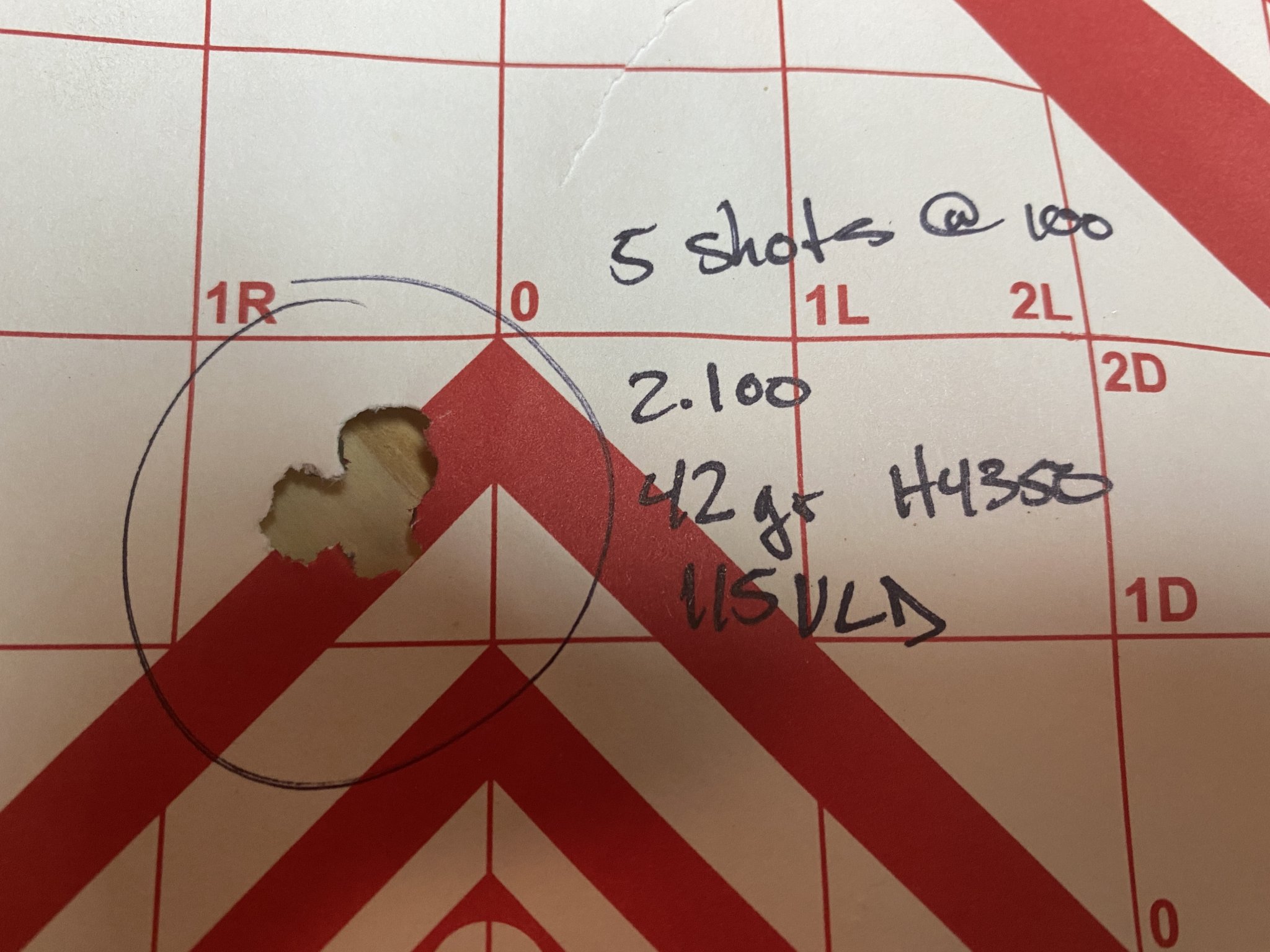

    I'm not sure why no one seems to want to go with a 25-06 improved for this bullet. I hit an accuracy node right around 3150 fps with a 115 grain berger, h4831sc powder, and I was still under max load in mine. I would love to shoot blackjack's 131s but unfortunately I only have a 9 twist barrel. I'm thinking about an 06 improved build around it.

    37gr is getting me 2850fps with a 24” tube. I’ve pushed past 38gr and got 3k fps but it was very hard on the brass and not as consistent as the slower node. I think H4350 would get me better speeds but my Varget load has an ES of 10-15 usually and I don’t shoot past 500 too often so I don’t care for hot rodding.
