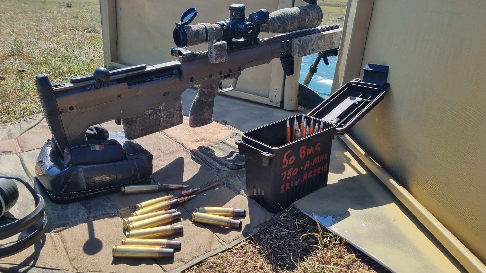

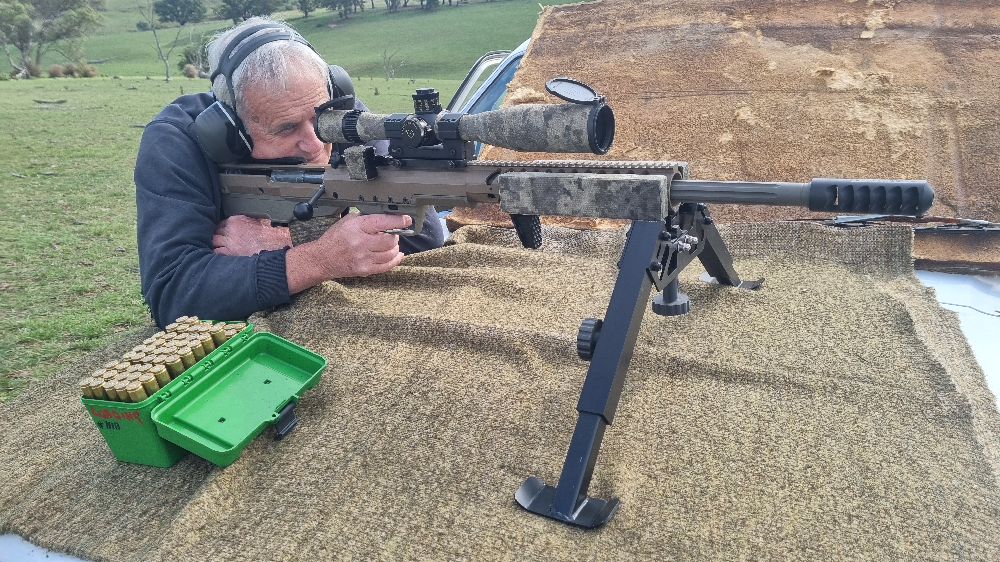

My DT HTI 375ct comes in at around 31lbs,s..... fitted with a Terminator T5, its a pussy cat to shoot..
Reactions: A5scott
